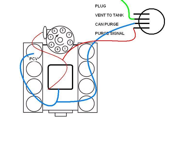

I'm running the coal can.
Still have not decided what I'll do about the fuel return line inlet on the tank.
Think I'm going to cap it. If I have any issues, I'll just run a vent.

The canister collects fumes from the gas tank and acts as the gas tank vent. It is a passive system in a way that doesn't affect performance. It also feeds a flow to the PCV system when you are at speed which balances it. The PCV system controls engine sludge and blowby. I suppose you could get a '60's PCV valve, but...
It also sends these gas fumes back to the engine to get reburned so it saves gas mileage also. Well, every little bit counts....
The old style cars used a vented gas cap so the gas tank wouldn't vaporlock when in use and could blow out fumes when sitting. Old cars always stunk like gas when you let them sit in the sun.
AMC used a modern sealed gas tank system. I know for sure when I plug up the $2.00 air filter on the bottom of my canister playing in the mud, a vacuum forms in my gas tank and the engine starves to the point of not running on the highway unless I crack open my gas cap.
I ran with just an open vent when my canister failed and we got bad raw gas fumes in our hair and clothes even.
AMC also got smart and used a return line off the top of the gas filter to blow vapor back to the tank when it gets shut down hot thus preventing vaporlock on a hot shutdown like a lot of old cars did.

Right now I wish I didn't have one on. I have lost about a gallon of fuel today through it. I parked it this morning after refueling and look down to see a huge puddle of gasoline on the floor. Now I need to do a search and find out why. I thought the vacuum lines were routed correctly.

If the canister filled up with fuel while refueling you likely have a problem with the liquid check valve or you have something routed wrong.

Not to hijack this thread but this is my 2nd fillup since the rebuild. It did not happen on the first fillup. This is the warmest day we had though I think. I am reasonably certain the stuff is routed correctly but maybe the lines got pinched or the valves stuck.
