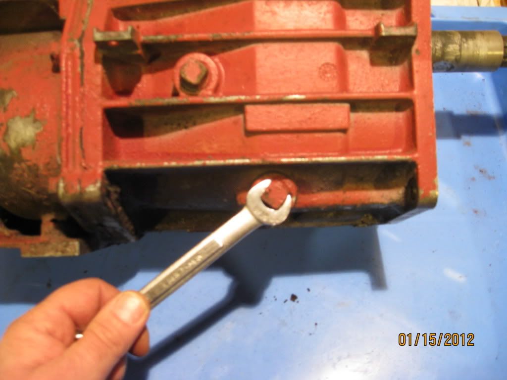

Be careful changing fluids in the T5 transmission, you don't want to remove the wrong plug and wind up losing reverse. Your 1985 version T5 should have the tamper-proof Torx bolt on the upper drivers side so don't attempt to remove it thinking it is the fill plug, it is not.
Both the drain and the fill plug are located on the passenger side of the T5 transmission.

Thanks everyone! Now I'm worried I'm going to grab the wrong bolt on my t5... Anyone have more photos of the drain and fill plug? (if there is a fill plug?)

All manual transmission have fill and drain plugs on them as far as I know.

Thanks for the detailed pics!
