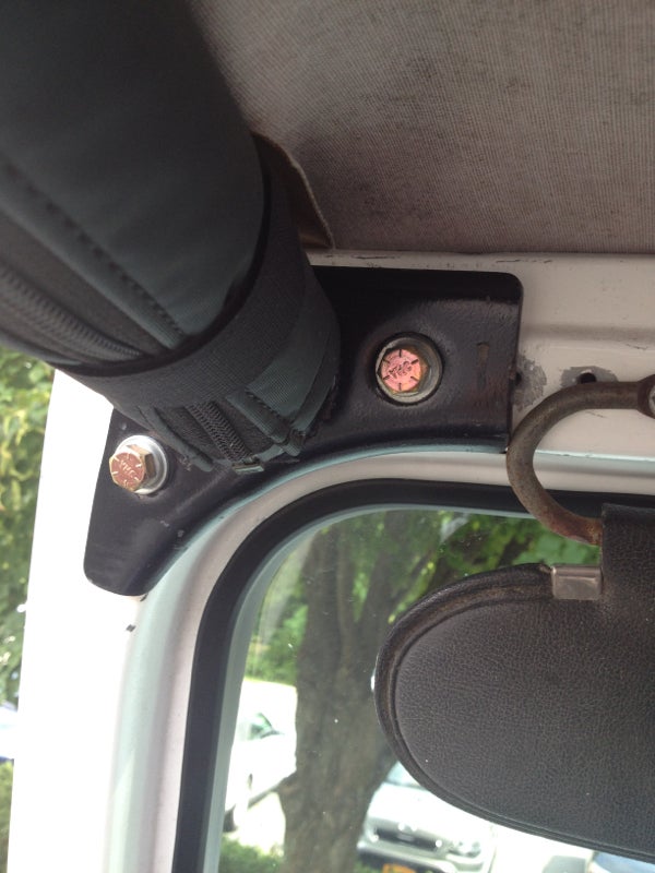

I have a 78 CJ7 and the PO mounted a YJ rollbar on it. He had the extension bars to attach it to the windshield frame but he never completed that. I want to finish it up, but I'm not sure how it attaches. Please consider the pictures here.
There's a mounting bracket on the windshield frame now for the soft top. How can I accommodate both this Rollbar and the soft top bracket? Is there a different kind of fixture in need? Regardless of the bracket, there doesn't appear to be ready holes in the windshield frame I should work with -- so is this an exercise where I drill into the frame?
I'm thinking there has to be something that I'm missing here. Thanks!

Great add. Thanks. Are the 'spreader bars' the extensions that come off the front of the primary roll bar and attach to the windshield? Can you give me a picture of the final solution?

Here's a quick shot of mine. Nutserts are awesome and easy. Works with my hard doors.

So TrebleHook's pictures show (I think) the soft top attaching to the rim across the top of the windshield frame. My BestTop soft top has a frame that runs over the door, that also attaches to the windshield frame. That's the bracket that is now on the windshield frame that i showed in my first pix. TrebleHook, you don't have that same frame on your soft top?

The YJ supertop is designed to have the bracket sandwiched between the spreader bar and the windshield frame.
http://www.bestop.com/installation_guides/51599.pdf
When I used the cj windshield frame the nutserts for the spreader bar didnt line up well. the nutsert thickness also made the bracket loose. I eventually swapped in a yj windsheld frame.
