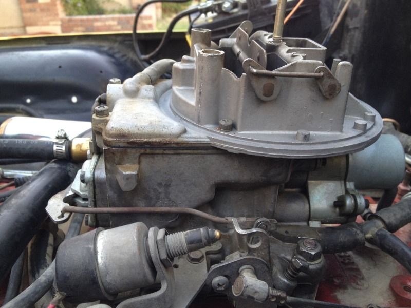

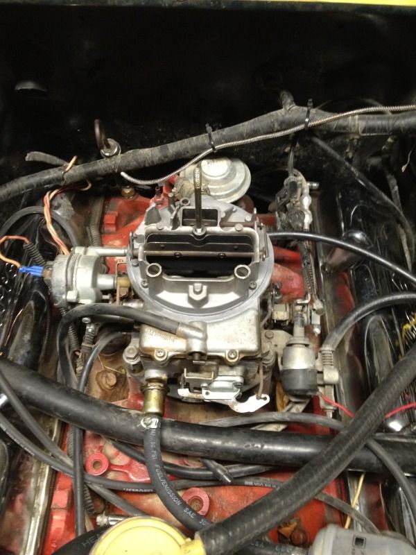

I just bought an 81' CJ7 with a 304 in it and never owned a vehicle that had a Carburetor before and I have a few questions about the Carb and wanted to see if anyone could help out.
I wanted to see if anyone knows what model # my carb is? It's a Motorcraft. It has two flappers on top, but I believe it's a 2 barrel because I only see two ports.
Also the Throttle positioner solenoid with dashpot has an electrical wire comining out of it and is not connecting to anything What would the reasoning for this? Thanks

BagusJeep
1981 CJ7
Location: Bali
Posts: 5,568
Doe it look like this Motorcraft 2100? Popular swap.

qvfd153
1981 CJ7
Location: Arizona
Posts: 41
I don't believe it's the 2100, or even the 2150 because mine has a 2nd small flapper on top and neither of those ones do.
81' CJ7 304 V8 4'lift 33" BFG AT
qvfd153 is offline
post #4 of 18 Old 05-28-2012, 11:58 PM
titomars
1981 CJ7
Location: Santa Rosa
Posts: 1,808
What you have is what was called a variable venturi Carburetor. They are not exactly what you would call a decent carb. they were troublesome even when they were new. If it were my Jeep i would get that thing off there ASAP.

qvfd153
1981 CJ7
Location: Arizona
Posts: 41
Thanks, I just discovered it is the 2150.

jeepdaddy2000
jeepdaddy2000's Avatar
1971 CJ5
Join Date: Jan 2002
Location: Eagle Point
Posts: 7,239
The third flap is part of the high altitude "kit". The 7700vv variable venturi looks like this:
http://www.grandmarq.net/vb/showthre...uretor-Rebuild
jeepdaddy2000 is offline
post #7 of 18 Old 05-29-2012, 09:01 AM
titomars
1981 CJ7
Posts: 1,808
Thanks I stand corrected. It's been many years since i have seen either. My memory is not what it used to be I guess.
