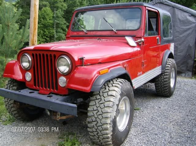

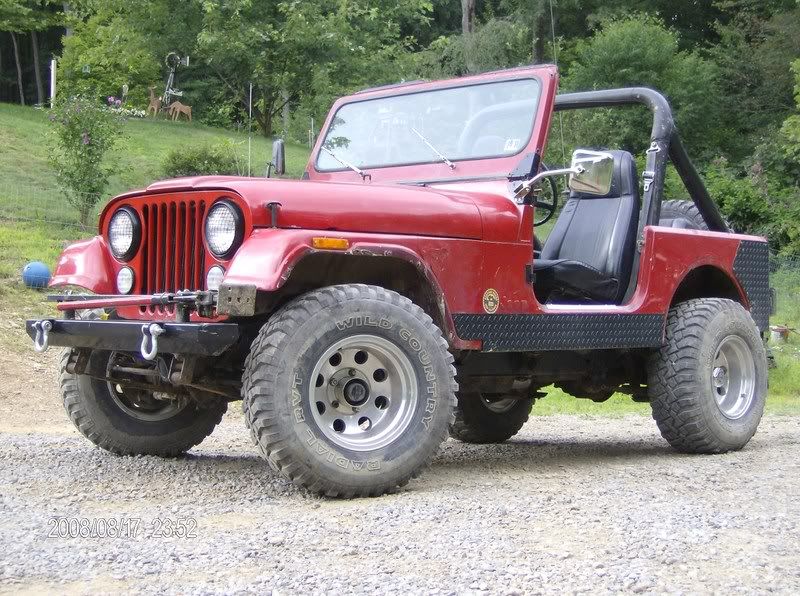

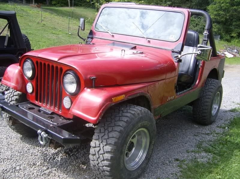

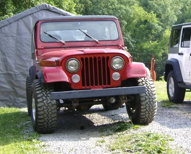

i had 32's on my 86 stock suspension with no rubbing. i threw some 33's on there for fun and had very minor rubbing. with the TJ flares i have now, i would have had no issues.
as far as the shackles, i say avoid anything over 1.5" lift shackles(give 3/4" of lift.) i have 1.5's on my 86 with a 4" suspension lift and it handles just fine on and off the road, even with 33" TSL's. i also know guys who have the monstrous 3" or larger shackles and have no problems. i think results vary from each individual jeep.
here are a few pics from '07 with 33's and stock suspension. now obviously your flex would be hindered, but with some TJ flares to open the wheel wells a little, you may not rub much at all, depending on the condition of your suspension.
with 32's and no lift

wow - thanks junkur! that's just what I was looking for. The pics are encouraging.
