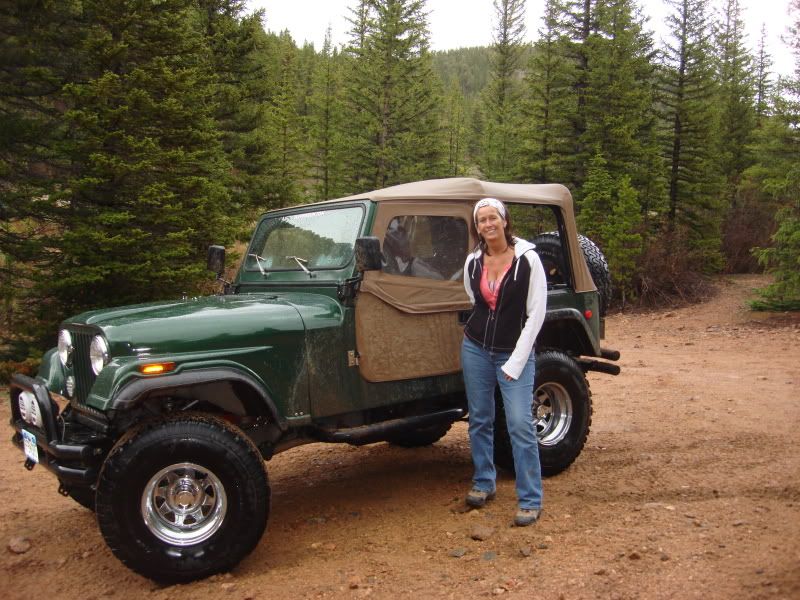

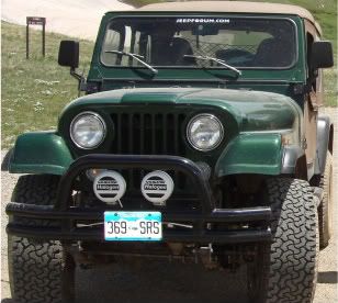

Here are a couple of pics. Tough Country springs.
Everything clears with the additional clearance that TJ flares allow, they do however rub inside of the rear wheel well when flexed, I am installing 1.25 wheel spacers to the rear to eliminate that issue.
Wheels are 10 inch with 4 inch backspacing.

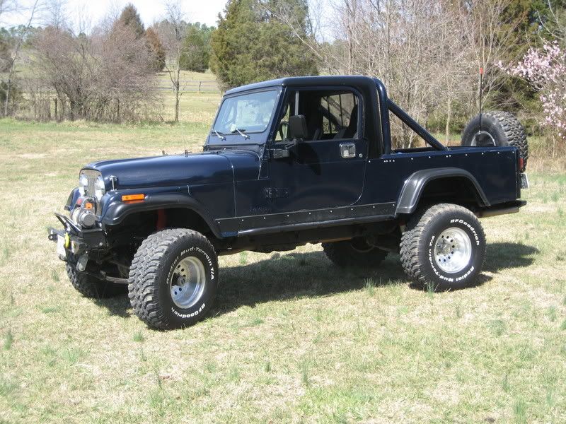

Scrambler...but you'll get the idea...
This is a RE 4.5" lift and a 1" body lift with 33's.....
Flexed.........
Static.....
