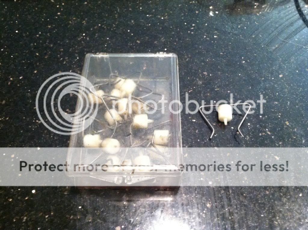

After the cam has been run in for at least a half-hour at 2,000+ rpm, you can do a final adjustment of the rockers. You can remove one valve cover at a time and throw some oil stoppers on the rocker arms. They won't block the oil completely but they'll help keep the smoke down.
