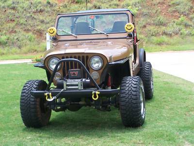

P.S. She just ordered these front fenders - http://www.ccfabs.com/store/#!/~/pro...=0&id=24092357 Free Shipping. Same ones we installed on Jr's '74.
Not her Jeep, just a pic off the mfg web site.
