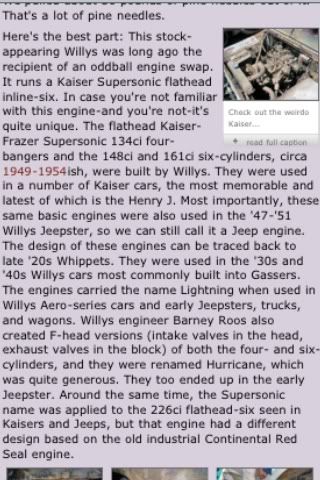

I found Peterson's 4wd mag did a write up on this same set up, cool little history lesson.
