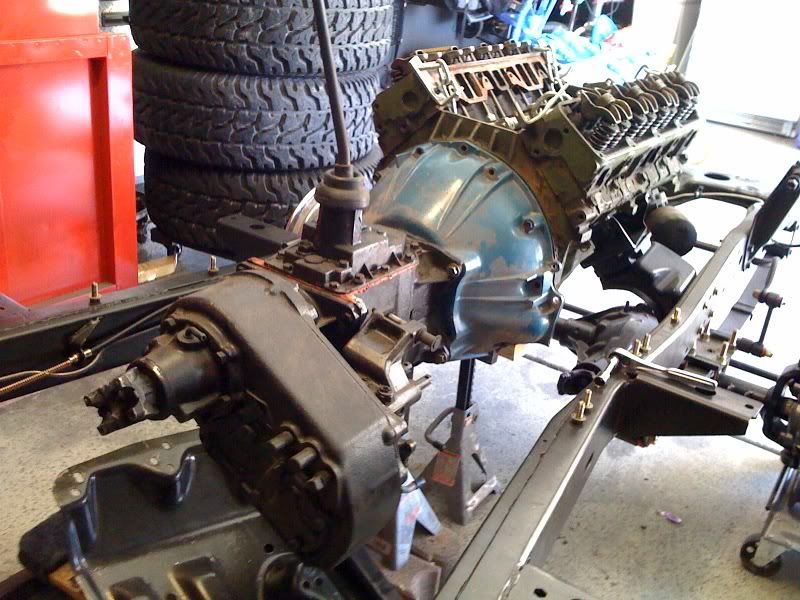

The T176/Dana 300 is in and....THE SKID PLATE DOES NOT LINE UP!!!!!!!!WTF!!!!!! I am quickly losing my mind with this build. If anyone following has an 83 CJ7 with an AMC V8/T176/Dana300 please post a picture of the skidplate bolt locations so I can see what set of holes are supposed to be used. Can it be that I have the wrong skidplate? Are there different ones, all three CJ7's (79', 79', 83') that I've owned had this same skidplate. Can it be that the V8 is causing the drivetrain to sit in a different location? IDK...On the bright side, I'm getting my workouts in by lifting and bolting up all these transmission/transfer case combos repeatedly.
The dana 300 hangs lower than the dana 20 did.

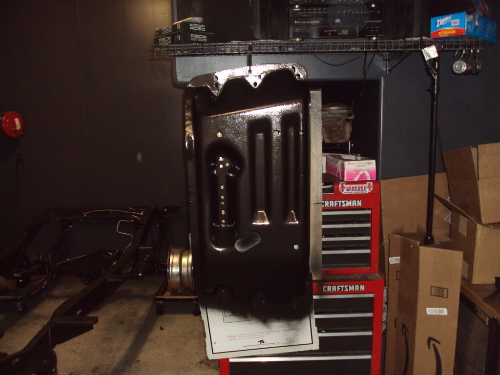

The skid plates from 76-79' are different from the 80-86' skid plates. This was due to the use of the D20 used up to 79' and the D300 used afterwards. Is the skid plate you're using look primarily flat across the bottom or does it have a section on the right rear side which hangs down lower to allow clearance for the 300?
It's flat across the bottom no "shovel" as guys refer to it, here's a picture of it. I noticed while searching the forum that there were different ones out there and figured this was the problem, thanks for the heads up:

I would say that you need a 1980-1986 skid plat instead of the older one you got there then.
