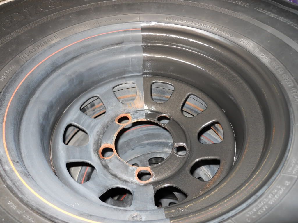

I'll paint the rims to match the frame with the Black Hammered Paint. I tested it on one of the old rims and it looked good.

Nice choice on the wheel paint, I like Rustoleum Hammered Metal paint.

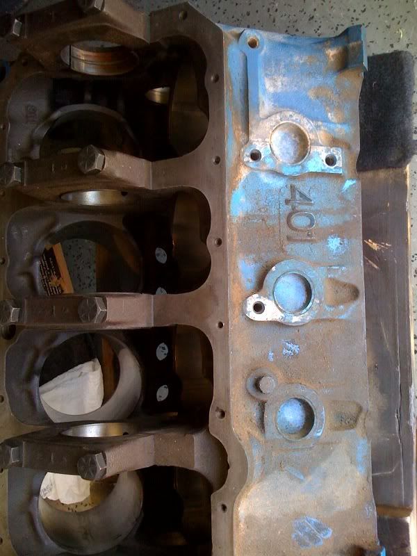

The project took another turn today. The engine choice grew by a few cubic inches. I found a (.030) AMC 401 with forged pistons today on CL and picked it up for $250. One cylinder has a scratch (which probably could be honed) however I'm going to bore it out to .040 and start fresh. I'll build it identical to the (.040) AMC 401 I built and put in my 79 CJ7. I have an entire TBI setup off of a Chevy 454 sitting on my shelf that I will put on it instead of a carb. Even though I had the 304 already I couldn't pass up a 401 for this project.

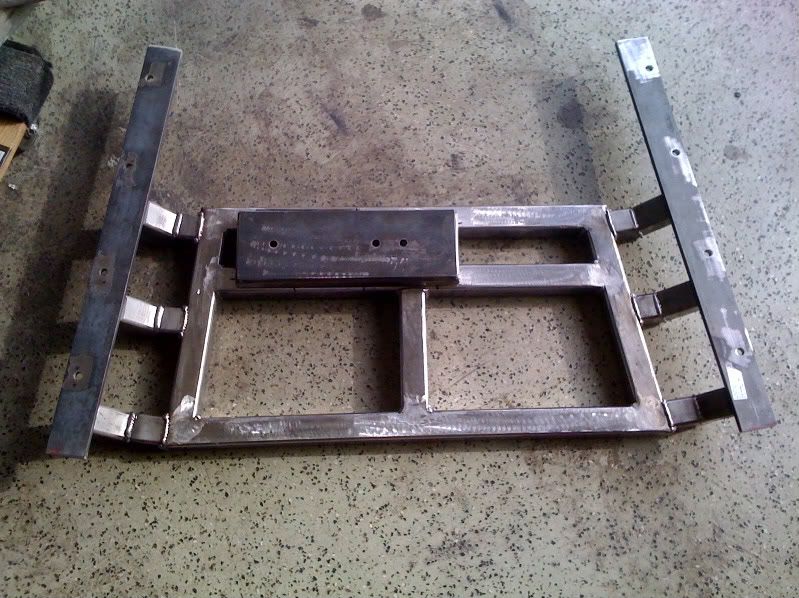

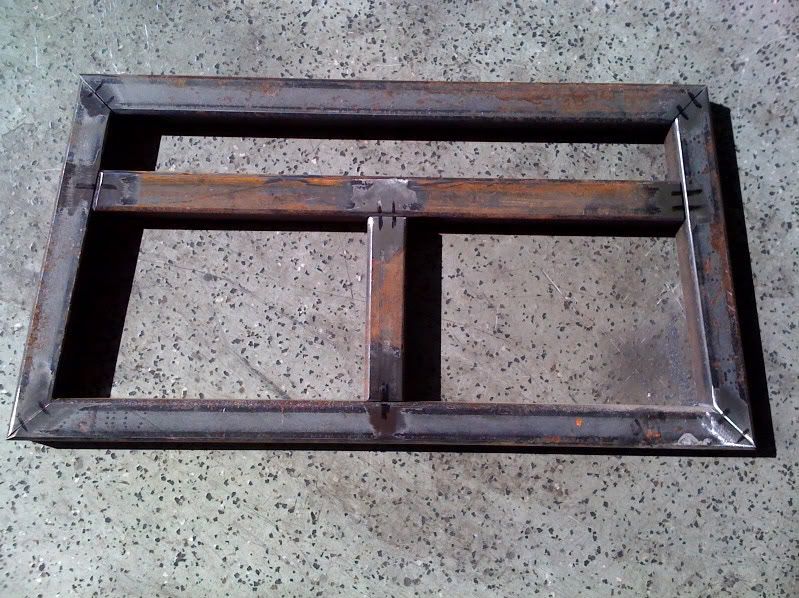

I stripped down, sand blasted and painted my Hurst trans shifter parts so they're ready to be reassembled. My buddy welded the stick back up nice and clean. I'll work on the shifter while he is welding up my 2nd attempt at a crossmember. This time I used 1 1/2 square .188 wall tubing. Here's a pic:
He's got a 220v Miller he welds nicely so I'll let him go to town on it. My mounting plate will be welded to the upper left hand corner and there will be three down tubes(angled) on each side from the 3/8's bar mounting flanges I have bolted to the frame rails . Then we'll add a few gussets for strength.

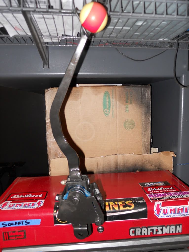

I failed to take pictures of the Hurst Shifter during the tear down and paid for it. Hurst does not provide any information on the rebuild of their Hurst Competition Plus Shifters but you can send them back to Hurst for a full rebuild = $$$$$$$$. Luckily I found this on Youtube....I don't know who the guy is but he saved my *** by making these two videos. Here's the two video links for the rebuild of Hurst Competition Plus 4 speed Shifters. I need to replace a broken pin and I'll be done with it. Just FYI if you're doing the same thing, the tension pins are 5/32'nds x 1 1/4 inch. Found them at Lowe's. Total cost of my shifter rebuild .88 cents...
Part 1:
YouTube - Hurst Competition Plus 4 speed shifter Rebuild Part 1
Part 2:
YouTube - Hurst Competition Plus 4 speed shifter Rebuild part 2a
Finished Shifter:

I got the frame and mounting plate of my crossmember built, now I have to make the down tubes to tie it all together with the mounting flanges. I need to find someone locally with a bandsaw to make some cuts on them. Then it's off to finish all the welds of the stuff that's tacked in right now. I'm making progress...twenty minutes at a time.

Had some time yesterday to cut the down tubes for my crossmember and tack them in. Once my friend welds them up with his 220v welder I'll set it back in place and tack the mounting flanges on so he can finish it up. I'll also need to add in some angles to strengthen it. I couldn't find anyone with a bandsaw so I used my "sloppy" chop saw to cut the angles in the tubes, it went surprisingly well and I still have about 6 feet of tube left over. Here it is so far...Can't wait to get past this point, feels like I've been stuck here forever....

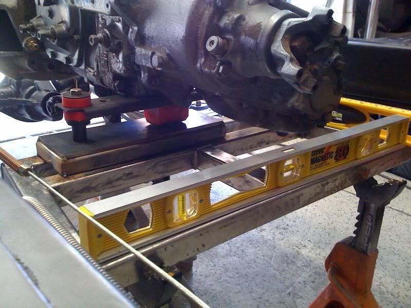

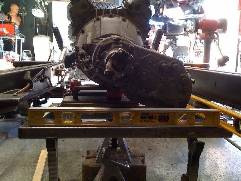

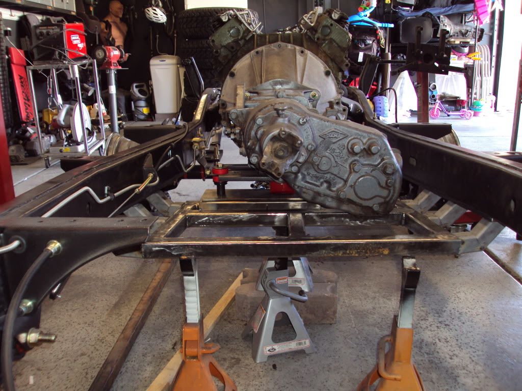

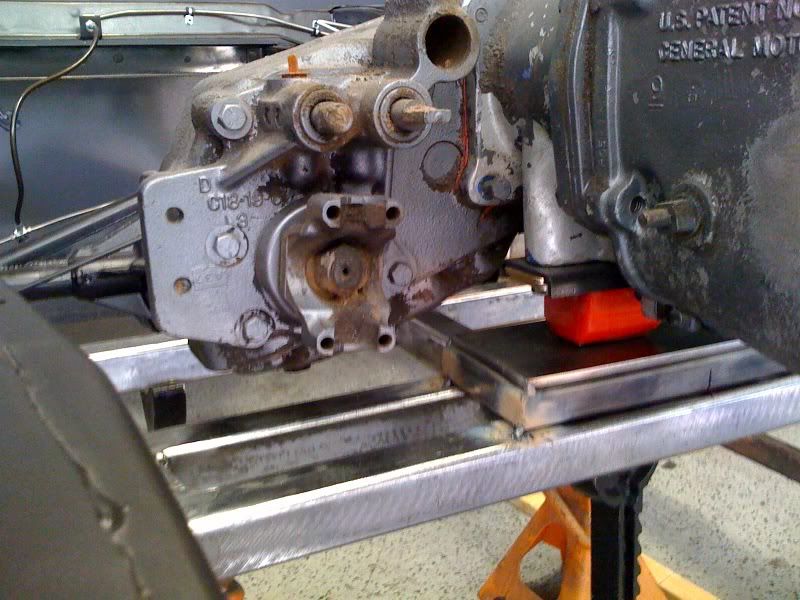

Well much like I said yesterday... today brought frustration, I ran into clearance problems with the SM420 retainer on the Muncie M20 so I got fed up and pulled it out and dropped the T150 in. Kinda sucks to put all that time (and $$$) into making the crossmember and rebuilding the shifter only to scrap that whole idea, but better I find out it won't work now than when trying to take it for it's first ride. I would like to stick with a manual but prefer a four speed over the three speed. I found a T176/Dana300 and an NP435 locally and may look into them. I figure if I stick with original Jeep parts I should have "minimal" problems. Atleast I'll make some money off the Muncie trans, Novak retainer and Hurst shifter (hopefully). Here's how my custom crossmember turned out:
It'll make the top of the scrap metal pile look nice!
It must be me, but I still can't get the stock crossmember to line up even with the T150 in place. Anyone out there have an AMC V8/T150 in a 80's CJ7 frame that can post a pic of their crossmember bolted up so I can see what set of frame holes you used?
