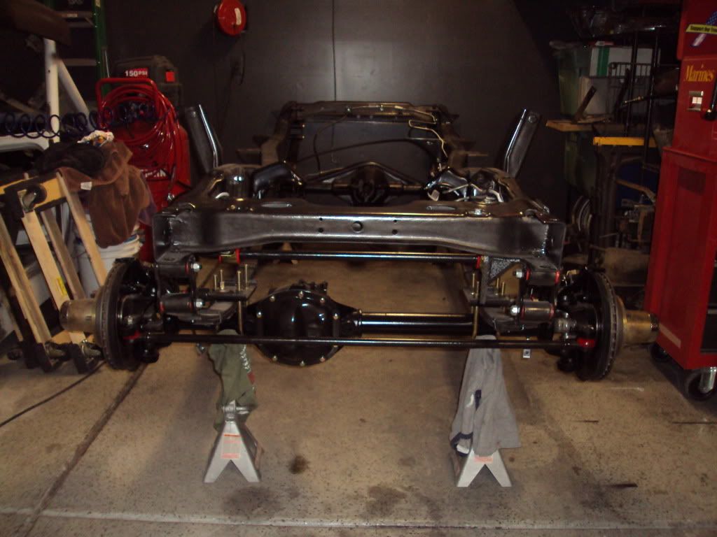

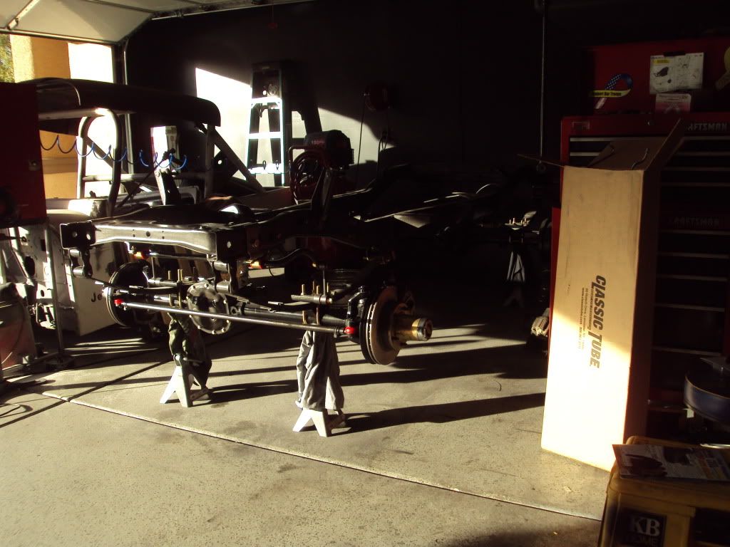

Rear axle is in but not without some minor issues...
1. I installed new e brake cables but due to the SOA the left side cable is too short so I need to use a right side e brake cable in it's place.
2. Something is up with the brakes. I had a hard time getting the drums on even with them adjusted all the way in. Gotta take another look at it.
3. The brake equalizer bars that I pulled out were stamped "Bendix 49004" and they have a bend in the middle, the ones I put back in (from a parts AMC20) are stamped with the same part number but are perfectly straight. Not sure what's up with that. See here:
Here's how it sits right now:
I started tearing into the front axle and found that it is an open carrier not a Lincoln Locker as stated when I bought it. Guess I should've popped the cover and checked at the time. The diff cover has a crack (I have a used replacement), The rotors need to be replaced (I have another set I can get turned) everything else looks good so strip, paint everything and repack the bearings is the plan.

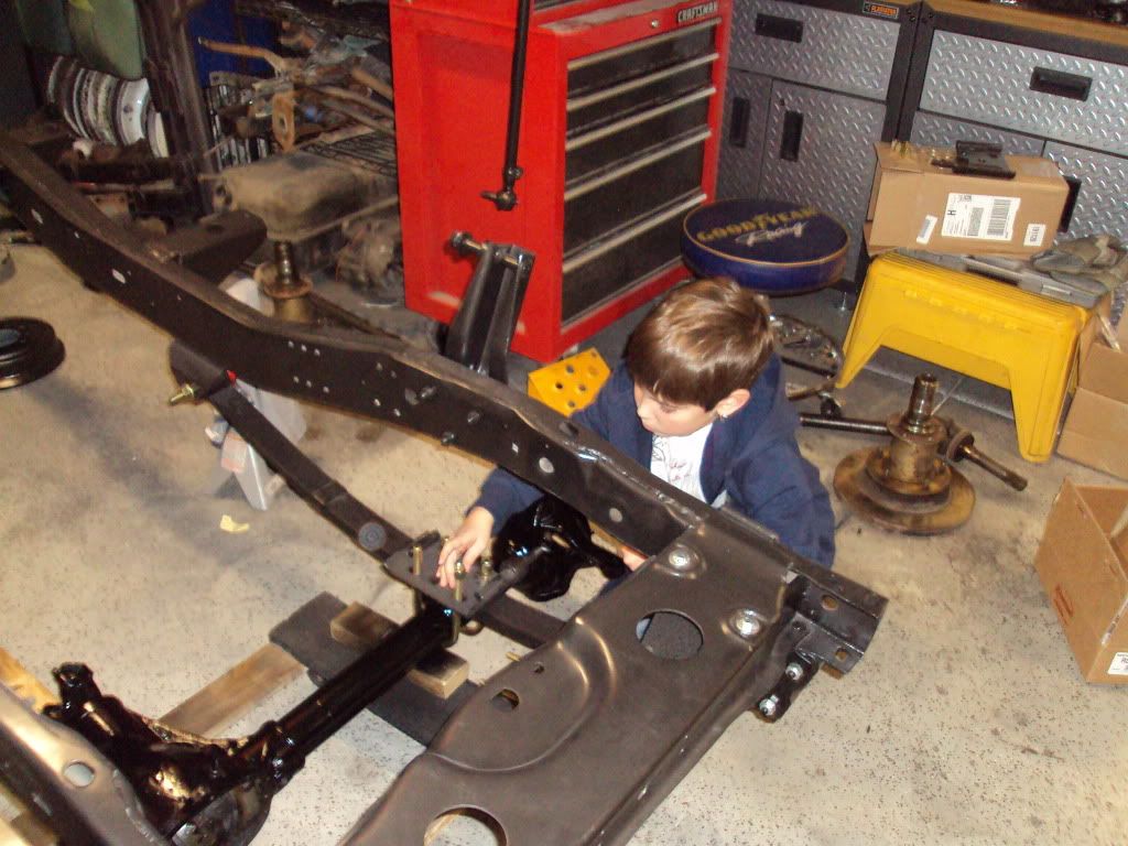

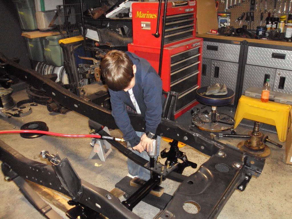

I got the front axle stripped, painted and bolted up today with a little help from my nephew. I let him dig in and get his hands dirty as he worked on a Jeep for the first time. The kid loves power tools!!!!
Little man working:

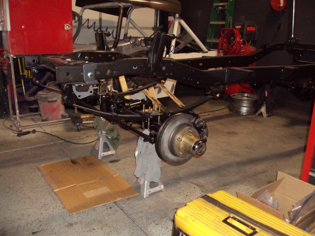

The front axle is done and I got some new parts on order, UPS and Fedex are regulars at my house. Here's what's coming next week:
Urethane bushings for the swaybar, end links, tie rod boots, torque arm bushings and a urethane trans mount.
V8 Motor mount and bracket kit
Stainless brake line kit
Extended brake line kit for front and rear.
I need to locate either an sr4, t4 or t5 bellhousing that I can use to mate the Muncie 4 speed to the AMC V8. Here's how it looks now.

A little more progress...I got the new motor mounts and the new urethane bushings installed. I blasted, painted and installed the swaybar and end links. All the grade 8 hardware is starting to add up. I received my new stainless steel and extended brake lines this week so they'll be next to get installed.

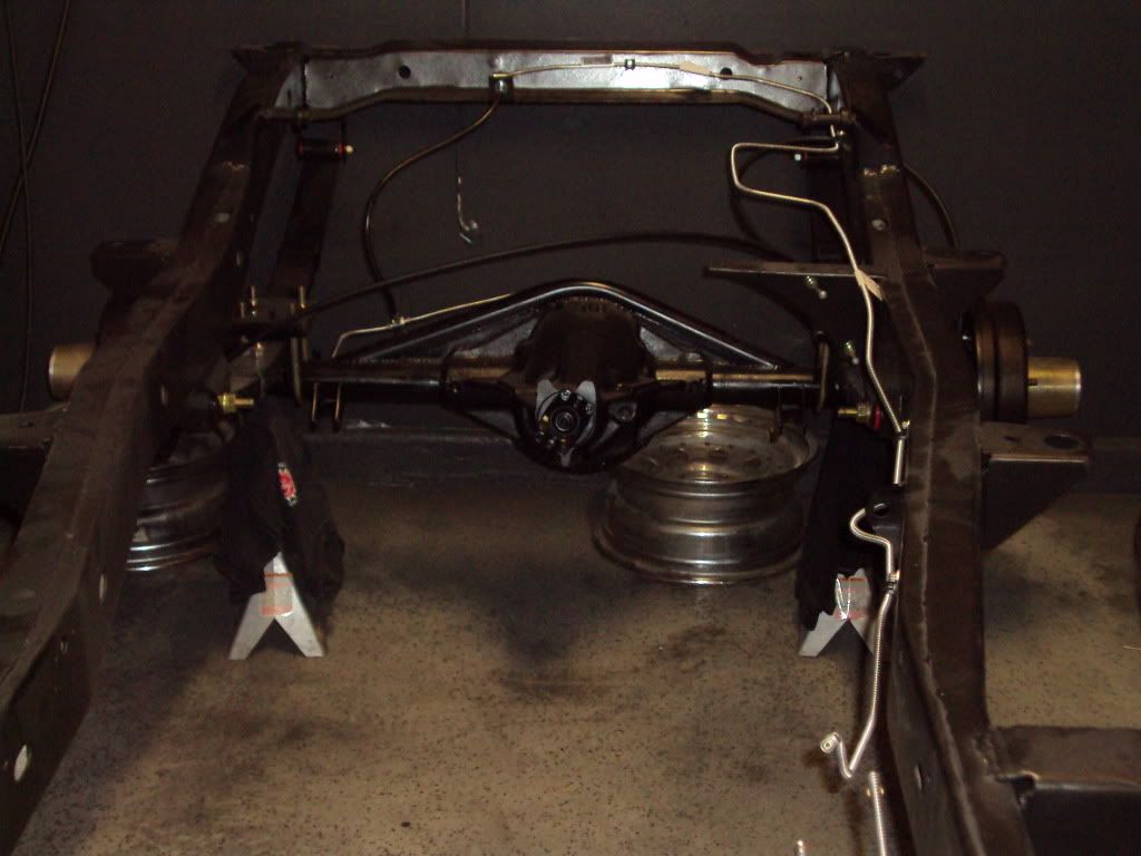

I got all of the brake lines installed today, now I just need to clean up/hookup my proportion valve and find some new banjo bolts for the front calipers.
I did have one question though if anyone can help out... Take a look at the line that goes from the proportion valve to the rear cross member, is it supposed to stick out towards the center of the frame by the left rear shock tower or is it supposed to go over the top of it? Looks weird to me. My other Cj7 is a 79 so it has the extra crossmember and isn't a good reference.

it looks correct to me, but it would work either way i guess.

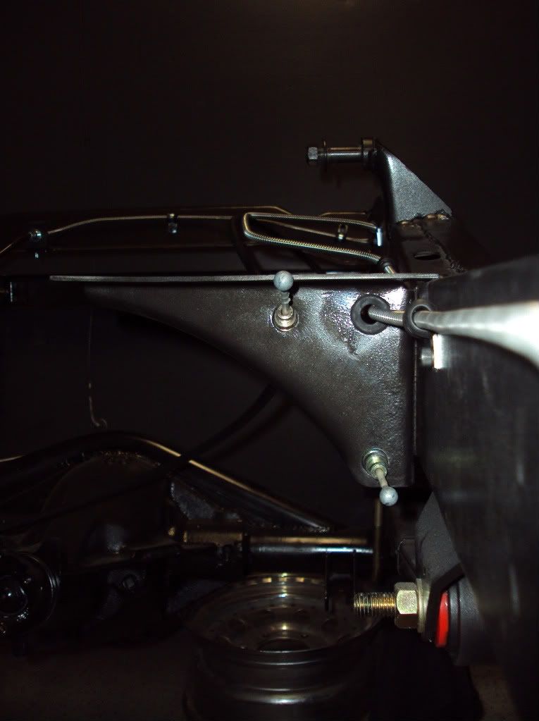

I didn't like the way the rear brake line ran along the frame so I got some more line clips and a grommet. I drilled a 3/4 inch hole in the e-brake bracket, installed the grommet and ran the line through it. Looks better now, more secure.
