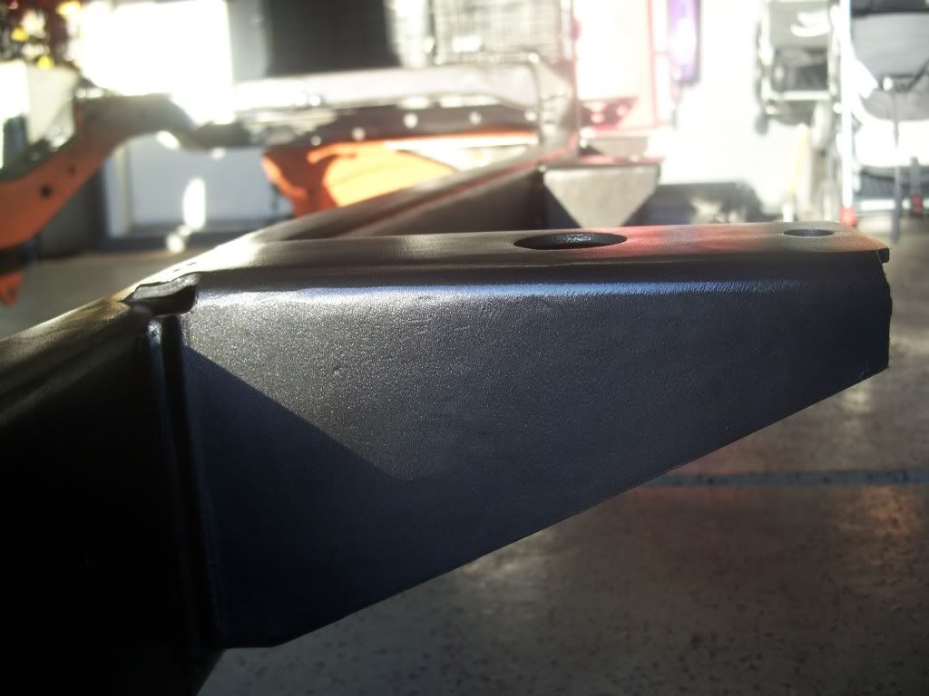

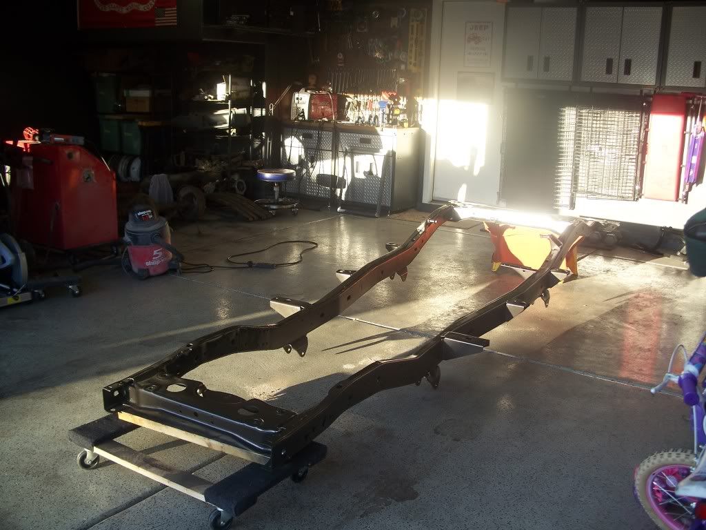

Sorry for the lack of updates, Just finished painting the frame yesterday, it didn't come out as "hammered" as I thought it would. This is two coats of the Rustoleum "Hammered" black. I used Rustoleum because I couldn't find the Hammerite brand locally and I'm not too worried about rust in the desert like I was when I was in NY. Not sure how I feel about it yet...

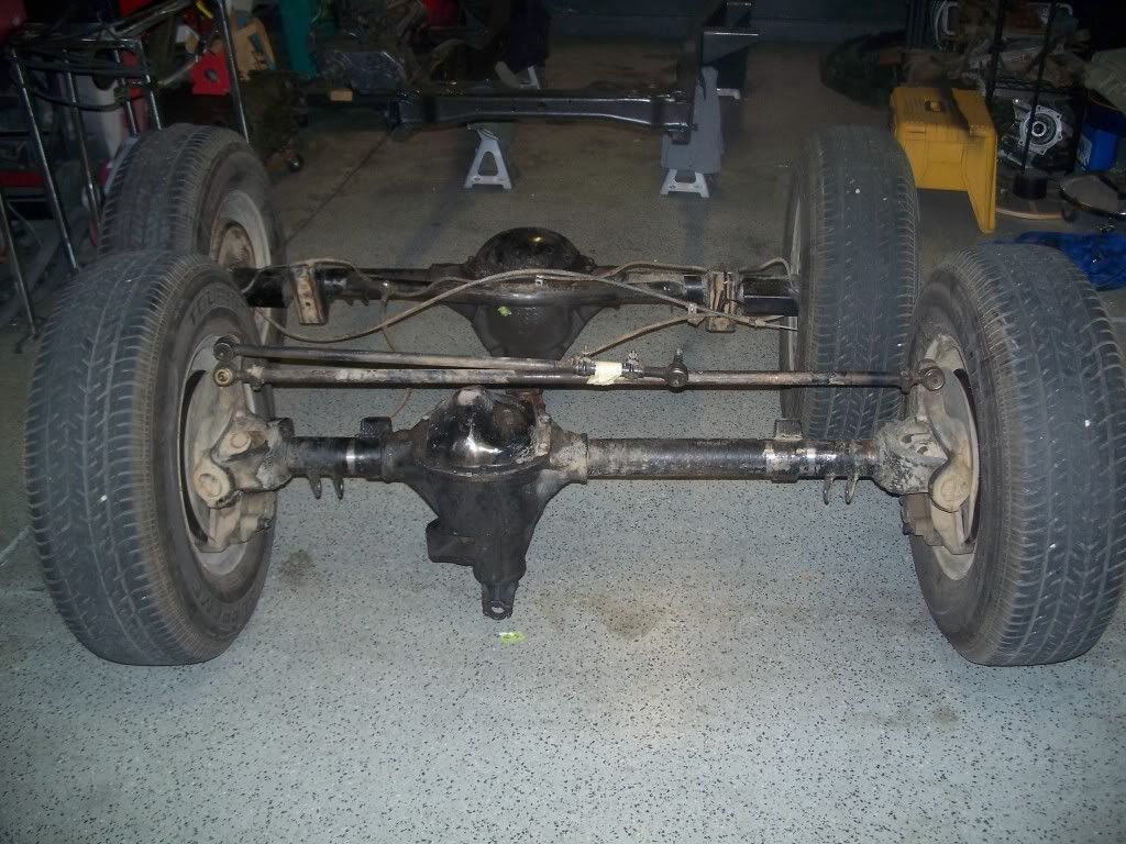

Huge CL find this week, I picked up a new(uninstalled) 4 inch lift kit complete with urethane bushings, new shackles and a transfercase drop kit along with a set of widetrack's. The widetracks have a lincoln locker up front with disc brakes and warn locking hubs and the rear is a fully welded/trussed AMC 20 with and ARB airlocker and a Warn Full Floater kit installed. The axles are already setup for SOA so I'm gonna use my stock CJ springs with them and save the 4 inch kit for my 79CJ (rear springs are sagging). Big thanks to a fellow Forum member who sold me the parts. If anyone needs some narrow tracks let me know I have two sets I need gone....if they don't sell I'm gonna strip off the useable brake parts etc....and scrap the housings.
I sold the Muncie trans and scrapped the idea of a chevy drivetrain, I will be putting the AMC 304 that I aready have in this build so I'll be looking for a 4 or 5 speed manual Jeep trans. Anyone looking for the adapter for a Muncie to a dana20 let me know I'll be selling that too. The axles came with a set of brand new tires that I'm gonna throw on my cherokee because my pirelli's are worn out.
Here's some pics:
Springs
Rear Axle with full floater
Front axle

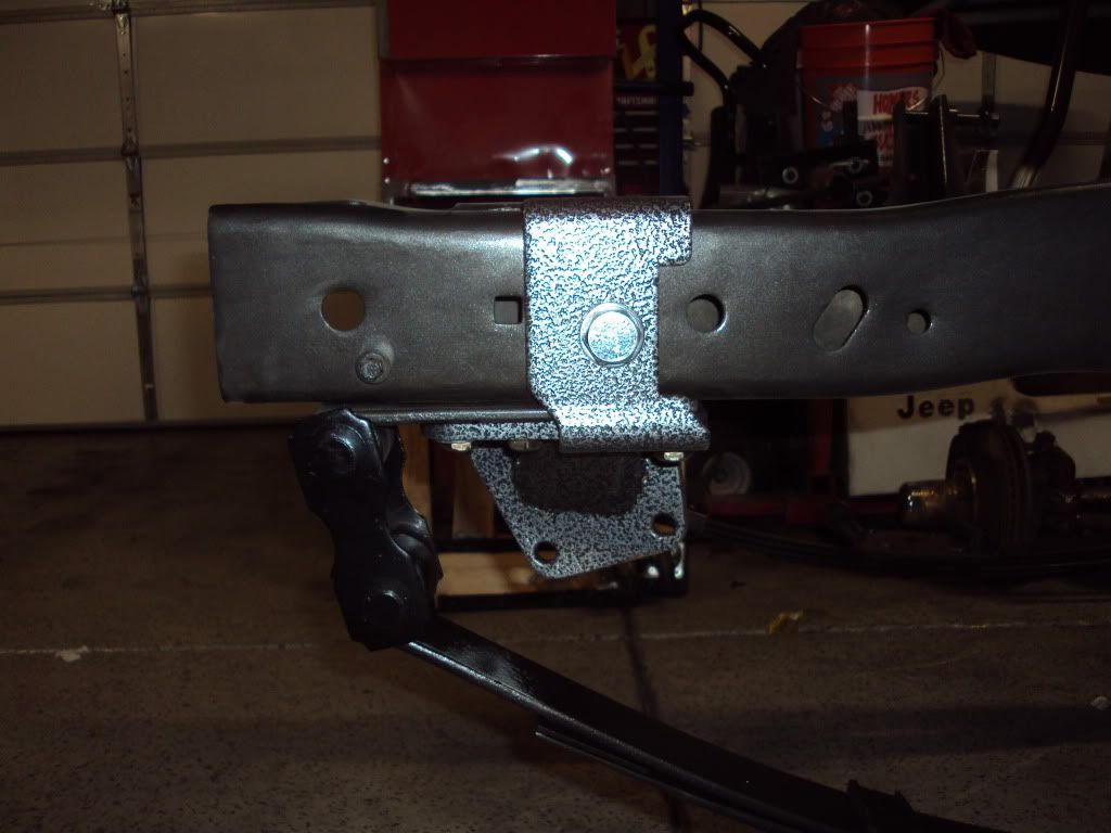

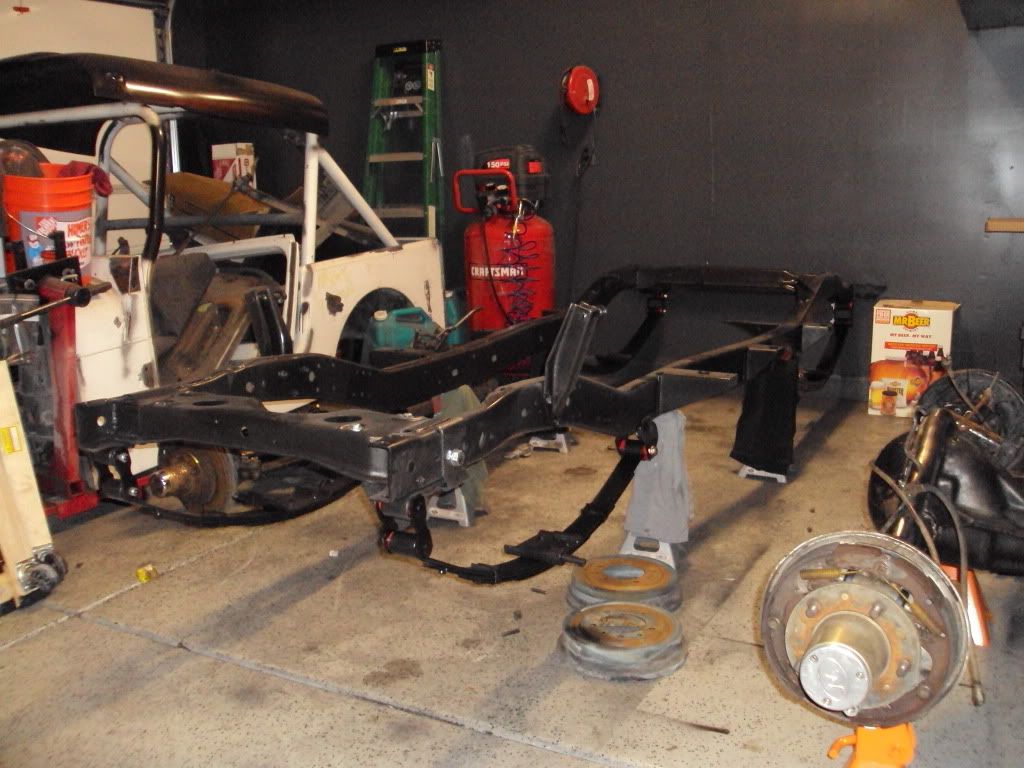

Just got rid of the Chevy 307 today, damn I tried selling that thing on CL for $200, $100, $50 and finally wound up donating it to a local highschool autoshop who is working on a early 70's Chevy project. Damn, people avoided that motor like it was the plague....
I've been making small progress on the CJ7 and began bolting some stuff back onto the frame so I can hang my springs. I used a grinder and flap disc to clean one of the spring packs prior to reassembly and painting (HUGE DUSTY MESS IN THE GARAGE) so I got some Klean Strip Prep and Etch solution and the rest of the leaf spring packs are currently taking a bath.
I got new teflon spring pads from Alcan Spring ($.65 Each as opposed to $4.99 each for skyjackers) and reassembled/painted one spring pack. It came out great so I installed new urethane bushings and hung it on the frame. 1 down 3 to go.
I redrilled the stock spring plates and cut off the shock mount bolts so I can flip them and reuse them for the SOA. My axles have shock mount tabs on them for the SOA.
I bought and installed a Rugged Ridge HD Power Steering Bracket Kit..very impressive piece with a great powdercoat finish and even better price $65. It's alot beefier than the HD Bracket Kit I have on my 79 CJ7. I like the finish so much that I wish I would have waited to do the frame and powedercoated it the same as the bracket.

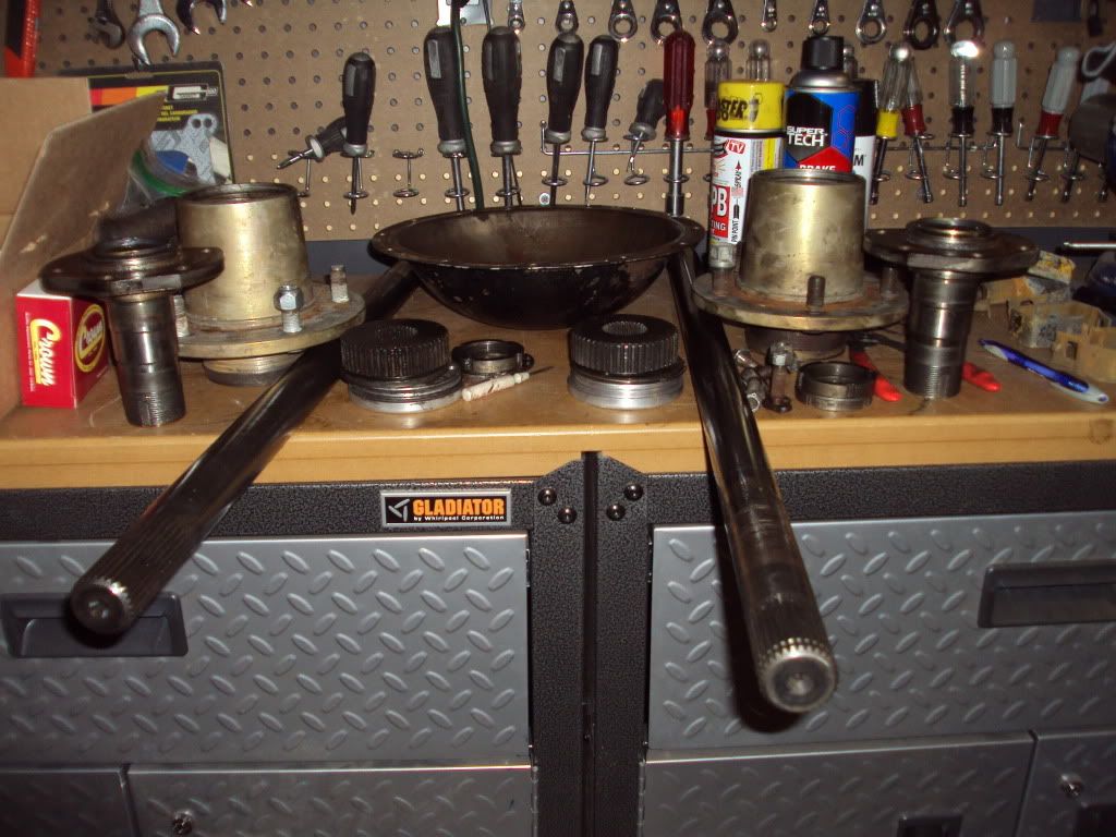

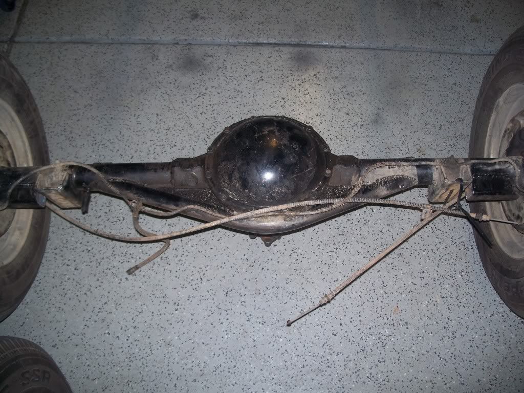

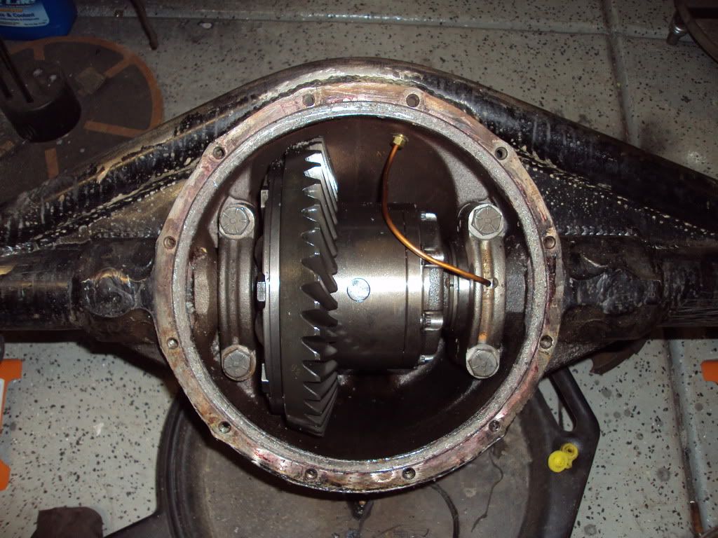

Tore down the rear axle today, everything looks good including the bearings (except some worn o-rings, a stripped bolt hole and crack in a retainer plate and three missing set screws) so here's the plan:
Blast and paint the backing plates and dif cover, strip and paint the housing, clean and repack the bearings, install new o-rings and fix/replace the minor stuff listed above and install new brake shoes. I got a quote for over $1200 to change to 4.10's so I'll stick with the 3.31's for now.

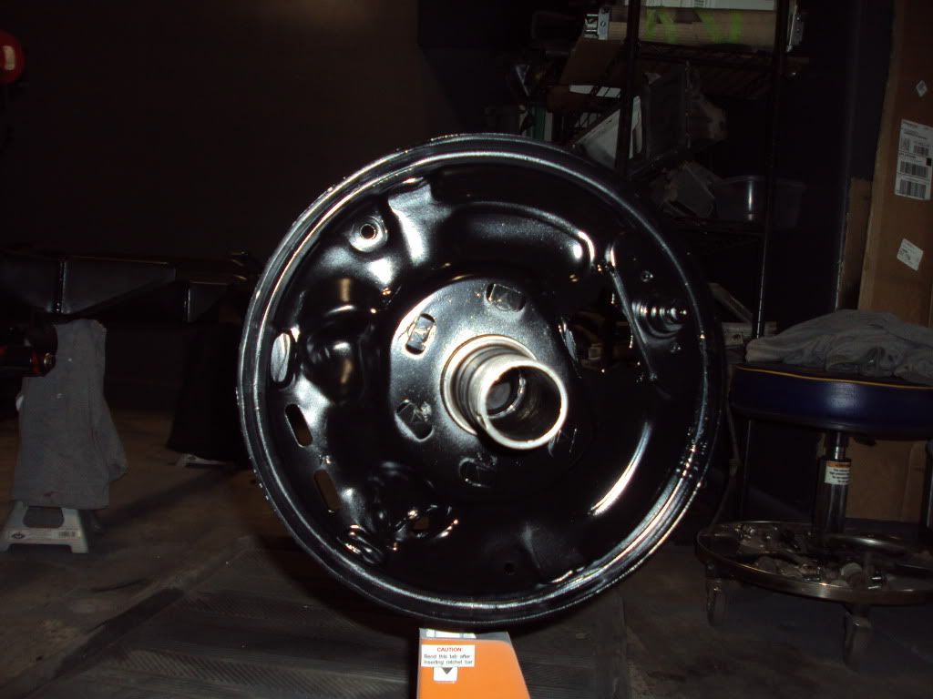

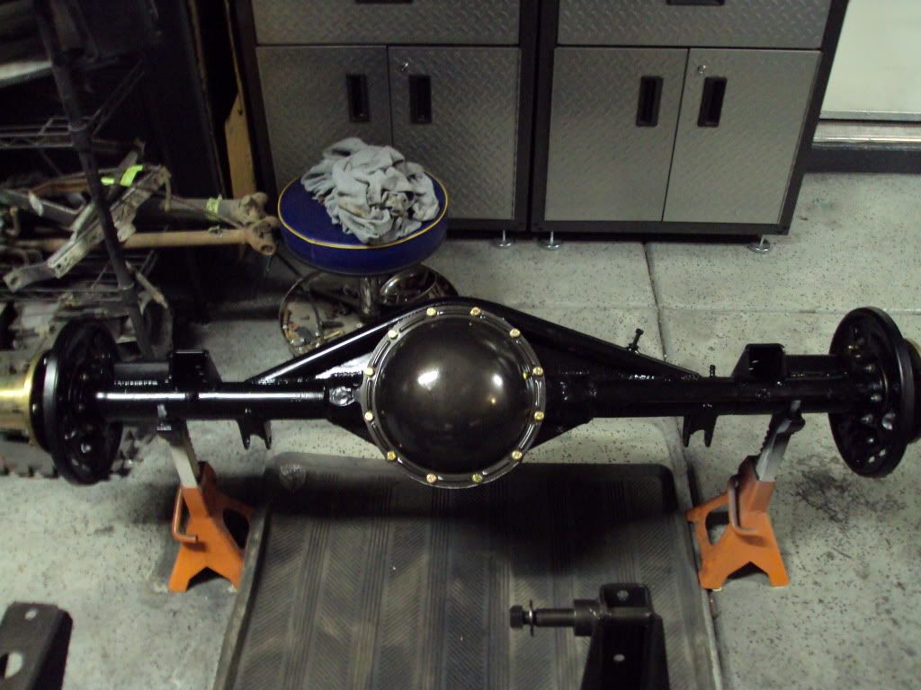

Nearly finished with the rear axle, I'm just waiting for new e-brake cables and speed bleeders to be delivered before I install the brake new shoes and drums.
I ran into some trouble locating the proper size Orings for the rear of spindle-axle tube and the drive flange - hub seals locally and I couldn't find any info on the web to figure out their measurements. I measured them out and ordered these from SmallParts.com: The Hardware Store for Researchers and Developers. They are direct replacements... for any of you guys out there running the Warn Full Floater Kit and can't find them.
Rear Spindle to Axle tube Oring - 2 3/8" ID x 2 1/2" OD x 1/16" W
part# ORB-036-25
Drive flange - hub Oring - 2 3/4" ID x 2 7/8" OD x 1/16" W
part# ORB-039-C

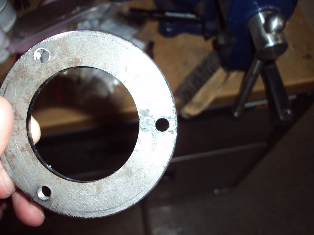

I also used 8-32 5/16" Socket Head Set Screws inplace of the missing set screws from the retainer between the spindle nuts. There should be three per side.
I welded the crack in the retainer plate, drilled and tapped the holes for new 1/4 - 20 x 3/4" socket head cap screws so all the hardware matched.
The bearings were good so I repacked them and replaced everything with grade 8 hardware.
Moving along, slowly but surely..
