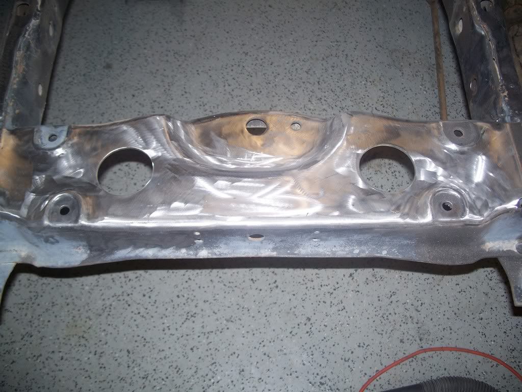

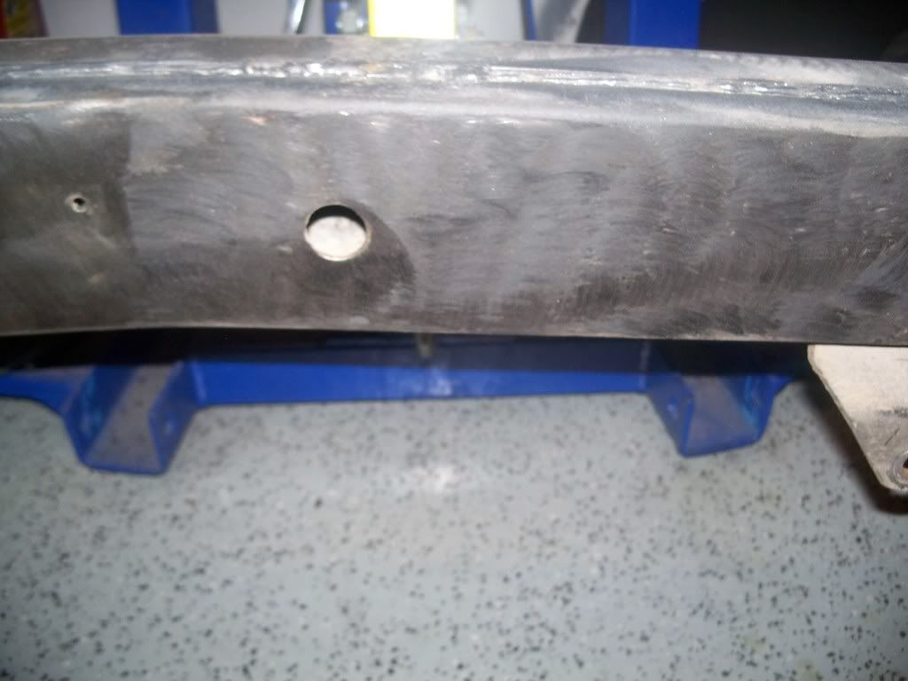

I started messing around with the grinder and wire wheels on the frame today. With the cost of sand blasting being $180 an hour out by me I decided to save the tub and body parts for the blaster and grind the frame and cage myself to save some cash. What a mess, the front of the frame came nice and clean real quick, the rear frame rails were a different story. Seems like there is some kind of coating on them so it's gonna take a while to get it all off. I gotta make a trip to HF and get stocked up on wheels and stuff for the grinder. I figure I can use my little cheap top loading hand held air sandblaster gun to get into the tight areas of the frame that the grinder won't fit.
Being that I live in the desert and rust is not as much of an issue for me anymore I think I'm gonna use that hammered finish rattle can spray on the frame, cage and axles. Any tips for the inside of the frame? My frame has very minimal surface rust, if anything inside of it. Can I just spray it out with a pressure washer? It looks pretty good inside.
I just made some light passes over the frame rails to knock off some of the thickness.
Any tips?

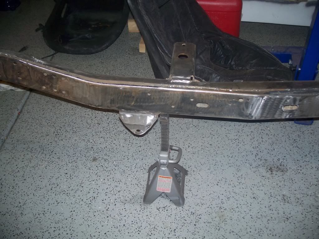

I'm still deep into the stripping of the frame, an hour here and there. Found that heavy wire cupped brushes work the best to knock down the coating and the sanding disks take the rest off to the metal. I bought a portable sandblaster from HF for cheap and I'll use that for the corners and hard to reach areas like underneath the body mount brackets. I also picked up a blast cabinet from there that I'll use to blast all of the small parts and hinges to save some cash and keep the mess to a minimum.

Jeep is looking good and that 350 should be a nice upgrade from that 307. When stripping my frame, aircraft stripper made short work of just about anything that didn't want to come off with a wire wheel. A little messy but not too bad. I just used large pieces of cardboard to keep the stripper off of my epoxied garage floor.
