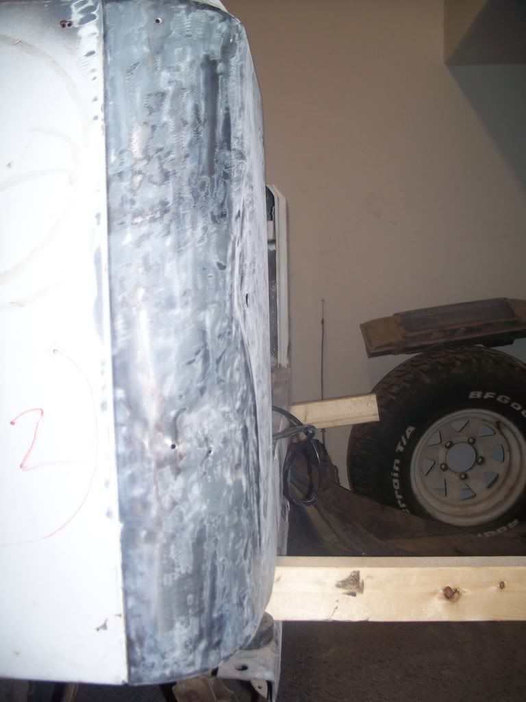

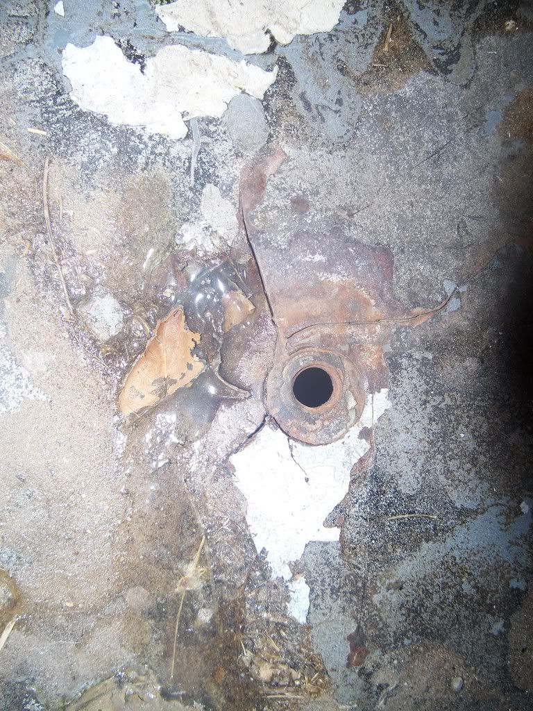

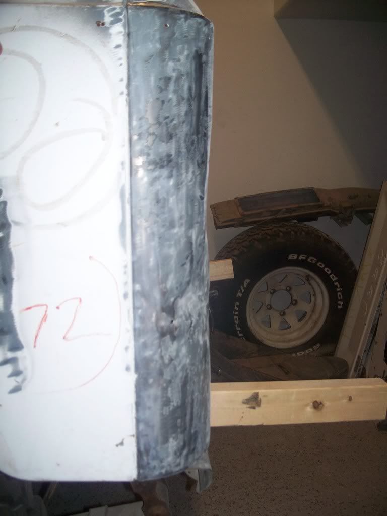

I took the wire wheel/grinder to the left rear corner and stripped it down to see exactly how much bondo was on there. It was thick, over 1/4 inch at some spots. The funny thing is that the damage to the metal is not bad and can definately be worked out, guess it was cheaper for the PO to putty it up. I stripped down some other areas of concern to see what I had. The rust through on the driver side under the door is small and can be patched easily and a few spots that are warped which can be worked back into shape. I found a couple of cracks in the driverside floor where the seat frames bolt in that I'll have to weld up also.
Left rear corner#1.
Left rear corner #2.
Left rear corner #3.
Left rear corner #4.
Driver floor crack.

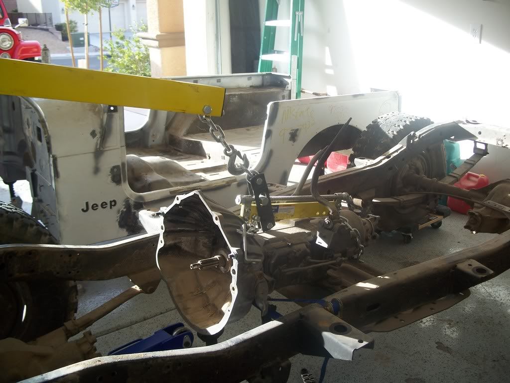

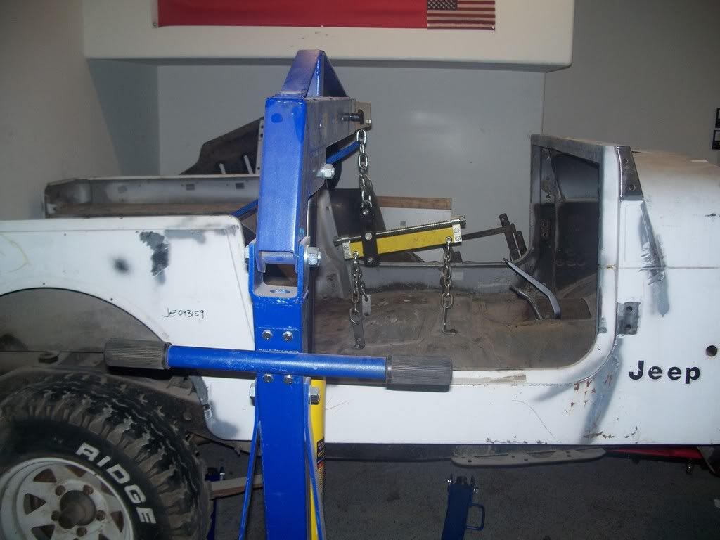

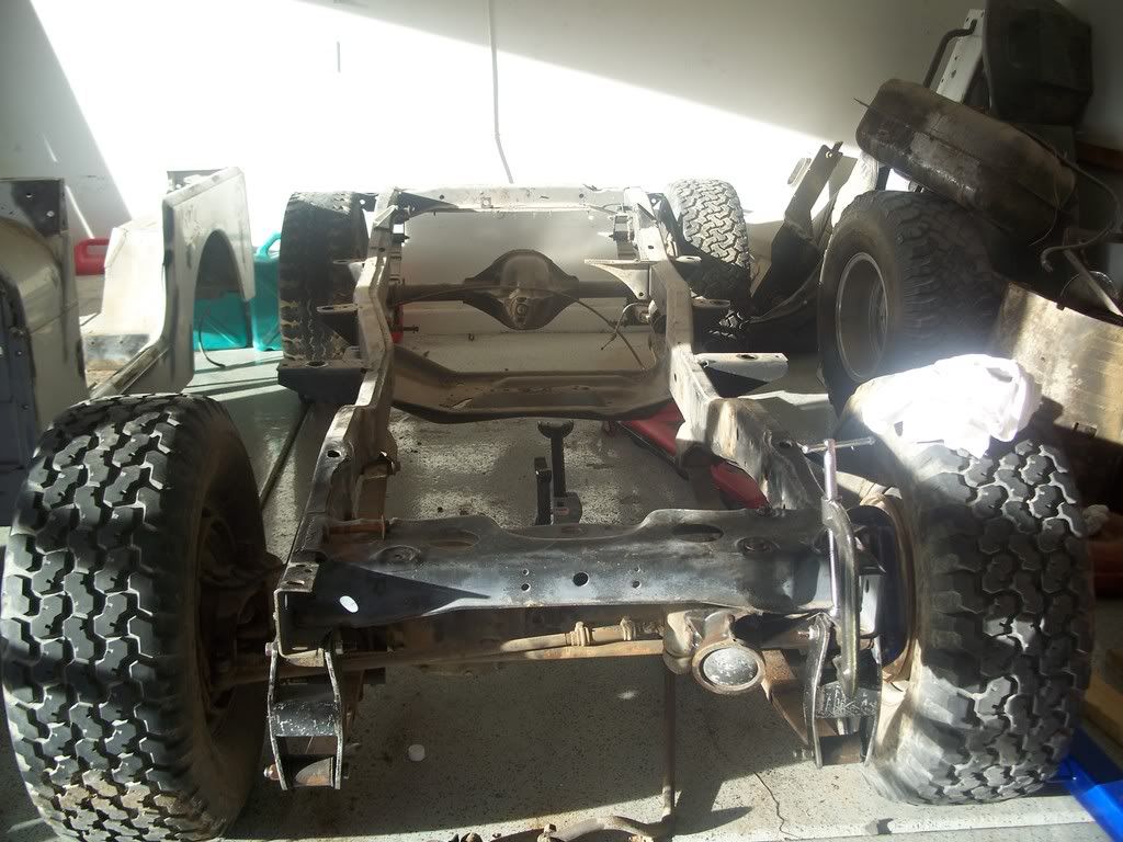

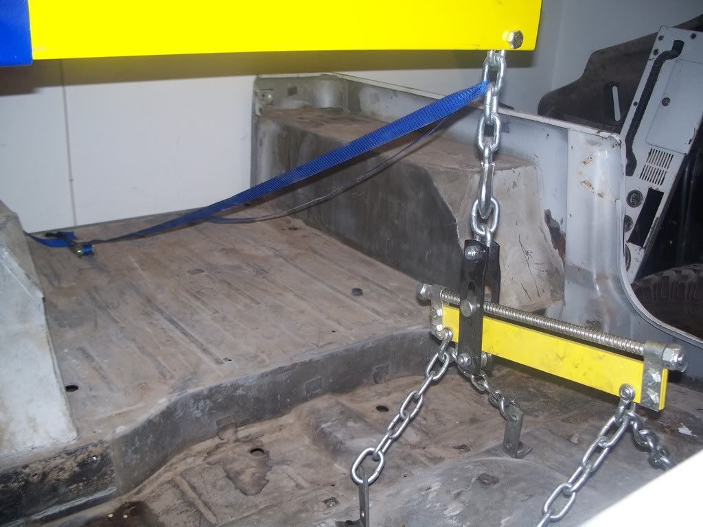

One man tub removal
I had some time when the kids went to sleep last night so I decided to remove the tub.... Well actually I started to remove the front sway bar and power steering gear and encountered stripped nuts inside the frame and some other nonsense. When I was removing the brake proportioning valve I found that the PO put carraige bolts inside the frame to attach it (good for tightening it up, horrible for removing it), they were soft metal so I wound up snapping them off with a pry bar, now I gotta fish them out of the frame. I was going to continue to work on the sway bar and steering gear but those bolts need to be ground off. With the kids asleep power tools were out of the question.
So I decided to remove the tub because it was unbolted already. I used my engine hoist and engine lifting harness bolted to four of the seat bracket mounting holes with a tie down to steady the rear. It lifted clean up and was off within five minutes of starting.
I bought some moving dollies and put the Jeep up on them to spin it around in the garage to make more room. Now I have the Jeep with the Body next to it in the one car bay of my 3 car garage.
I took some photos of the drivetrain and removed some accessories from the engine. I pulled the plugs and found the 3rd cylinder back on the right side was rusted, all others looked clean/normal. So the motor probably has a blown head gasket at a minimum. All the more reason to put in my AMC 304
The frame is solid !!!!!!!!!!
Here's some pics:
Hoist position:
Hoist position side view:
Hoist mounting locations inside tub:
Tub lifted:
Tub off:

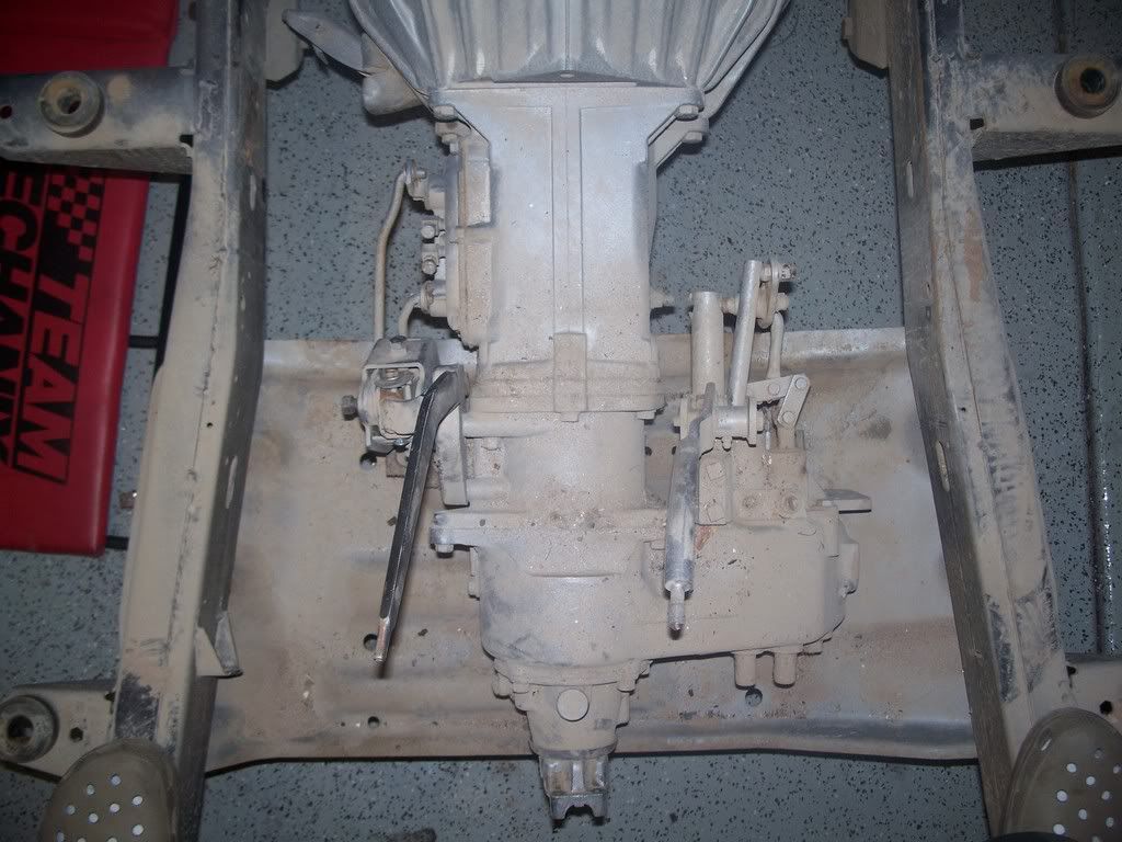

Engine:
Trans:
Trans/xfer case:

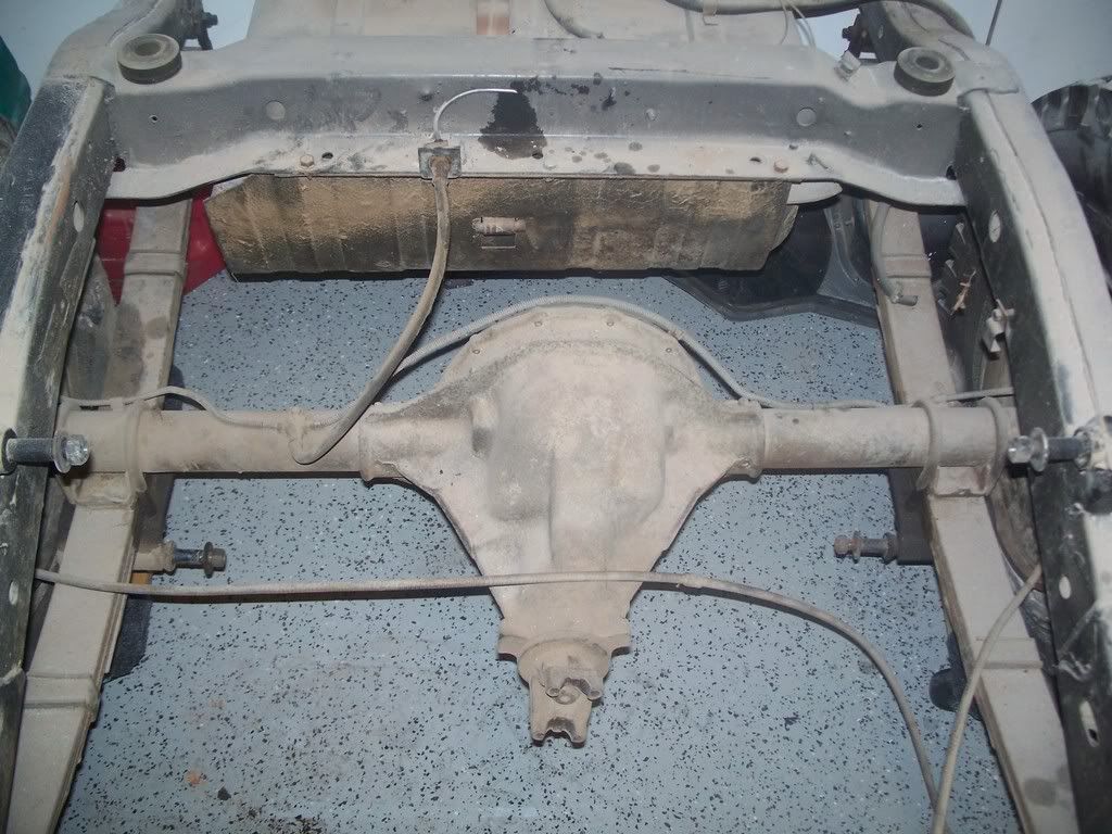

Rear Axle:

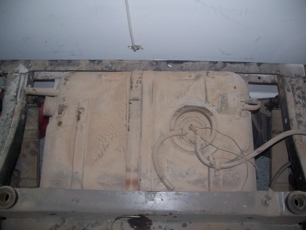

Gas Tank:
I'm leaning towards rebuilding the AMC20 and finding a front dana30 with discs if I can't get the Currie 9 inchers.

The year of the frame is stamped under the forward crossmember of the gas tank. You'll see it when you remove the tank and look up from the ground.

Originally posted by Only in a jeep cj "The year of the frame is stamped under the forward crossmember of the gas tank. You'll see it when you remove the tank and look up from the ground."
Thanks for the heads up, I could only find the serial number on the right rear frame rail so far, didn't know it would be stamped elsewhere. I need to pressure wash this thing once I get the axles and suspension off.

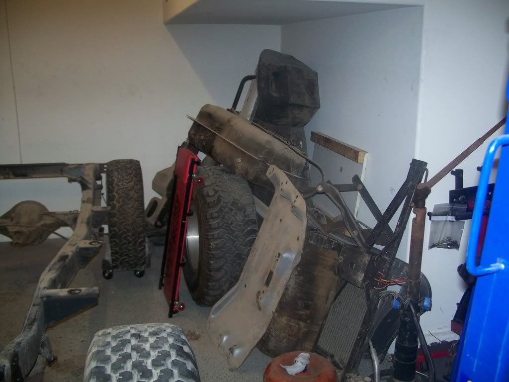

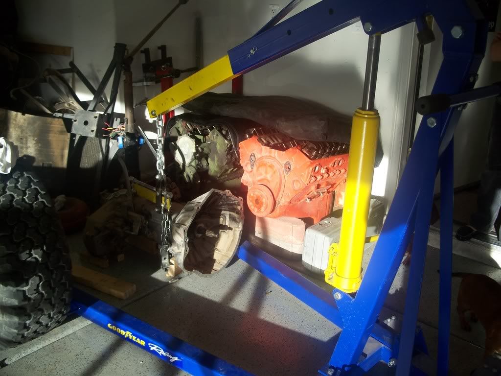

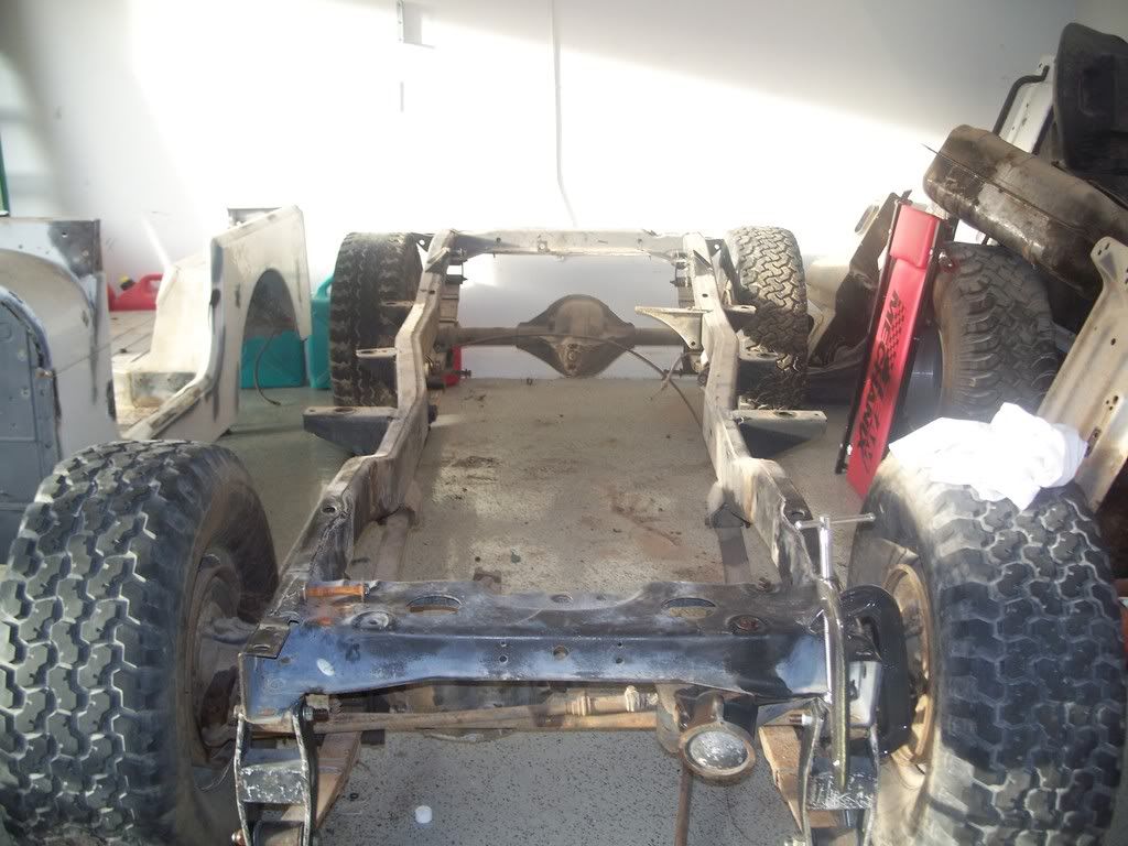

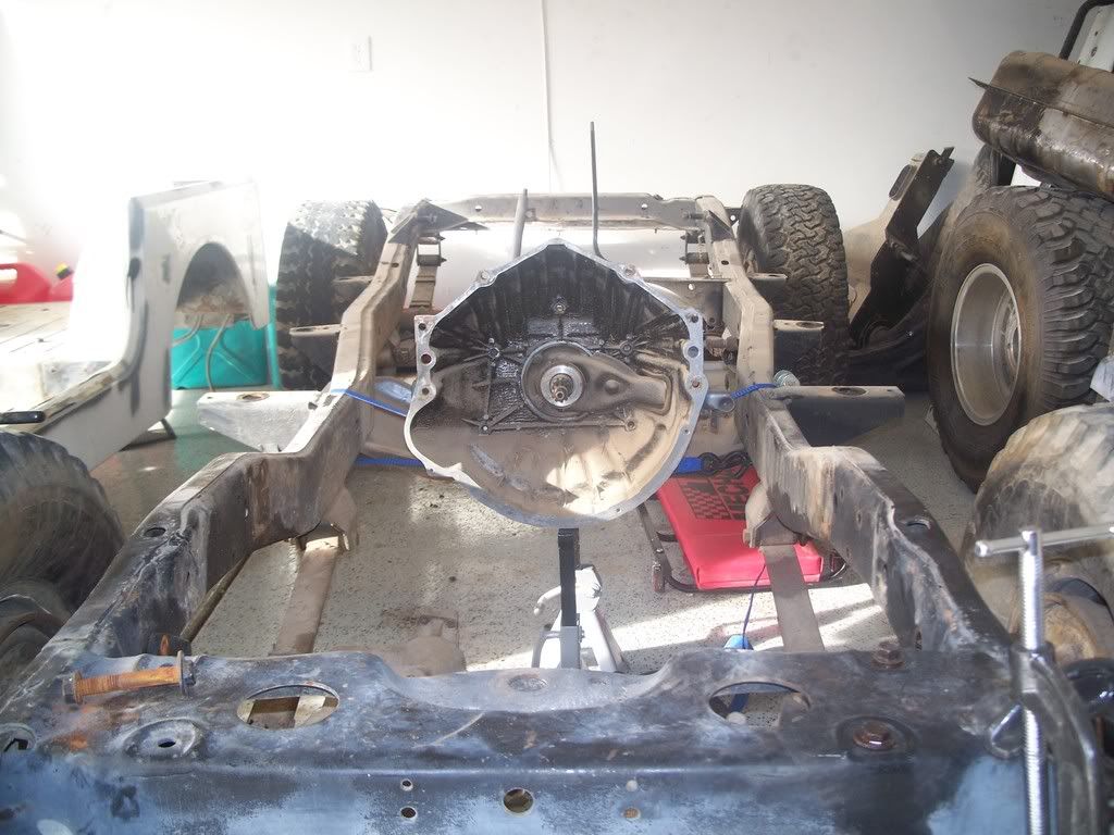

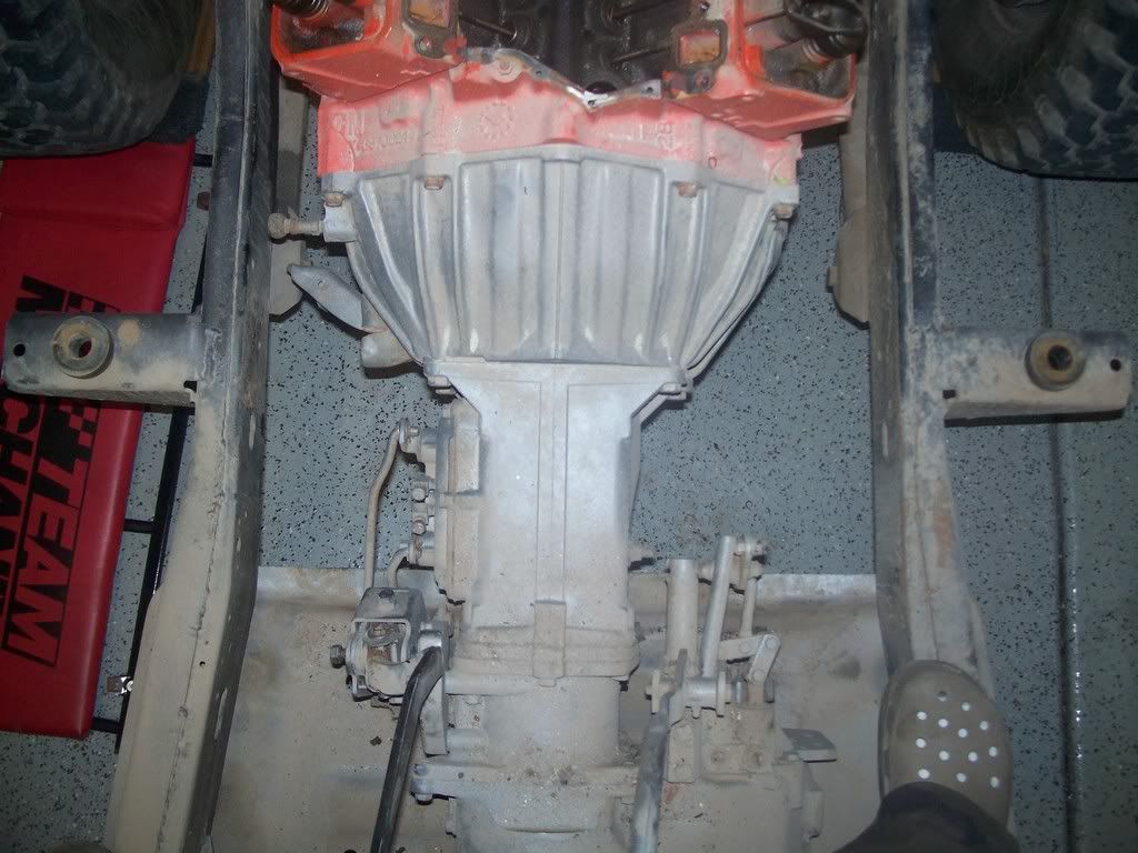

Drivetrain out
I pulled the motor, trans, xfercase and crossmember today. The pile of parts is growing rapidly. It's scattered around the entire garage, gotta get more organized.
AMC 304 on left and Chevy 350 on right:
Motor out:
Trans/xfercase out:
Crossmember out:
One pile of parts:
