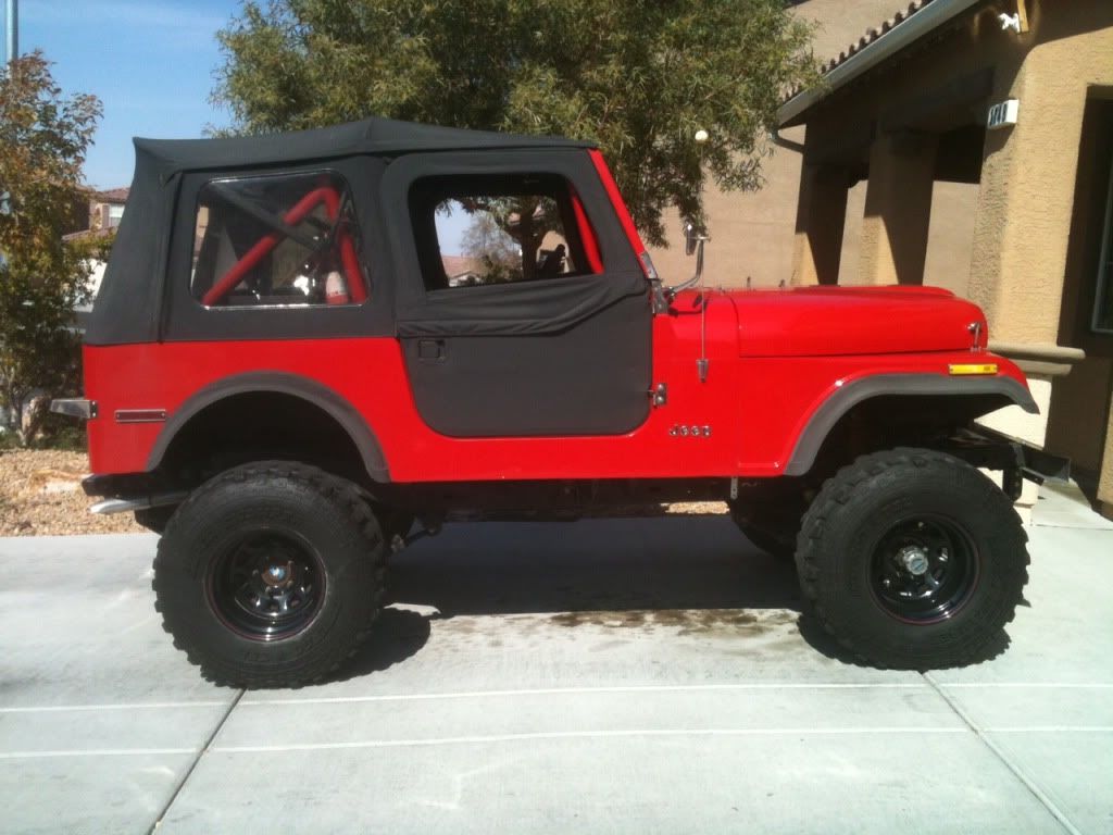

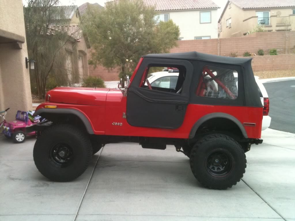

I installed my four inch lift on my 79 today and it looks awesome..... Sitting in the driveway! I've got some serious driveline angles that I need to correct in the rear. I'm not sure if rear degree shims, a transfercase drop kit or both will be needed. I thought it was gonna blow out a u joint at 15 mph on the test drive.

8* shims in the rear axle, some new "U" Bolts and grade 8 hardware all around and now I can drive my 79'. Here's some shots from today:
Rear pinion angle before:
Installing shims with new centering pins:
Rear pinion angle after:
It took about two hours but was well worth it, everything came apart rather easily but only because I worked all the rust loose when I originally installed the lift the lift last week. Onto the next project, reinstalling my sway bar with new urethane bushings and looking for two drop pitman arms. One for the 79' and one for the 83'.

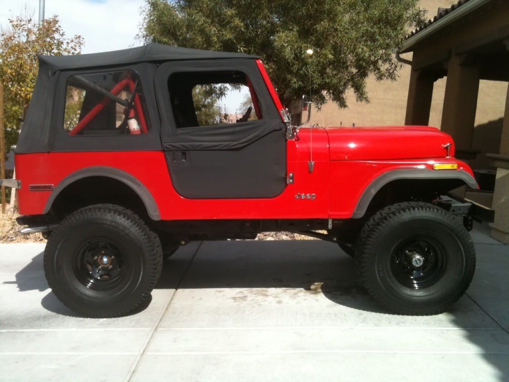

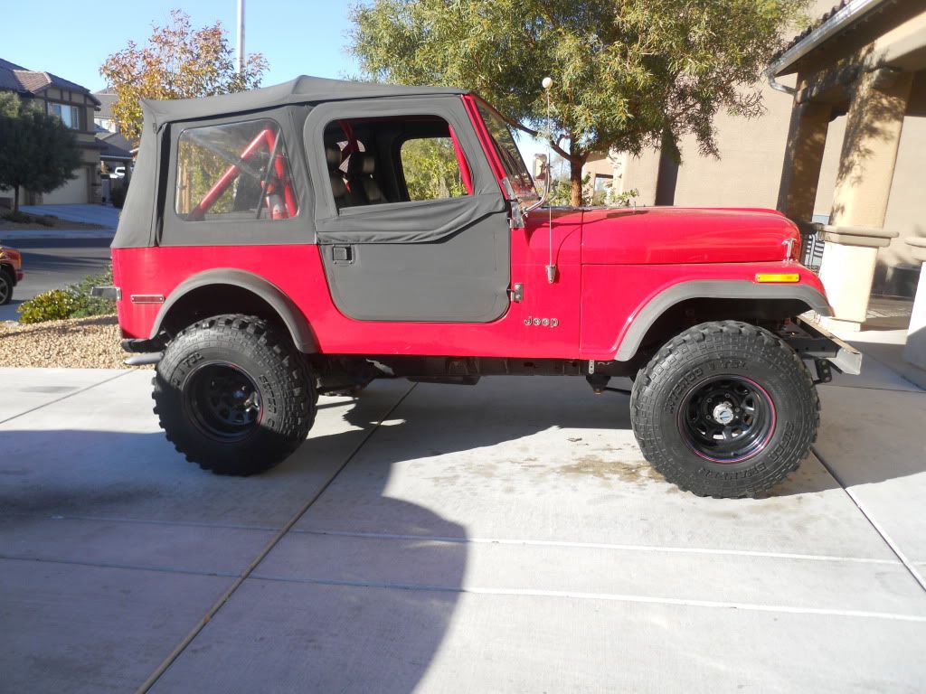

I put my spare 35 on my 79 today to see what it looked like. In the top picture the driver's front is the 35 on a 15x8, the rear is the 33 on a 15x10. After driving on the 33's (Interco TSL's) for a few days I swapped them for the 35's. The interco's were rattling the fillings out of my teeth and the 35's are much smoother on the road.
