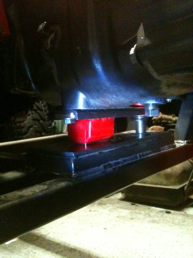

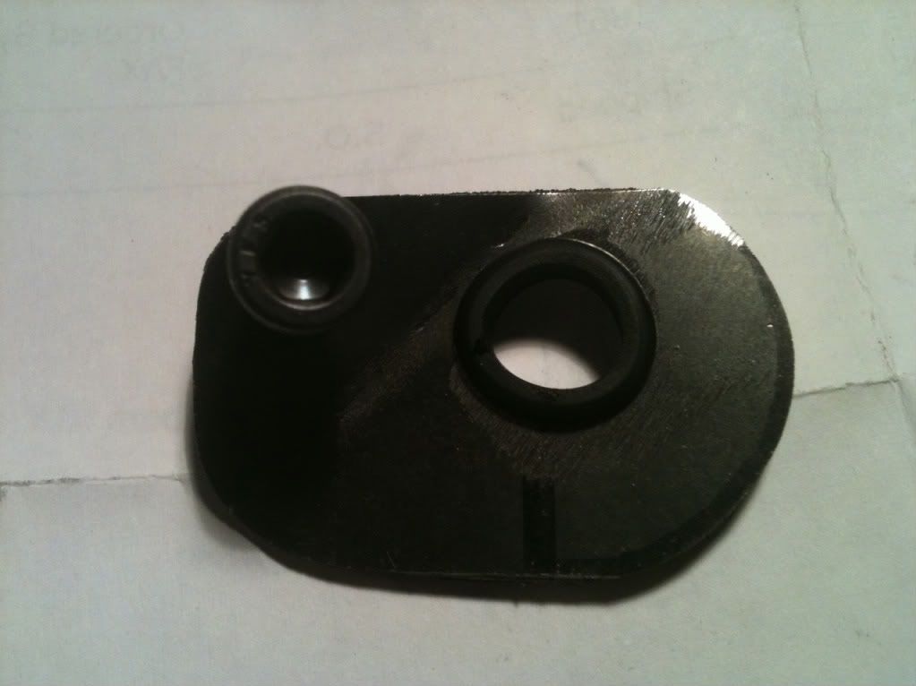

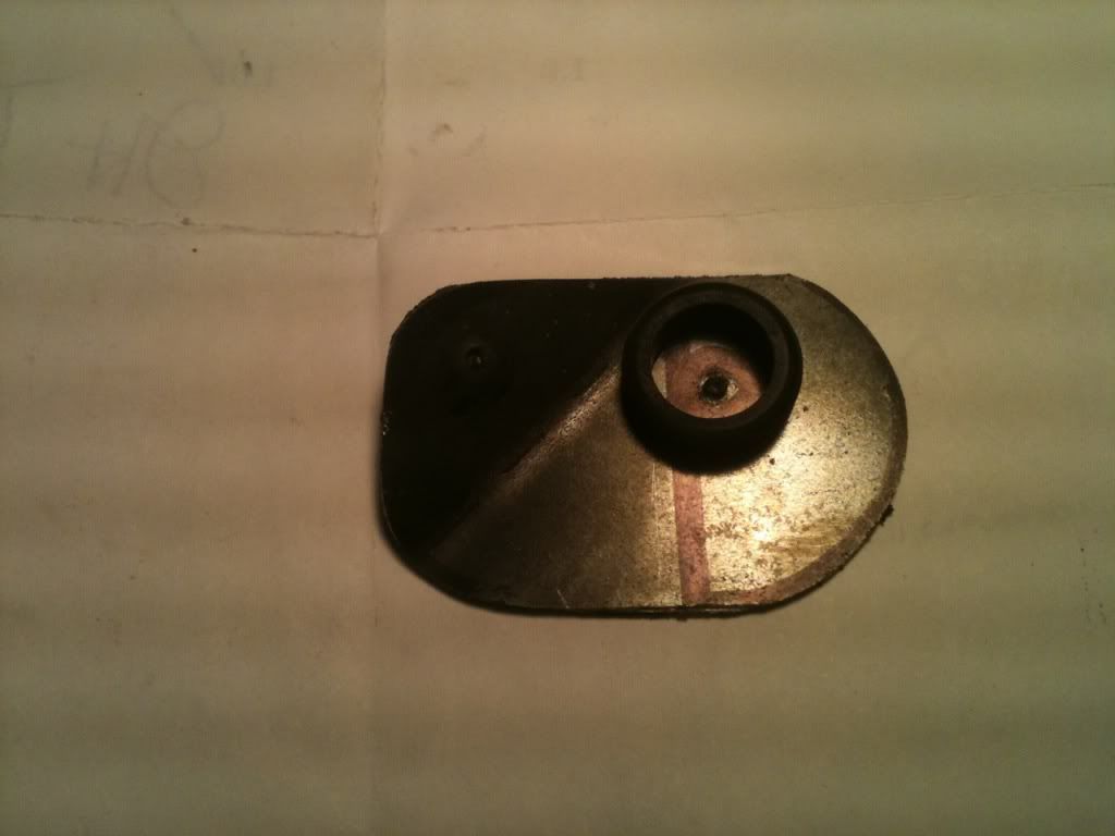

Attempted to get the transmission in today but it turns out that the new throwout bearing won't work. The I.D. is too small to fit over the front bearing retainer, I test fitted the old (square) one and it worked fine. So instead I straightened up the garage and made a new dipstick tube support bracket with a piece of scrap and a rubber grommet. Waiting to hear back from the clutch place about swapping out this bearing for me then I'll get that all in when it comes.

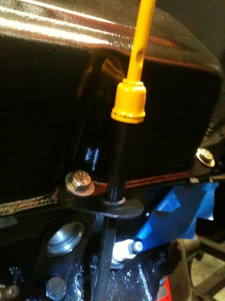

Here's a shot of the little bracket for the dipstick tube:

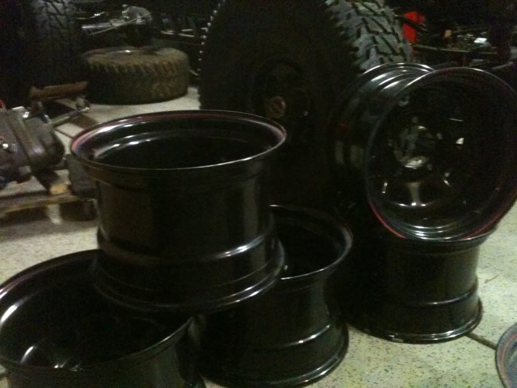

And I also picked up this set of (5) 15x10 4 in backspacing wheels that have never been mounted to an axle for $120.00. Damn I love CL!!! They'll eventually go on my 79 when I get my new springs on and go to 35's.

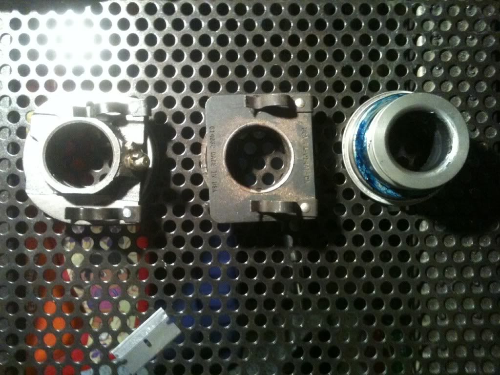

I got the new throwout bearing today and it looks totally different than the original and the incorrect one I initially received. This one did have the clips on the back along with a zerk fitting. (new, original, first wrong replacement)

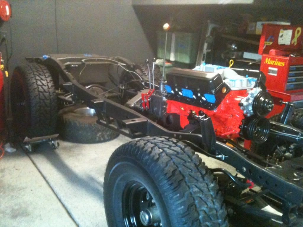

It seemed to fit correctly so I got my workout in by installing the transmission/transfercase combo. It took a little modification to my crossmember to get it to line up perfectly. Basically I just had to enlarge the two transmission mount bolt holes to 1/2 inch because they were just a hair off.

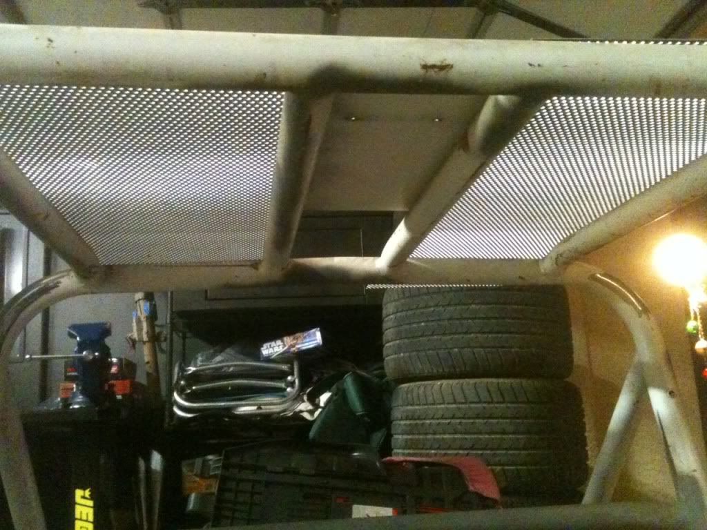

Here is what I was thinking for the rollcage, I'll remove the plate in the center and cover the whole top of the cage with the perforated sheet for a permanent bikini top.

I like this idea well, and I think it is much better than your hood idea.

Thanks Skerr, I need to find another full sheet of this perforated stuff so I'm not welding in three separate strips across the top of the cage. Although the build title indicates otherwise I don't want it to look too ghetto so I may not add the vents to the hood. I've been thinking about it (before I start cutting) and it would really just make a mess under the hood anyway. Any rain or water or mud that falls through will collect and pool on top of the engine. I can add the perforated sheet to the side panels of the tube fenders where they meet the tub if I need them, but I think the extra open area that the tube fenders will provide will aid in air flow through there.

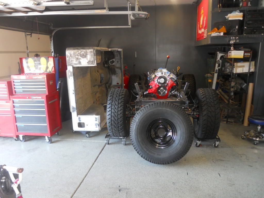

Before/After
Here's my 79' before and after the wheel/tire change. I'm partial to the black wheels.
Before:
After:
