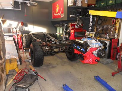

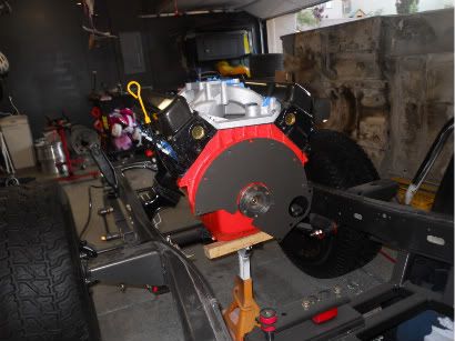

Engine is in !!!

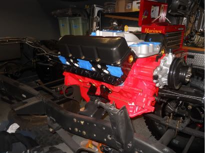

I got the engine in today, it went in very smoothly too. I learned from lessons past to wait to install all of the accessories onto the intake until after the engine is installed in the frame and the hoist removed. I once cracked the rear cooling passage on a performer intake because the hoist chain made contact with it as I lifted it up. I didn't want to do that again. I also installed the crank pilot bushing and the rear spacer plate. Next up is the Flywheel/Clutch, trans and transfercase. It's coming along, today was a good day... Here's a few shots:

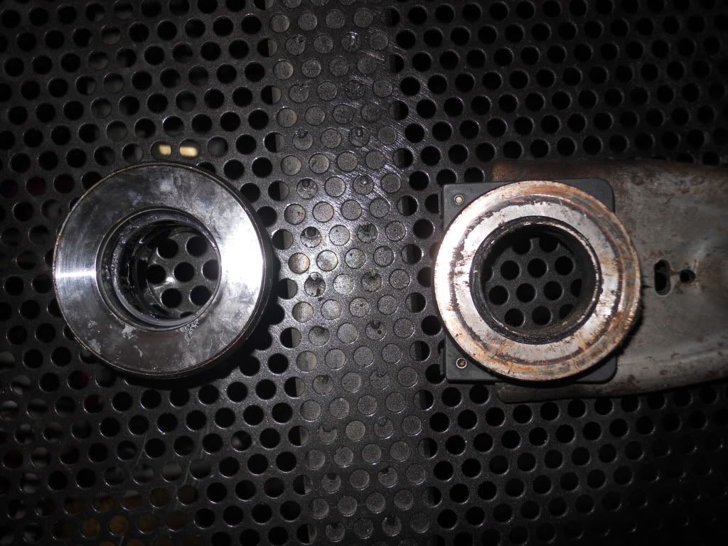

Differences in old vs. new throwout bearing
I went to install the throwout bearing/release fork today and noticed that the old throwout bearing is totally different than the new one that came with the new clutch kit. My question is, does it matter? The old one had a square backing plate with clips to hold it onto the release fork, the new one doesn't. This is my first clutch install ever so I'm not too sure. The only reason I can think of is that the old one came off of a 304 and the new one is a 401 clutch kit. Any advice? Here's a look:

My 258/T176 has the same square one...

OK, the throwout bearing looks like it'll work, it's identical to the one listed in this link and the application chart says AMC 360-401/Jeep CJ. Centerforce N-1491 Centerforce Throwout Bearings

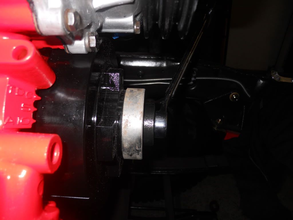

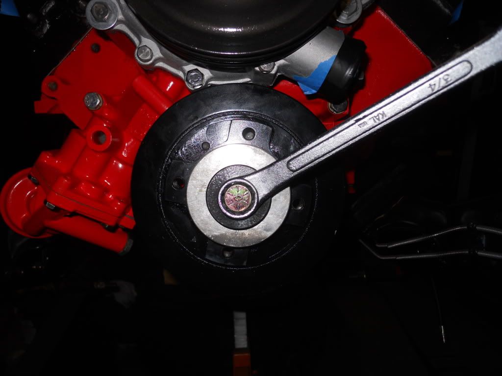

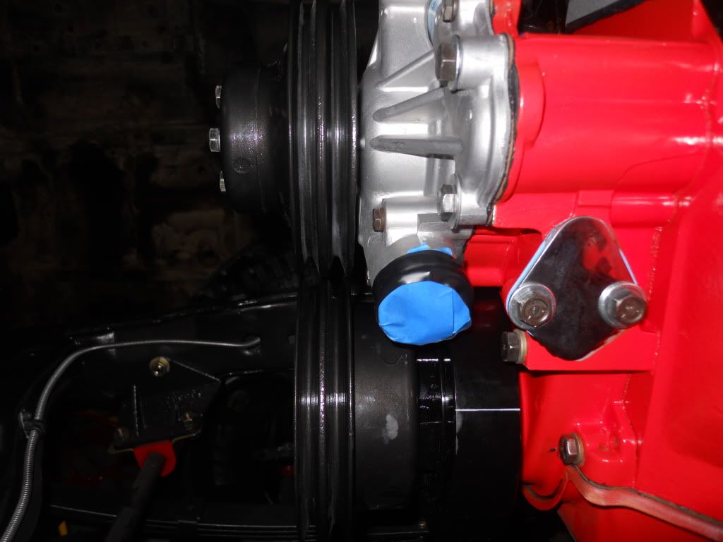

The balancer gave me some trouble but I kept my head and did not resort to the BFH. My puller/installer tool did not have the right size thread bolt so I used a 1 inch thick disc of aluminum I had laying around and bought a 4 inch long 1/2 inch fine thread (20) hex bolt. I put the two together and used them to press the balancer onto the crank. I got it on as far as I could with the pulleys within 1/16 inch of each other. I used a flat washer behind the waterpump pulley to line them up perfectly. Now I'm going to focus on getting the transmission/xfercase in over the holidays.
