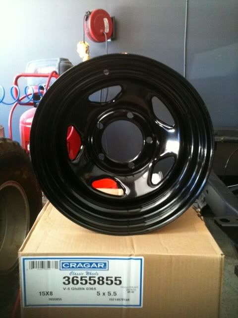

Four of my five new wheels arrived today, gonna drop them off to have the tires mounted. Here's how they look....Not bad for $39 each.

I do like those wheels. What are you going to do about center caps... anything??

The warn hub assemblies are zinc coated and look good as is so I'm not going to cover them up..... I'm also cheap and don't want to spend anymore than I have to on this project .

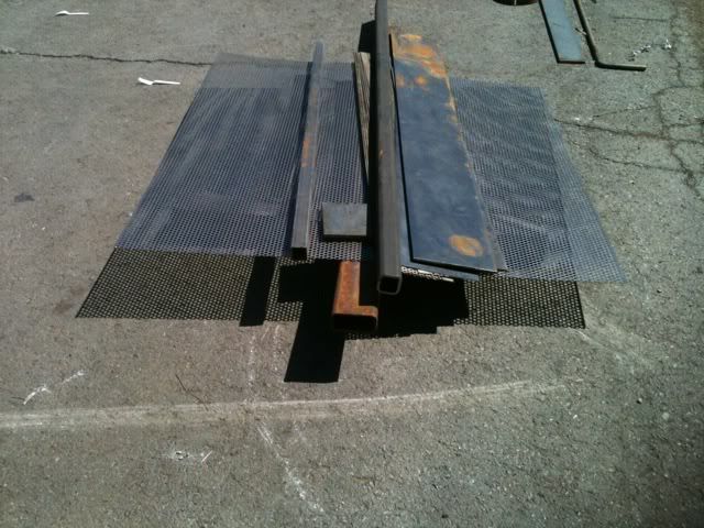

I picked up these materials today for my front and rear bumpers/tire carrier, rock rails, and the perforated sheet for a permanent bikini top for my rollcage and some weld in hood/fender vents......all for a whopping $40
Nice mix of 3/8 plate, 1/4 plate, 1/8 plate, .250 wall 2 x 4, .250 wall 2 x 2 and the perforated sheets.
I was like a kid in a candy store, I thought of many cool projects while there. I'm going back monday for the 20 ton air assist shop press and more metal.

The press will sure come in handy! Be sure and prep/paint your perforated sheet well... my experience with, since it has so much surface area, is that it is hard to paint consistently, and it starts to rust pretty fast.

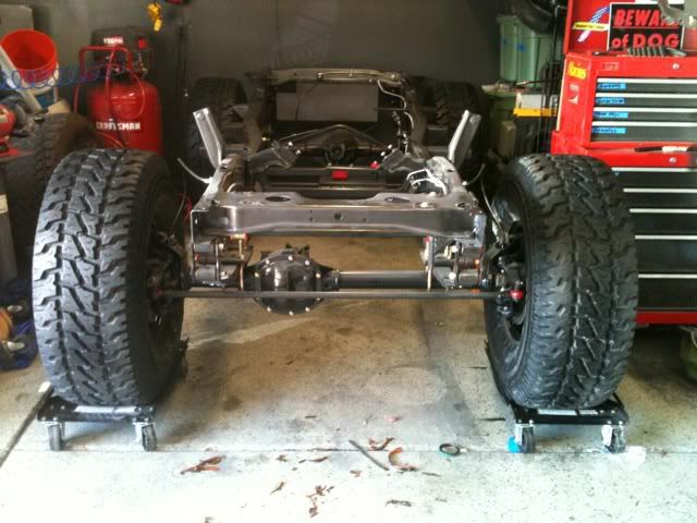

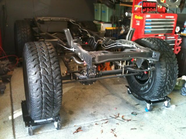

It's on wheels !!!!!

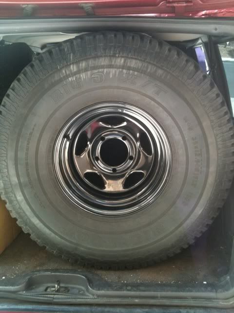

I got it up on the 35's today, man this thing is tall. I forsee challenges when installing the engine/trans and body due to the height. Lot's of ground clearance but the Dana 30 looks like a toothpick under there. I'm gonna need a larger jack also.

The chassis is looking great and your right that D30 looks anemic with those tires. Mine will be the same.

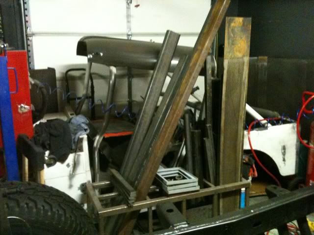

I made my third (possibly final) trip to the shop today and picked up a huge assortment of all sizes of square, rectangle, round tube, flat bar, plate and more perforated sheet. I also got a prefabbed level frame for a welding table and some 3 x 3 square tube for legs. All for $40... and on the way out the guy said to look in the dumpster outside. Glad I did because I found a freestanding rack to stand, organize and hold all the tube. This place turned out to be a gold mine. If I had more space I would've spent all day there picking through their "scrap" which was mostly usable pieces that I thought of a million projects for. The owner is also a Jeeper and had his 5.7 Hemi powered 06' Rubicon there today so we talked "Jeep" for a while.....

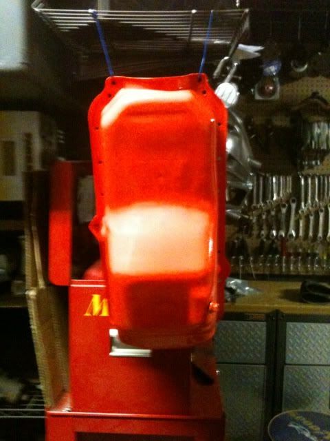

Posts: 1,021

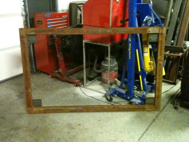

I sandblasted and painted a few more parts today including the oilpan and timing cover. I'm gonna go against the grain and paint my AMC 401 Chevy Orange (only because I already have the paint)...I sold some more CJ stuff on CL and I'm working on building my welding/work table. I need to pick up a top for it. The frame I got is 68 x 43 inches and I'm using 3x3 square tube for legs. I figure expanded sheet would be a hell of alot cheaper than 1/4 inch sheet on top.

Not trying to be critical, but I think you'd be more satisfied using sheet metal for the table top than expanded metal. Besides the obvious factor of small parts (nuts, screws, etc) falling through, it really isn't very durable. It will sag over time after having heavy materials placed on it, and it will warp when it gets hot. Just food for thought...
