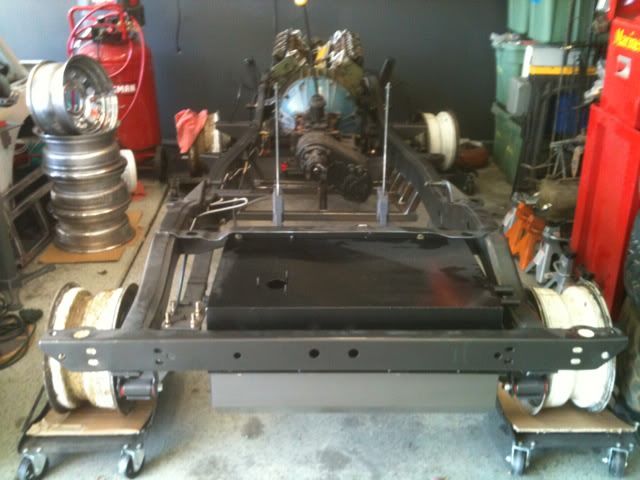

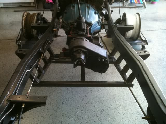

Crossmember is all welded and bolted up. I'm happy with the trade off of all the time put in to it because it bolted right up. So with the drivetrain finally supported by the Jeep (no more jack stands) I was able to move the Jeep around the garage on the dollies and drop in the new gas tank.
I just started a week long vacation so I hope to get moving along on this project now. I plan to have the 35's mounted on the new wheels so I can install them by the end of the week.

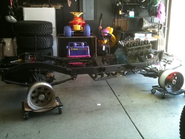

I pulled the drivetrain out and separated the 304 from it. I put the 401 on the stand to start on it put the 304 back under the bench. It's nice having the project mobile on the dollies.
