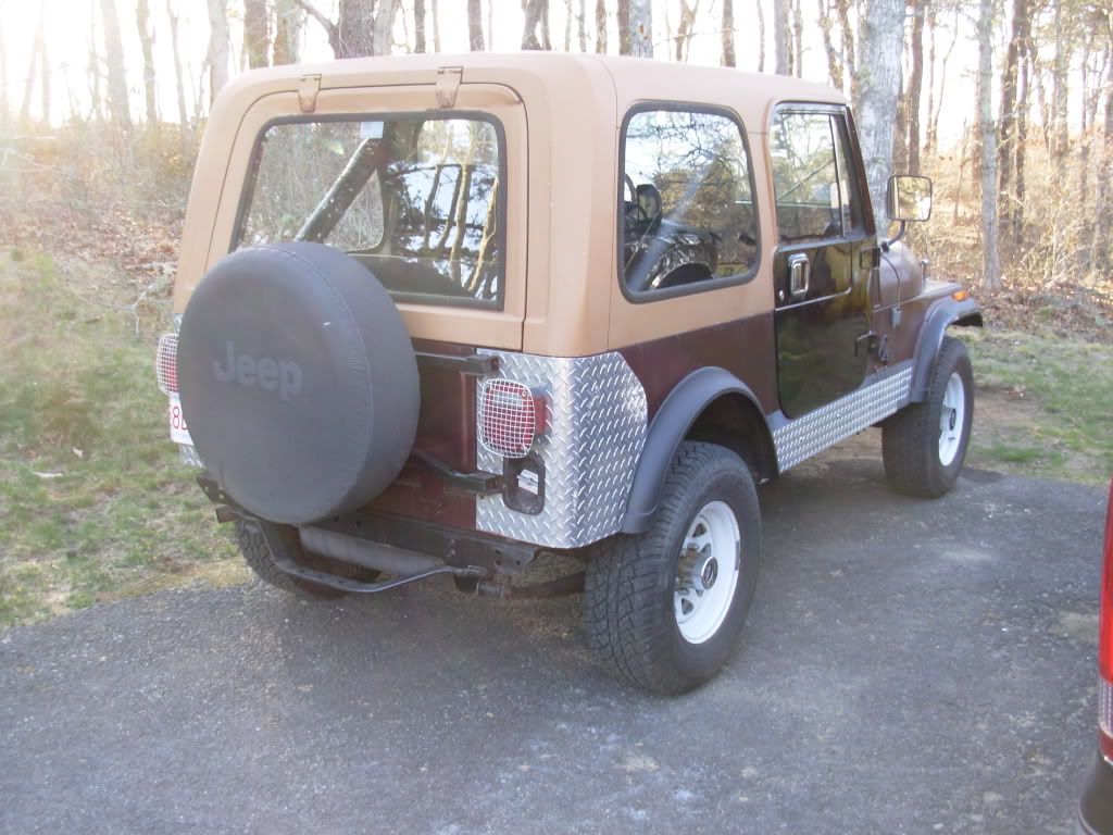

Here is what it looked like when I bought it, minus the hartop and doors.
Also, I have to confess two cjs died so that this one may live. (more on that later)
This one I paid $1500 for. It had 115000 on it, soft top and doors, lots of extras, like tuffy console, neoprene seat covers, bikini top, diamond plate side and corners, head light and tail light stone guards, billet knobs, speaker boxes- lots of stuff I would never buy. (but like)
Yes, it was cheap, but it was only a soft top, rattle can paint job, and the engine had a knock with low oil pressure. More to follow...

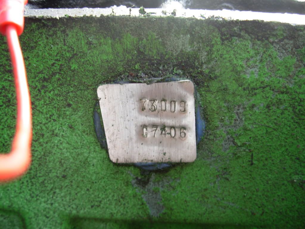

Forward to spring. I was on the look out for a new engine or planning to rebuild the one I currently had. Looking on craigslist I found a cj5 that had a rebuilt in it for $200 bucks. Got it running, checked compression all good. I was still unsure if it had been rebuilt, so I pulled the head, saw nice crosshatching and no lip on the walls. Plus thanks to JF I found out this was a rebuilders tag. Thanks jeephammer!

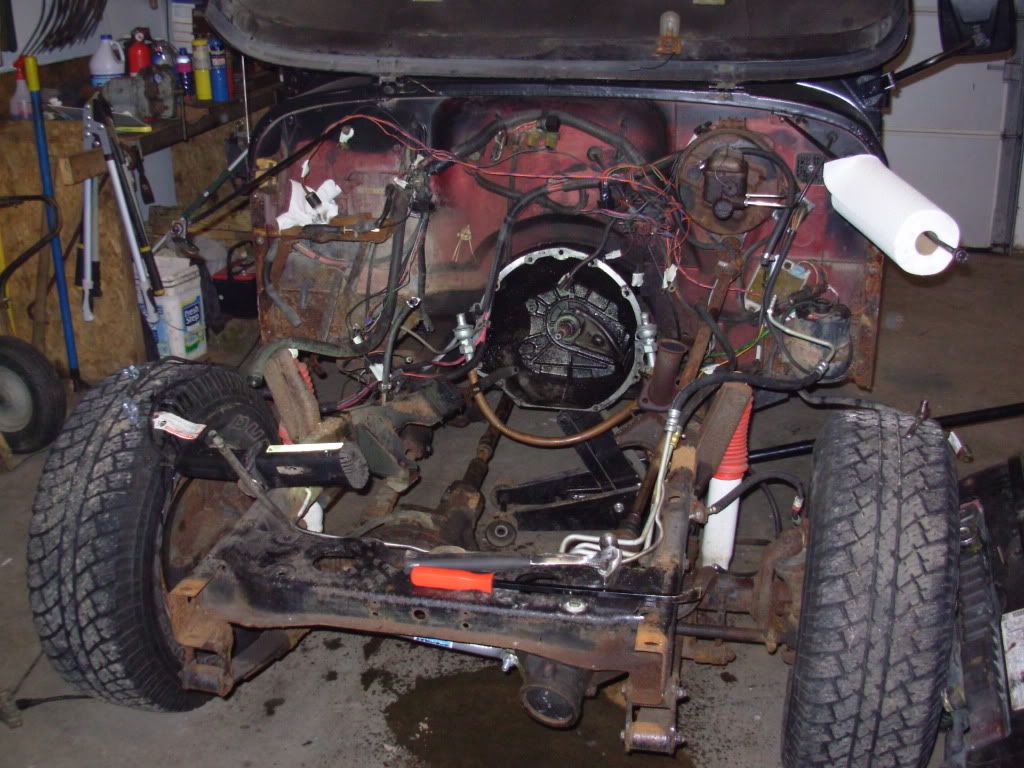

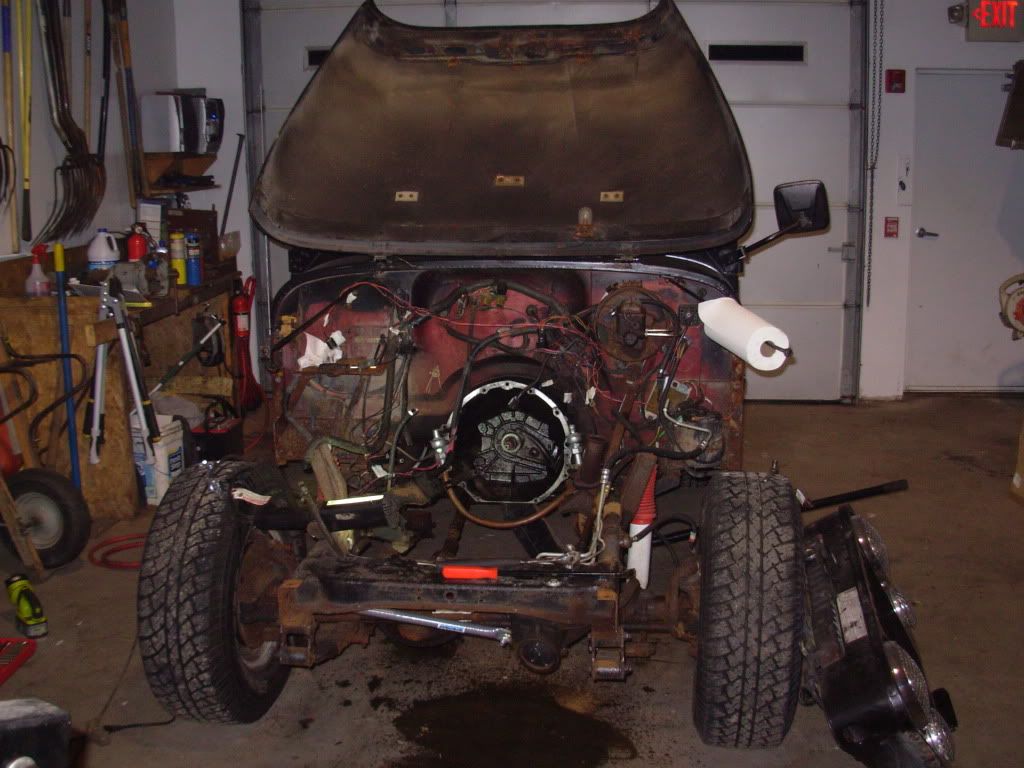

I go through the JF and I see everybody recommends taking off the front clip to pull the engine. One post I saw the guy said, "it took 15 minutes" I think it took fifteen minutes for me to get one bolt off... See below
Moving on it is much better taking the front clip off, but what I discovered was "while its off" I"ll clean, prime, paint, and do the blazer heater upgrade. I don't regret any of it, but it added a months worth of work.
Front clip off

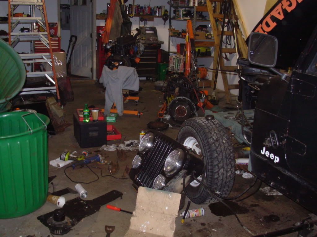

This is the point when I had about four different things going at once. Big time pig pen (no offence to my avatar)
