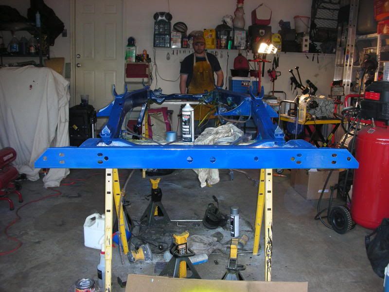

Speaking of the frame, earlier I posted a few pictures of it…it was in fairly good shape for almost 30 years old! I had to cut off three bad body mounts, and the rear cross member and weld on new. We spent days with a wire wheel, pressure washer, scrub brush, etc cleaning it up and prepping it for paint. We coated it with POR-15 inside and out. One note about POR-15 if you have never used it, follow the directions and wear gloves, it doesn’t come off! We coated the frame weeks ago and I still have specks of it all over my arms.
Here is shot of the frame pre-paint but with all the new stuff attached.
Originally I was just going to paint the frame with POR-15 and coat it with chassis black…but all of my friends who have been helping me these past months gave me a bunch of crap about it. “Your supposed to paint the frame a different color man, so people can see how much work you put into it, didn’t you know?” Well I didn’t, but I was informed. So I settled on yellow, don’t ask me why I thought it would look cool.
Here is what it looked like when I started….
I got almost the entire frame coated and looking good, then my engine came back. The guys at the shop painted it old Ford Blue, which according to them was used on AMC trucks in the 70’s. I am not sure if it was, always thought AMC used a lighter blue, but it looked great so I didn’t complain. Anyways….of course the frame and the engine didn’t match. Enter my friends on Wednesday night (always the night to gather and work on Jeeps) who proceed to give me a bunch of crap until I change the color!!
Here are some shots of the frame with the new paint.
Another with me in the background…
I still have to paint the other side, and second coat this one but I think it looks pretty good! You can see in this shot one of the new Ford shock towers I welded on, supposed to get me more flex on the trail—we’ll see.
Well folks, that’s about it for now. More to come in the following weeks!
