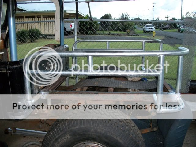

Digging the build! Keep going bro, my 73 Cj6 project was mentioned earlier in your thread. After a few tries I finally found a bed design I liked and I'm slowly finishing it up.
Are you planning to close off the back of your tub? I used YJ rear corners and a 70ish tail gate skin to enclose the cut tub.
Have you seen the Alaskan build using a custom ute bed? Not a CJ6, its Brute conversion, still a very cool and functional looking jeep.
Sorry bout the bed post but I got nothing useful on the engine swap, I just enjoy seeing other jeepers flat bed ideas!

Yes the back of the bed is closed off. I just used flat sheetmetal not quite 1/8th thick and then welded angle on the top of that so I can bolt the top to that. It works great! Not to criticize your work but it looks like you welded the bed mounts to the frame...I would suggest making them removable because "You never know". Also I don't like welding ANYTHING to the frame if I don't absolutely have to. If you are like me and plan on keeping your jeep the rest of your life you will thank yourself, even if it is maybe 10 or 20 years later.

Yeah the bed is tacked on for now in the front to hold it in place. I'm going to mount it using angle iron bolted to the frame. I'm welding in the checker plate floor and didn't want the bed moving while I work on it.
As for welding to the frame, I've plated it up front to run a wagoneer power steering box and welded in new hangers to run the wagoneer axles and have partially boxed the frame. I have no qualms about welding to my frame. This jeep has been in the family since new, I'm sure with the plating I've done it'll be around for my son to enjoy.
