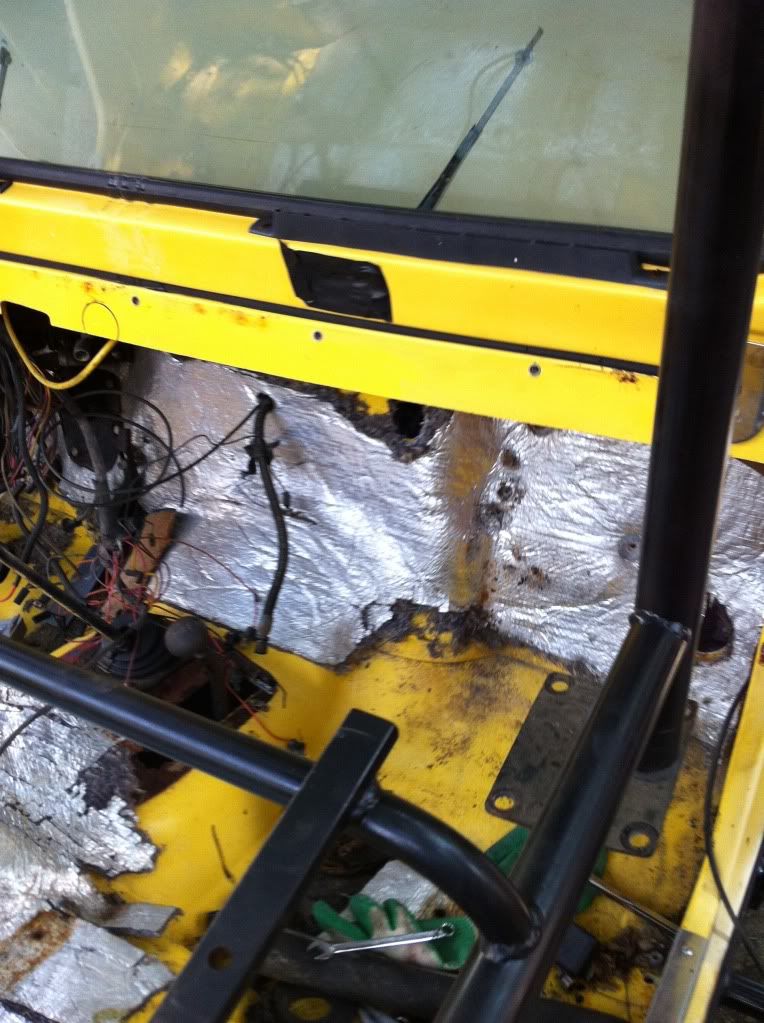

I started ripping out the interior, to bedline.
The PO, put in a bunch of insulation and glued it to the floor. Its a pain to get off.

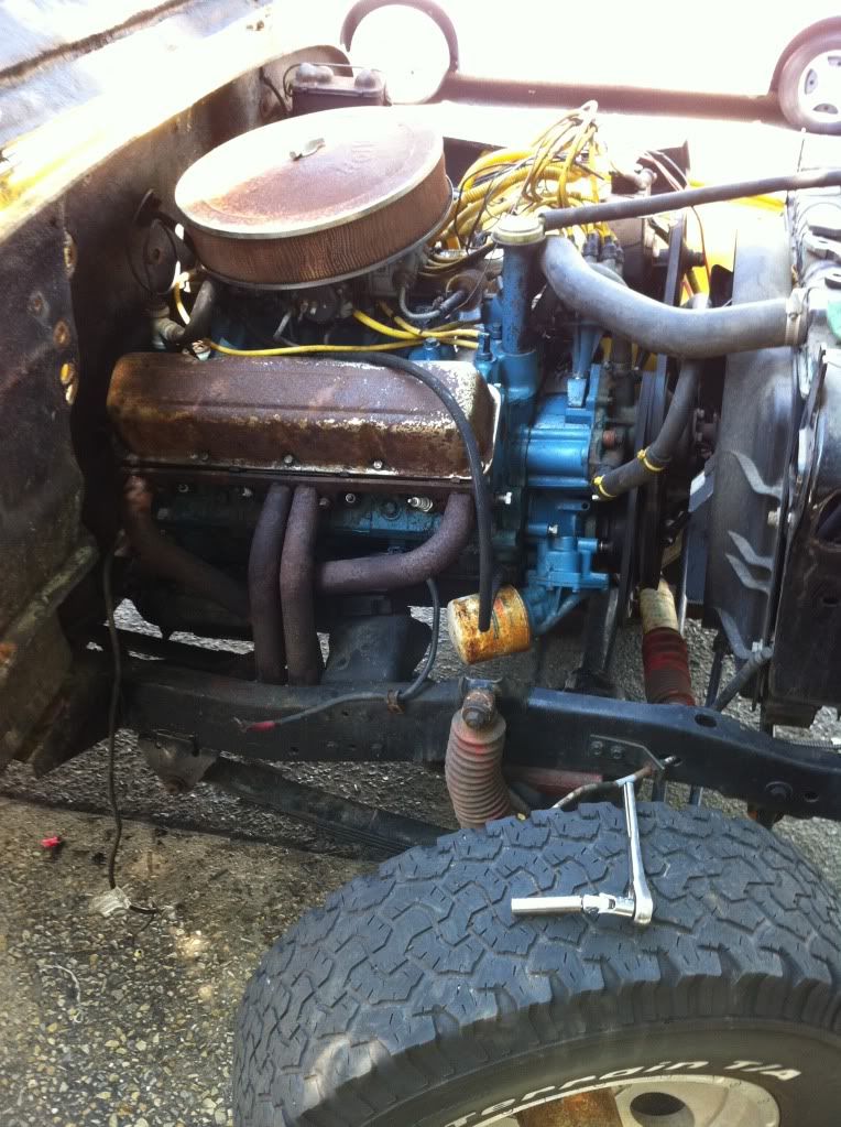

I took off the passenger fender to replace the headers, plugs, and paint the valve cover.
New "fenderwell" headers on, along with the painted valve cover. I eventually want to get aluminum "Jeep" valve covers but these steel ones will do for now.
I started to mock up the front passenger side fender. TNT 4.5" flare.
The "nutserts" spun inside the tub for the fender bolts, so I cut the old fender off. I tried to access it from behind but it was a no go. I made a bracket out of some 16g steel and bolted it to the fender and then the tub. I drilled holes in the tub near the old mounting holes so the bolt heads would sit in the tub and the fender would be flush.
Its on.
