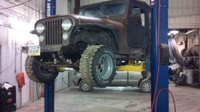

the reason you cant turn sharp is your steering arm is at such a sharp angle due to the lift and not installing a drop or flipping the tie rod. also, if it has never been adjusted, im willing to bet you only get about a 1 and 1/8th turn from straight to right, and close to 2 turns from straight to left? when installing a lift the geometry of everything up front is thrown off.
ETA:
here, red is where you are, green is where you would be with a drop pitman arm
and here, red is where you are, green is with a tie rod flip
-John

I wondered about getting a drop pitman arm. I will see if I have even turning center to lock each side. Thanks for the input, I do appreciate it. Will definitly look into flipped steering arm, that sounds like a better idea that the drop pitman. Biggest reason I say I can't turn very sharp is because the tires rub on the springs. I ordered some 1.25" spacers to solve that problem.

ohh, DUH! i didnt even think about rubbing. i told you all that because that is what we determined here this past weekend. before we decided on a new tie rod, we adjusted the old one. had to bust out the torch, massive pipe wrench, and a 4 foot metal pipe to break it free to turn it outwards. invest in all of the above and pb blaster. and motrin.
you should be able to adjust your steer stops to prevent rubbing, if you dont want spacers.
