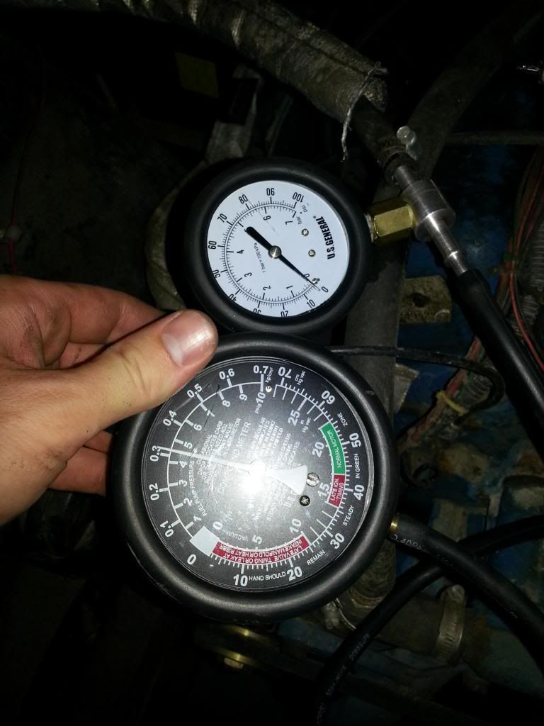

This is the issue I'm having. It has the original motorcraft carb, there is an electric fuel pump installed. The PO said he rebuilt the carb, which I believe. He said he thinks it's running a little rich due to too much fuel pressure. After driving it more, it does seem to be a richness problem. It will buck and die. If I wait a few minutes it will start back up. My question is. Do you think I should start by pulling the carb apart and going through it, or slap a FPR on it? I have a lot of experience with motorcycle carbs, but none with automotive. To me, even if the fuel pressure is kind of high, the float needs should be stopping the fuel flow when the bowl is full. Looking for advice on this electric fuel pump/carb situation.

If you are over 5PSI you need a regulator, assuming you are running a 2100.

Yes it's a motorcraft carb. I'll see if I can get a gauge rigged up.

So i hooked up a gauge from my "fuel system test kit" and It read 2psi.. if that. So I was thinking I've got a problem. Just to be safe I hooked up my "vacuum and fuel pressure kit" and I got 4.5psi. I believe the 4.5psi. Which should be ideal right? I guess it's time to pull the carb and go through it. I did verify the accelerator pump is working.

Installed 3rd gauge. 4.5 PSI.

Found that the float level was way off, and the top gasket was out of wack. It's running much better now but still needs some fine tuning.

should have around 7 psi. id put a stock mech. fuel pump on it and keep the electric for backup. but yeah the float level being to high would cause it to run rich, thats a cheap easy way to richen up a lean burning engine. sometimes people will do it to keep the engine from pinging, did it on my 454 that was high compression, it works for that purpose but also kills gas mileage. glad you found out the problem. amazing how some people cant rebuild a simple autolite carb without messing it up.
