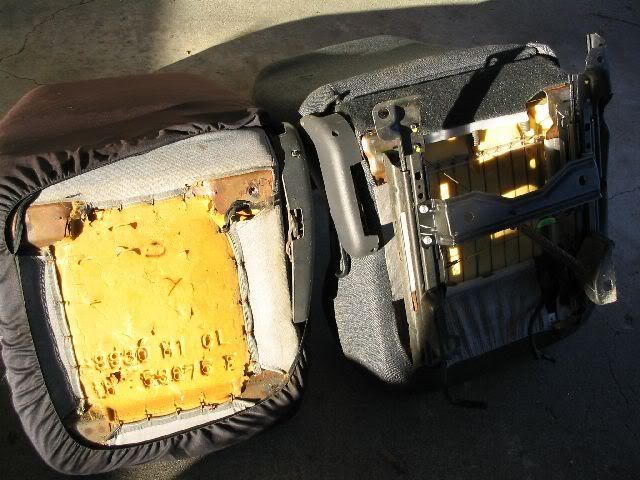

Some say they were a direct bolt in with no mods required. Some had to drill/weld/etc. A mystery I guess. Most likely they made small changes over the years, or had different OEM suppliers, etc. Those things happen.
One user posted this picture showing holes that line up:
