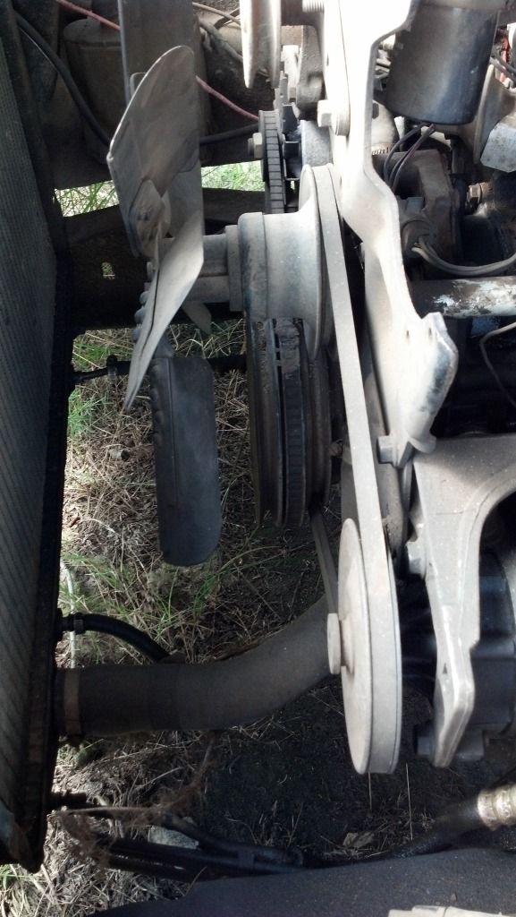

Originally Posted by rixcj View Post
There are two different "thicknesses" of water pumps for AMC V-8's available. By that, I mean that one pump sticks out farther from the block than the other. This will have an effect on where the water pump pulley ends up.
Perhaps Ford has the same option? Just a thought...
Rich
Yeah Rich, I know what you are talking about. I think Chevy has a couple of different length water pumps too. I measured an unmolested 351W in a junk yard the other day and that water pump and mine are about the same length... about 6". I think the water pumps are the same. It appears the balancer is different. I think all 351Ws are 28oz balance... if so, I might be able to swap for a later model balancer. The one I have now is a Fluidampr ($200+ ). Maybe I can sell it on eBay or something. Anyway... I'm just wondering if the V-belt route is the best way to go if I'm gonna have to start changing parts. Maybe someone else can chime in on that one. The pic below is of the junk yard engine. (quite a nice engine... kinda wish I had the whole thing )

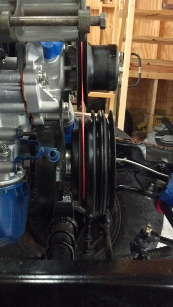

OK, some progress lately. On the pulley issue, did some research and found out that Fluidampr makes a crank pulley spacer... 5/8"... just what I need. Ordered one and should be here this week. This should solve my pulley alignment problems. In the pic below, I shimmed out the crank pulley with some washers to about 5/8” and all is looking pretty good.

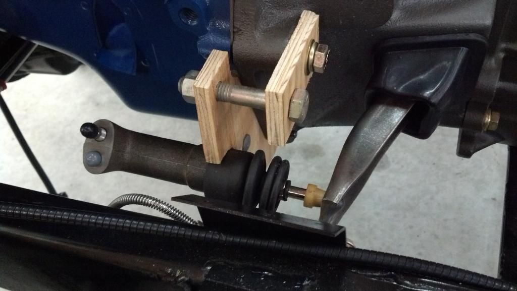

And finally, been working on the slave cylinder mount. Cut out some cardboard templates then transferred it to 3/8” plywood. Mounted it up and… dang! I think this might actually work. Now to find someone who can re-create my plywood mounts in steel plate. I’ll let ya’ll know how that turns out.

Bob the stainless tub mounting hardware ought to last you a while. I didn't go back and look, so I'll do it the easy way, where did you get the slave cylinder?
Jim, my Jeep originally came with the 151 cid "Iron Duke" engine with this slave cylinder. I always knew I wanted to try to make that work without having to cobble up a mechanical linkage. Would have liked to have gone with the hydraulic clutch bearing (not sure of the technical name for it), but those things seem to never get any good reviews. A shame though, it sure would simplify things alot.
If you need some steel plate cut out on a CNC machine, PM me and I'll give you the info on how I need you to send me what you need cut.
Thanks aggiejon... yesterday, got a piece of 3/8" steel and gave it to a friend who says he can cut it out with his plasma cutter. I told him if he can do that, I will drill the holes and clean up the edges. Thanks for the offer!

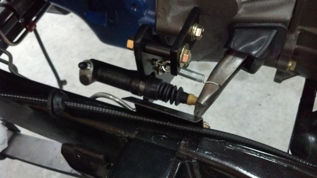

There hasn’t been a lot of progress lately that I can show. However, I have completed the clutch slave cylinder mount and I think it turned out great. Strong as h*!!… I think you could pick the engine up with that mount… don’t think I’ll have any trouble with the mount flexing. May have to work with the stroke a little when the time comes.

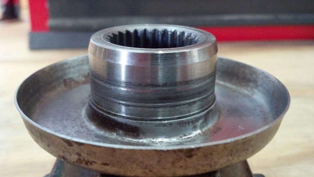

Also forgot to mention that I'm still trying to cure my D300 leak. Figured out the leak (or at least part of the leak) was coming from the front output. Pulled the front yoke and seal... this is the yoke... notice the groves, I think this thing is wore out. (Like so much of the rest of the Jeep! ) I've just ordered a new yoke and seal. Since I'm having to change the yoke anyway, going with a u-bolt type yoke over the strap type.

Nice work on the bracket Bob. Yoke looks just rough enough to cause trouble.

The Rugged Ridge yokes I ordered did not have the correct dust shield, so you may want to hang on to the original. I had to drill a hole through the dust cover and dimple the yoke and spot weld them in place. Somewhere in my thread I have pictures of what I did.
