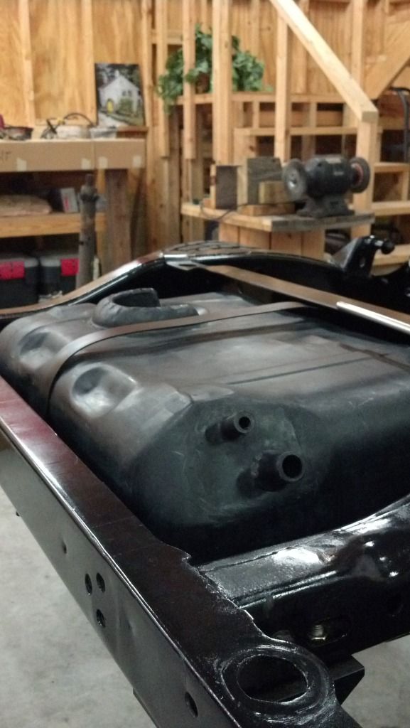

I replaced the original fuel tank with this 15 gallon poly tank years ago. Cleaned up real nice.
Think I’m just gonna scrap the sending unit and get a new one.

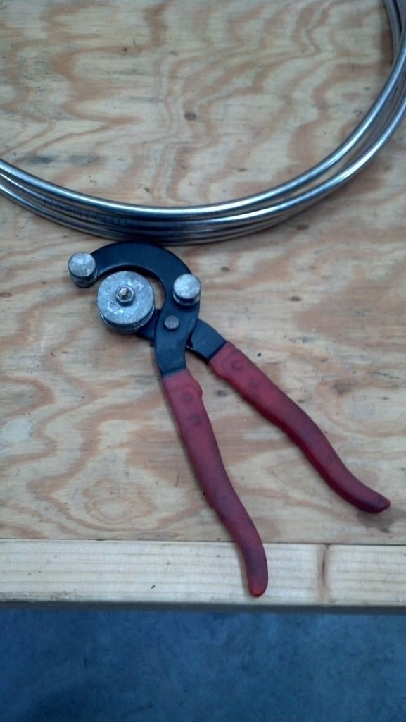

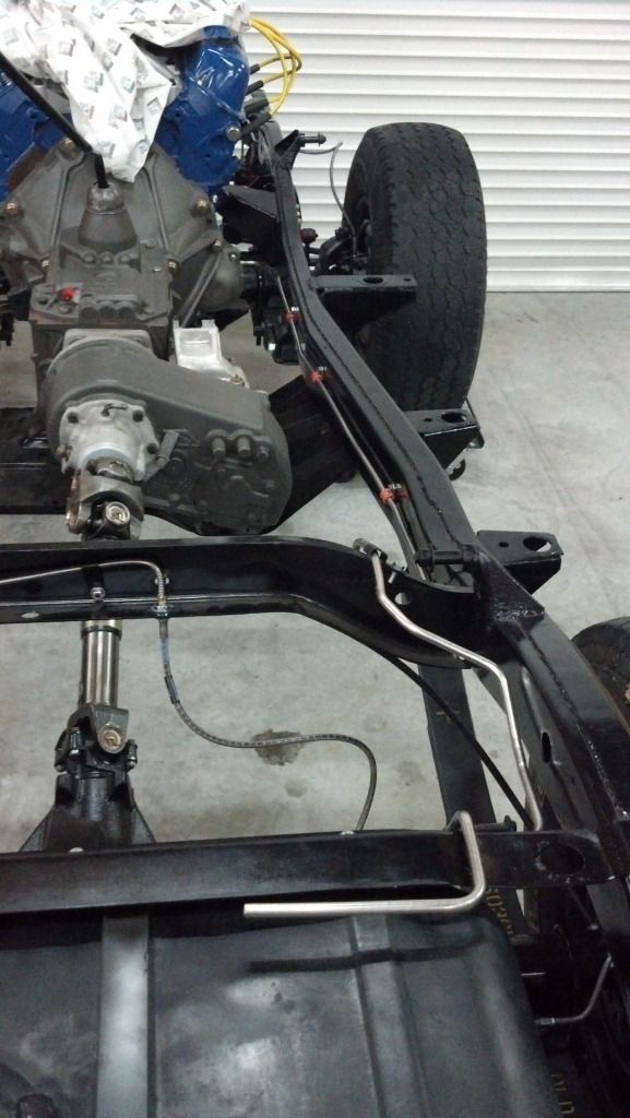

Finally got my fuel line installed. Used 3/8” ss line… very tough to bend and route. When I got started, I was thinking “this is a mistake”. But I forged on… now I have a one-piece line from the tank to the fuel pump. Notice I routed the line on the right side of the frame. I plan to run the exhaust on the left side, so I put the fuel line on the opposite side to reduce vapor lock problems. This left me with the problem of crossing to the other side of the engine to get to the fuel pump. As mentioned earlier, using the cross bar at the motor mounts worked out pretty good.
BTW, had a friend loan me some tools to work the fuel line with... in case you are planning the same thing... these will not work.
Had to pop about $56 for these to work the line... Also, forget about flaring the line without some serious tools. I think I will just double up on clamps.

Just finished fixing the "strap on the poly gas tank will not fit" problem. Ended up simply cutting the strap and lap welding it back together removing about 1.5" from the strap. Worked out great...
