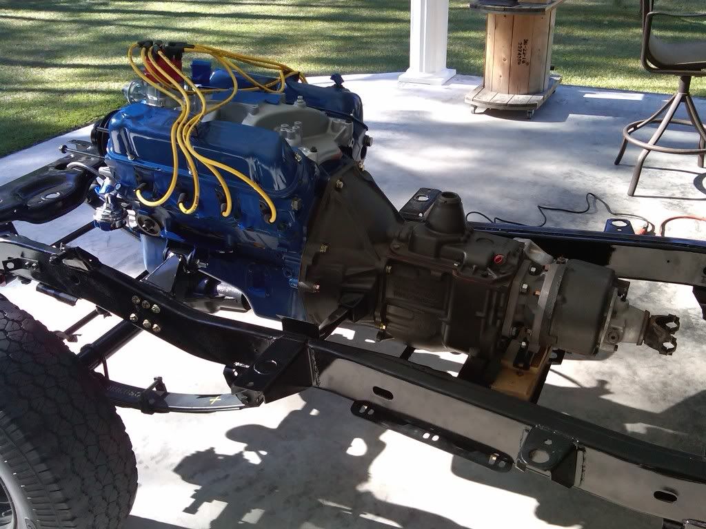

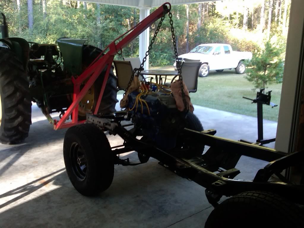

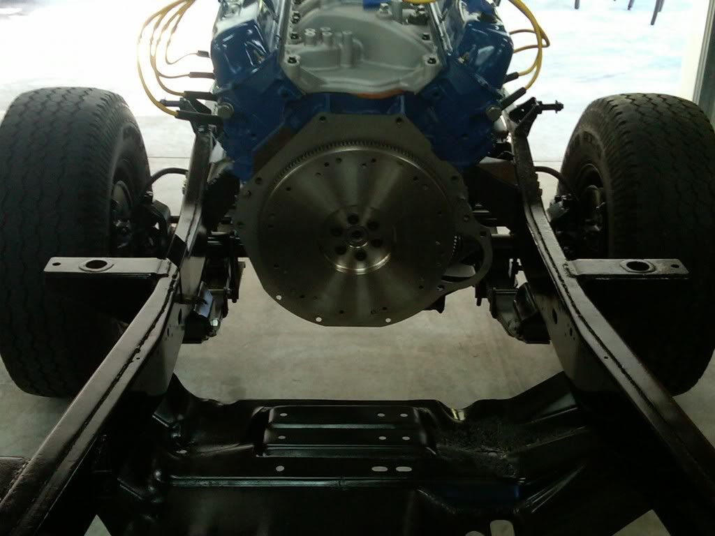

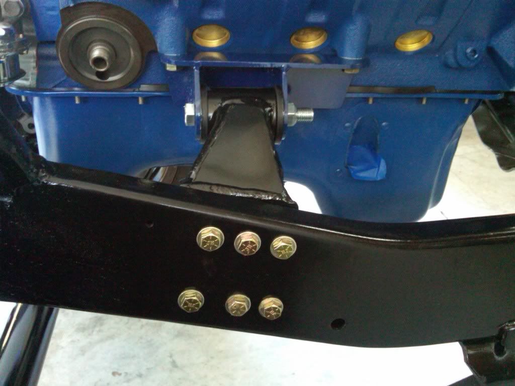

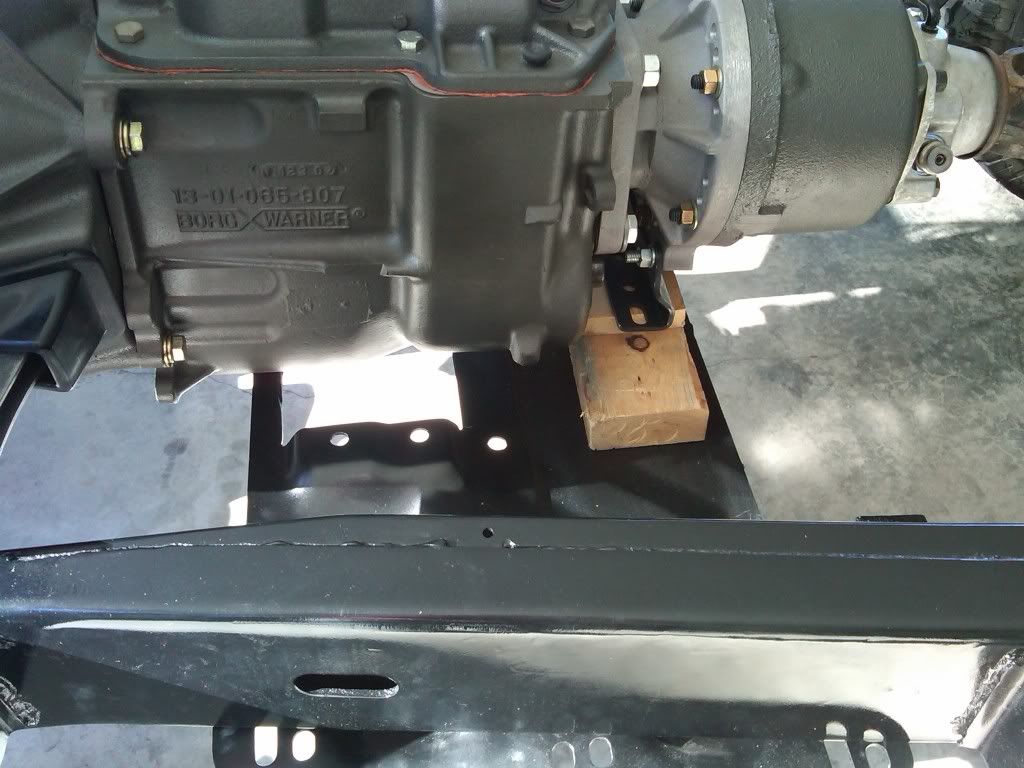

Recently came the day to start putting some things together…
Setting the engine in the frame... John Deere style...
M.O.R.E. motor mounts... expensive, but works nice.
11" flywheel install
Centerforce clutch install
Engine, tranny and transfercase installed (kinda).
Notice how I had to cut a square hole in the skid plate for the transmission to clear. Also, with the weight of the engine/tranny/transfer case combo, there was a little (not much) flex in the skip plate. I've taken the plate off and the machine shop has it now doing some reinforcement work on it. Pics when I get it back. And that brings everyone up to date where I'm at now. Thanks for watching... any and all comments welcome.
