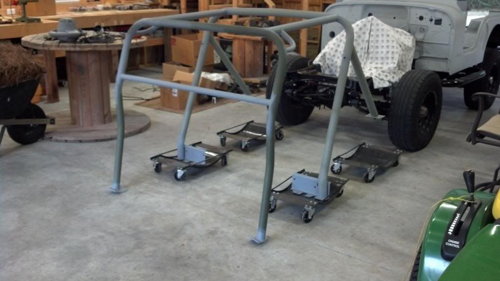

OK... finally got some more work done. Had my welding friend come over and we welded up the roll cage. I think it came out really nice. He laid down some nice weld beads and we also got the bungs in for the shoulder belt. Take a look…

Another milestone, Bob! Way to go Big Dog!! That will really transform the Jeep's appearance.

Sweet love the cage looking great.

Nice roll cage. Is it a kit, or did you bend it up?

Thanks guys. Rich, it's a kit from Extreme Custom Fabrication with added dash bar and grab handles. Nice kit.
