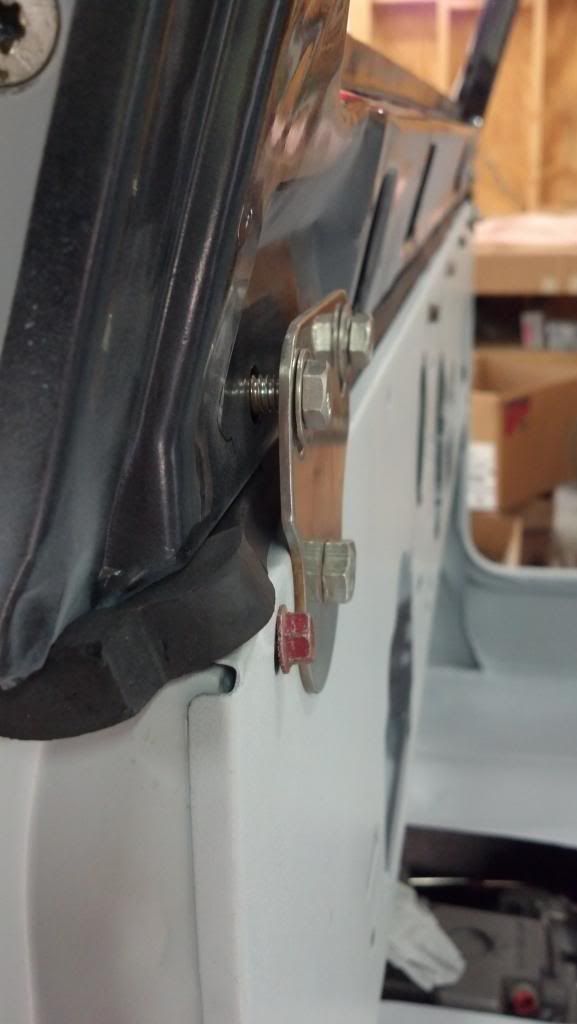

Did any of you with a new WS frame have this problem? I know it's not much to shim out, but crap... can't anything go right?

Bob I think I have an idea why things like your windshield tab doesn't fit right. If that's not stamped with the AMC tooling then someone made the tooling to do so. It takes allot of time and effort just to design that tooling and I have a feeling they get as close as they can and go with it. They are likely aware of the fitment issues but due to the cost of changing the tooling, or making it over, they leave it as is. They get away with that because they know they have little or no competition in making and selling the parts.

As far as your windshield hold down bracket, mine did the same thing and I had to shim it but I thought it was because I used a fiberglass frame. Also I wanted to mention for some small odd ball parts I needed (examples : some of the tilt steering components like the tilt lever and the horn stuff and even things like the little rubber bumpers that cushion the glove box door closing) I actually was able to get at the Chrysler Dealer.

Had the same issue with Clay's WS frame. It came from an '85 CJ7, and we had to do a fair amount of welding on it. But we had the identical issue once it was mounted. I lay it to the aftermarket glass tub?? I tightened down the bolts.

Yeah Scott, I hadn't tightened down the bolts yet so I could see how much shim I was gonna need. It will need 3/16 to 1/4 inch of shim... now, do I use washers or do I make this way more complicated that it needs to be and build a single shim out of some bar stock or aluminum...

I didn't use shims! It came together just fine. I can't tell you why, though.

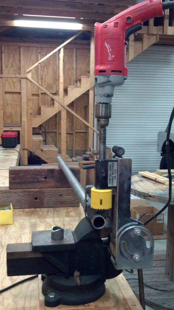

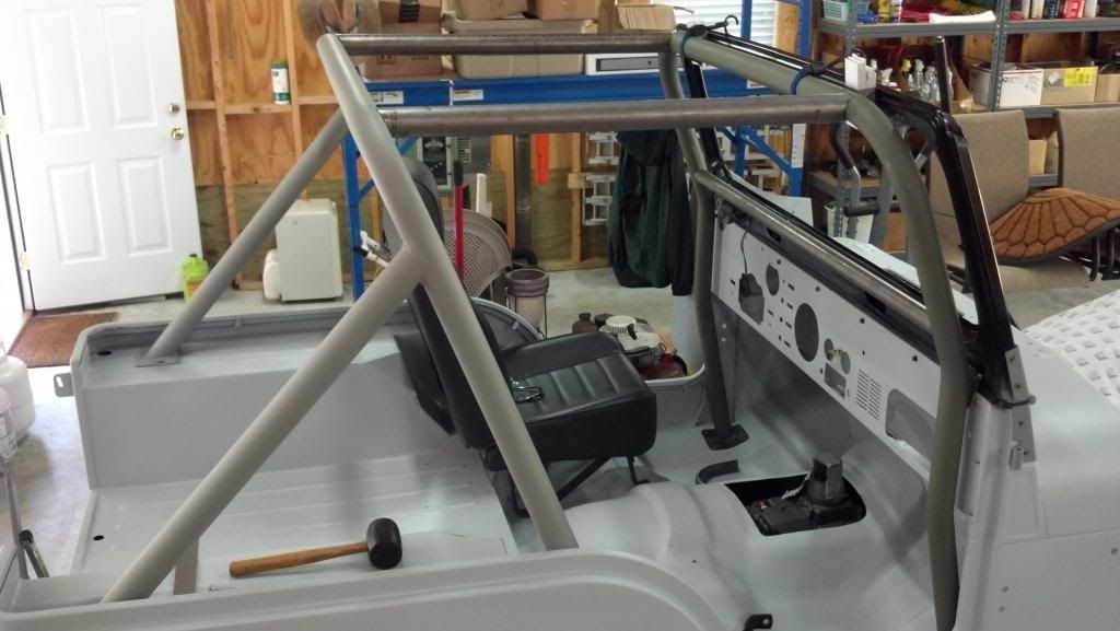

Dang... last post was in June!?! Life's been busy... lots of stuff going on and not much time for Jeep work lately.
However, I am trying to get back to it. Been working a little on the cage the last couple of weeks. Borrowed a friends tubing cutter to help with the roll bar add-on kit I got from Extreme Custom Fab. Its going pretty well so far. This week I plan to have a friend make some plates that will go on the bottom of the tub to back up the front roll cage floor plates. I'm undecided about tying the cage to the frame at this point. I know it would be the best thing to do, but I'm still trying to figure out the best way to do it. Until then, I don't want to let that further slow down the build. Also, I plan to add some bungs to the original roll bar so I can attach some shoulder belts to later.
Here's a couple of pics for ya...
Any suggestions on the cage build would be welcome.

Just got caught up on your thread commadore. What nice work and attention to detail. Thanks for sharing the windshield frame fix. I'll be there in a while.
