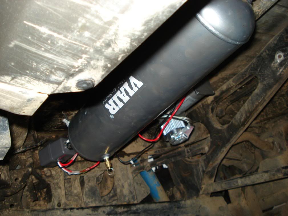

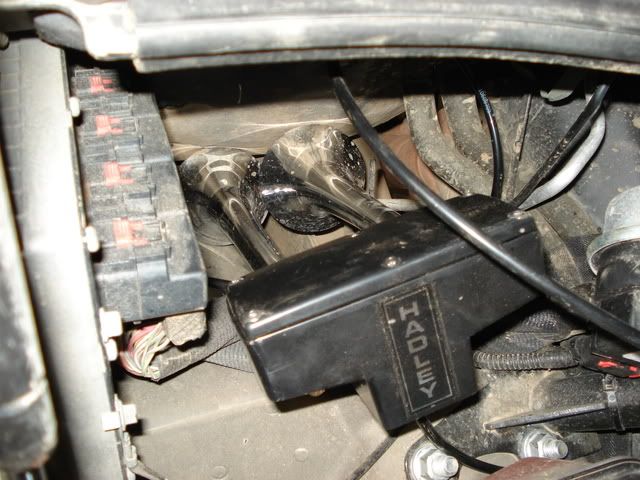

I have the Heavy Duty Viair system installed on my jeep to air up my 31x10.5 from 18psi to 40psi in about 1 minute or so, i also run a semi air horn. i tried running air tools on this kit but it drains the tank very fast which leaves me with about 5 seconds of actual tool power! sucks! my kit came with 400C air compressor, i'm thinking of running a second compressor for faster tank fill up.

Acidcold has a nice picture, and pretty tank (no offense) but it is small. That is the reason it is not very well suited for air tools. Instead of a 2nd compressor, put more air storage in the system.
