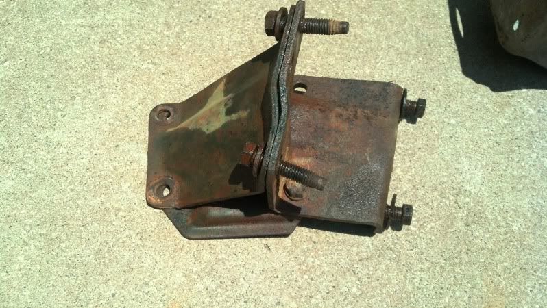

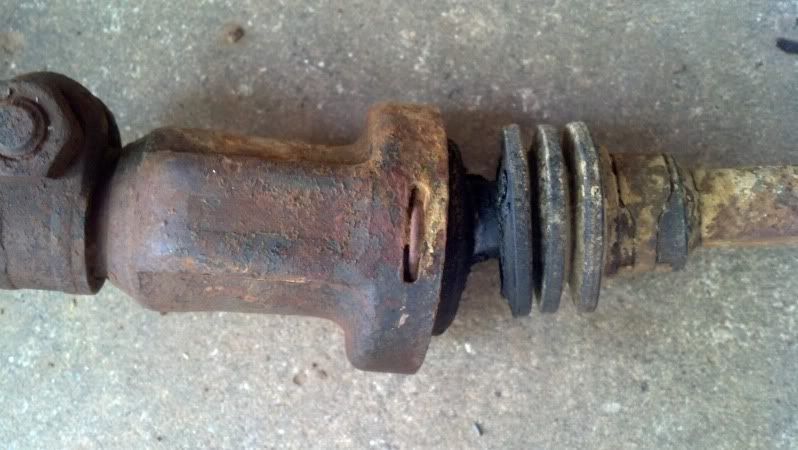

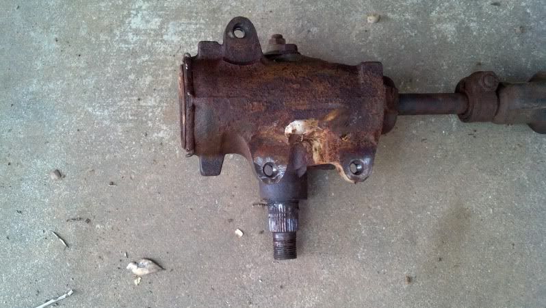

Steering Box/Shaft Removal

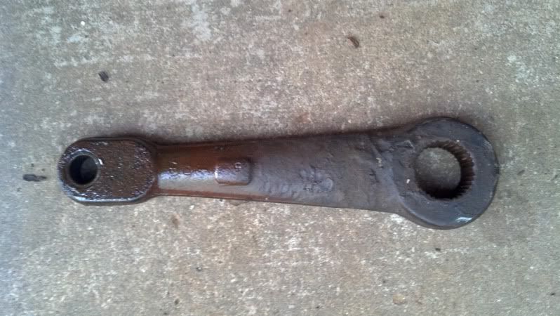

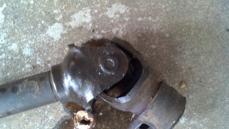

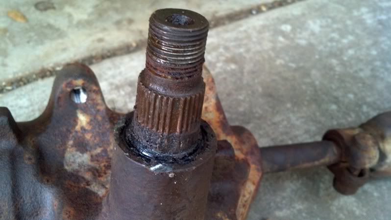

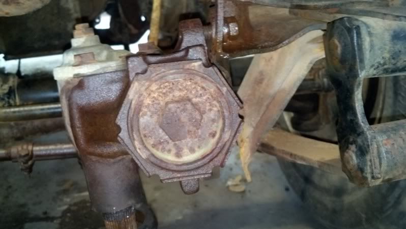

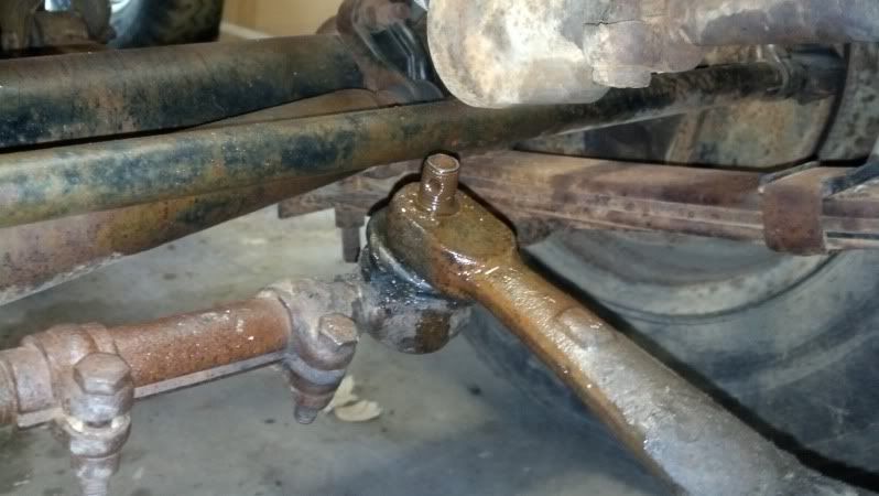

Put this off because I was dreading the Pitman arm issues I have read about, but decided to today.
Loosening the brackets...
Couple hours later with the pickling fork...and a progressively bigger hammer...
Now to bash this side
Finally,
I'll try to clean up and paint the bracket.

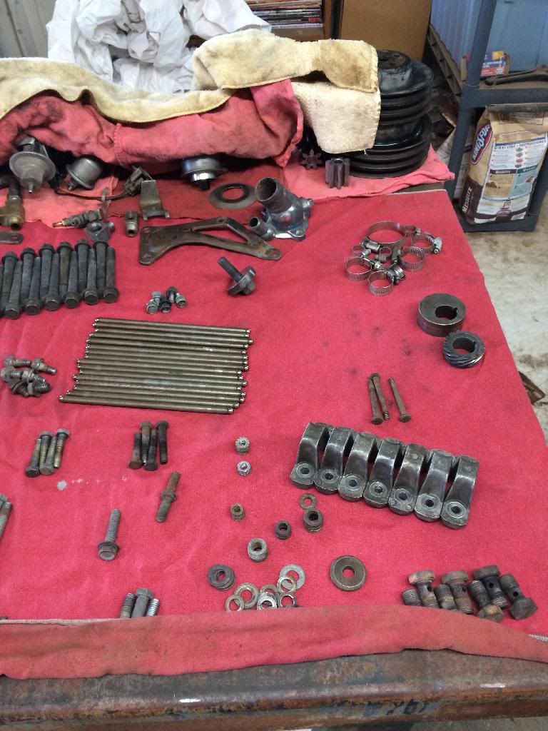

All of the small parts from the 360 are being washed or have been and are laid out for re-assembly. A few new items have been ordered like a timing chain kit and a few more will probably be needed.

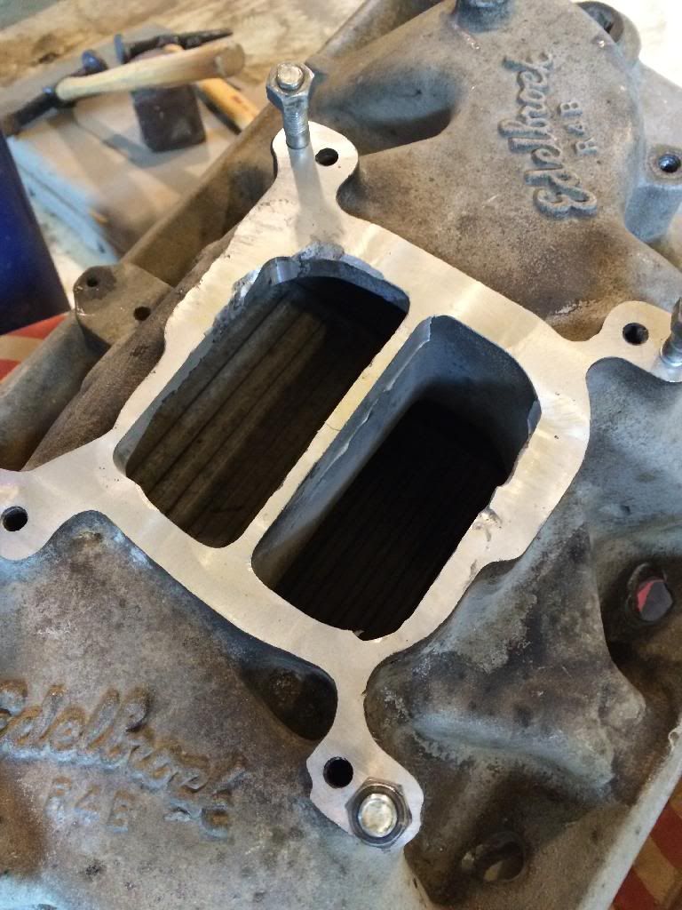

The Edelbrock R4B manifold that was badly gouged (see earlier pics) has been welded up by a pro and then milled, he is fairly confident it will seal.
Does anyone have experience or thoughts about this manifold?

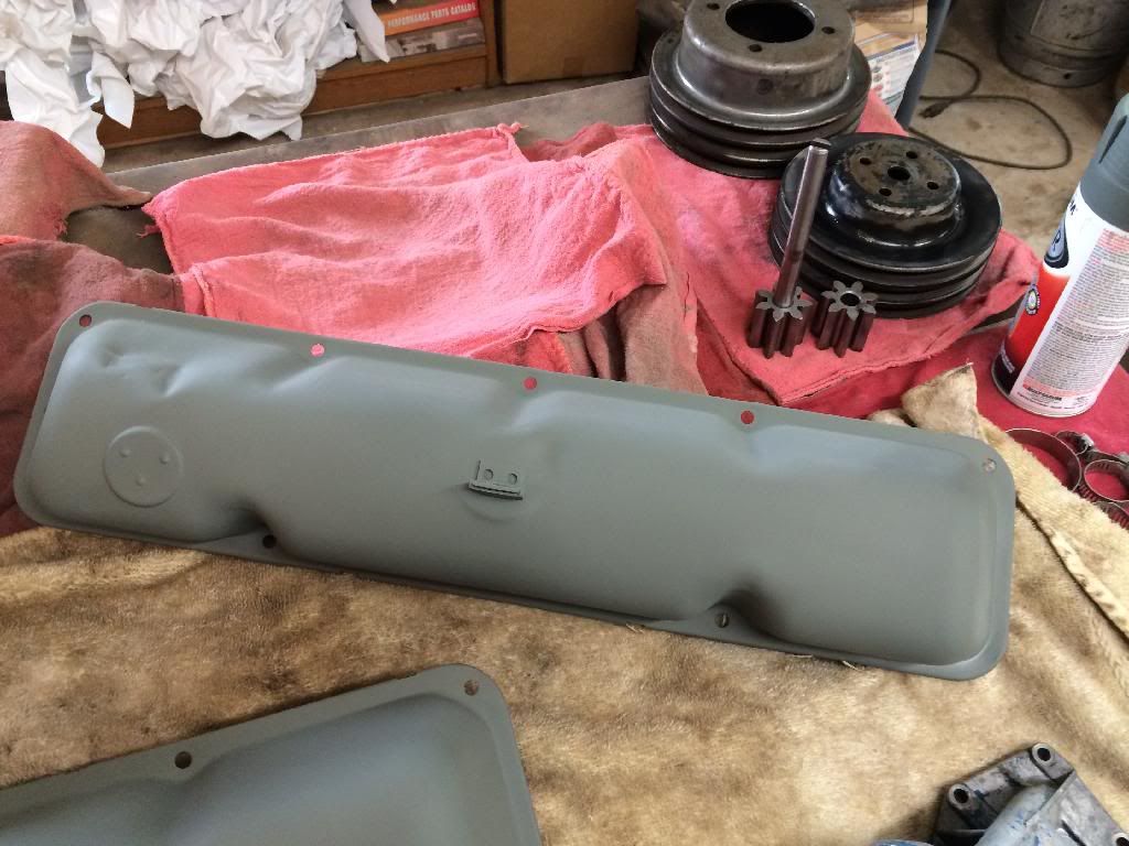

I used a friends sandblast booth for some small parts including the valve covers and oil pan...we'll see what they look like with AMC blue.

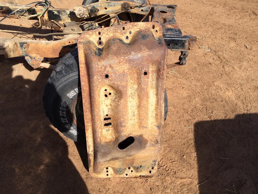

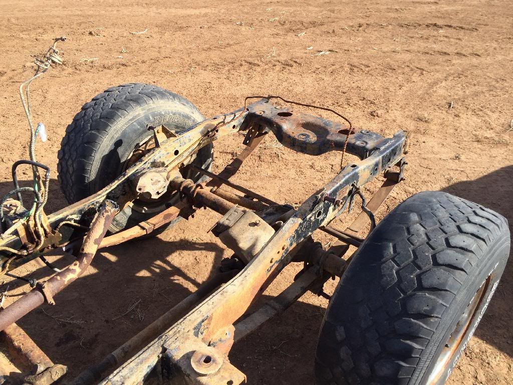

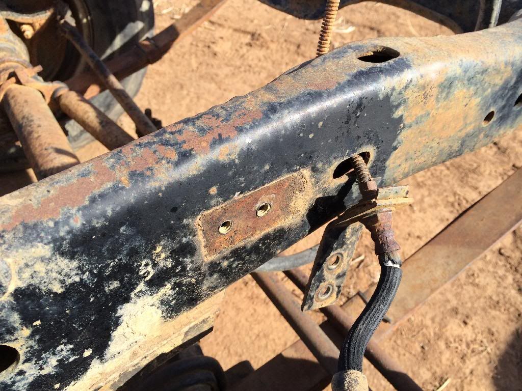

A little work over the weekend. Basically stripping the frame as best I could with just a couple of snapped bolts, should be ready for a power wash when the weather warms up.

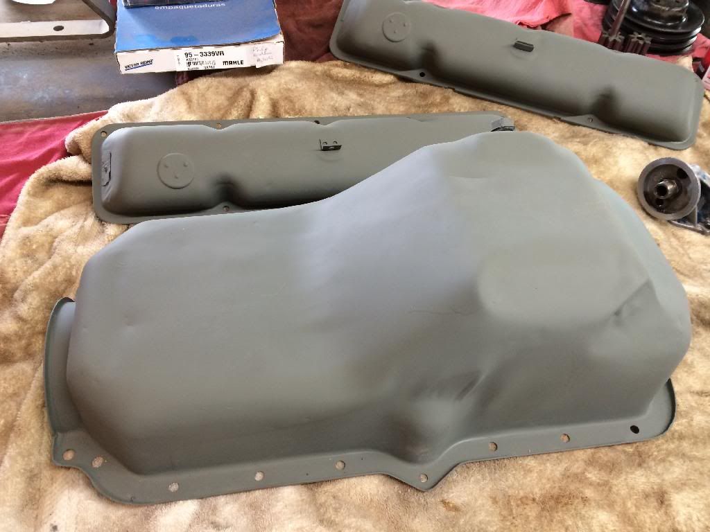

Primed the valve covers and oil pan...
Hoping to hit them with some AMC blue this week.

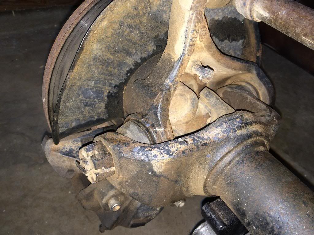

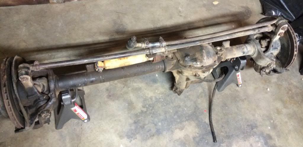

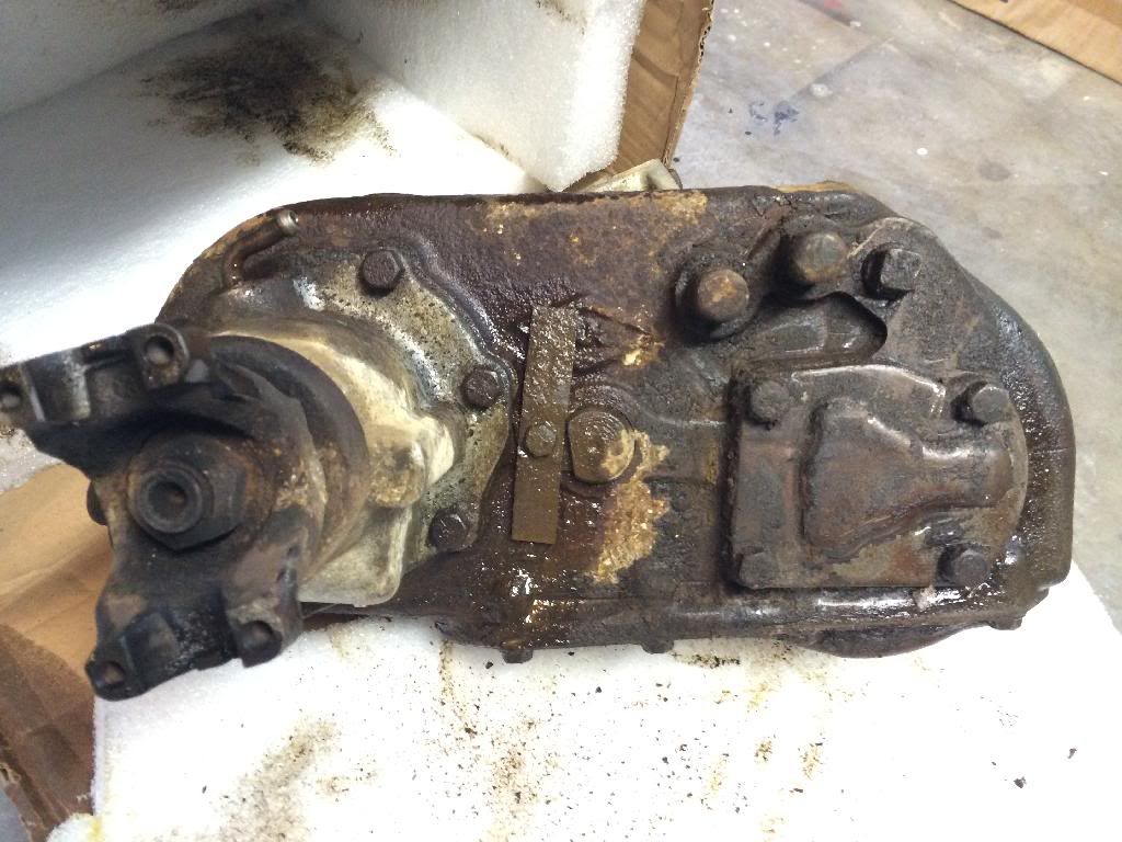

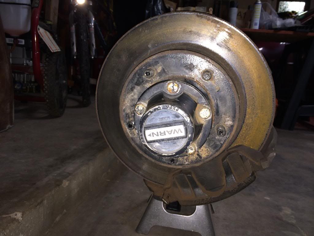

Picked up a wide track Dana 30...

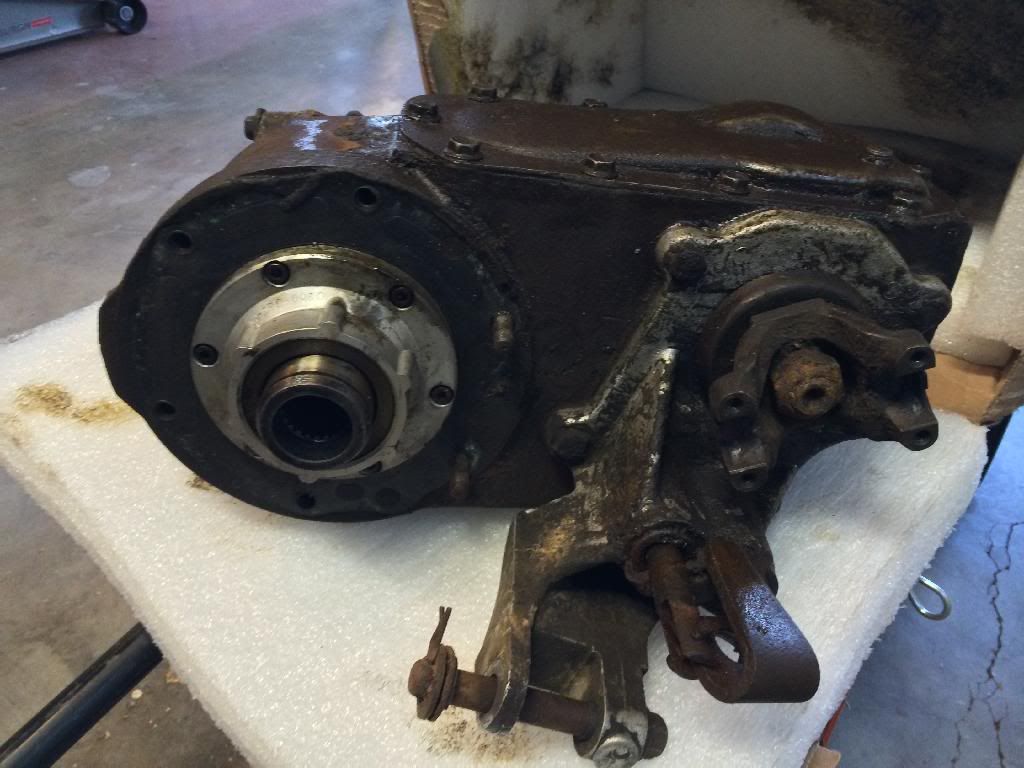

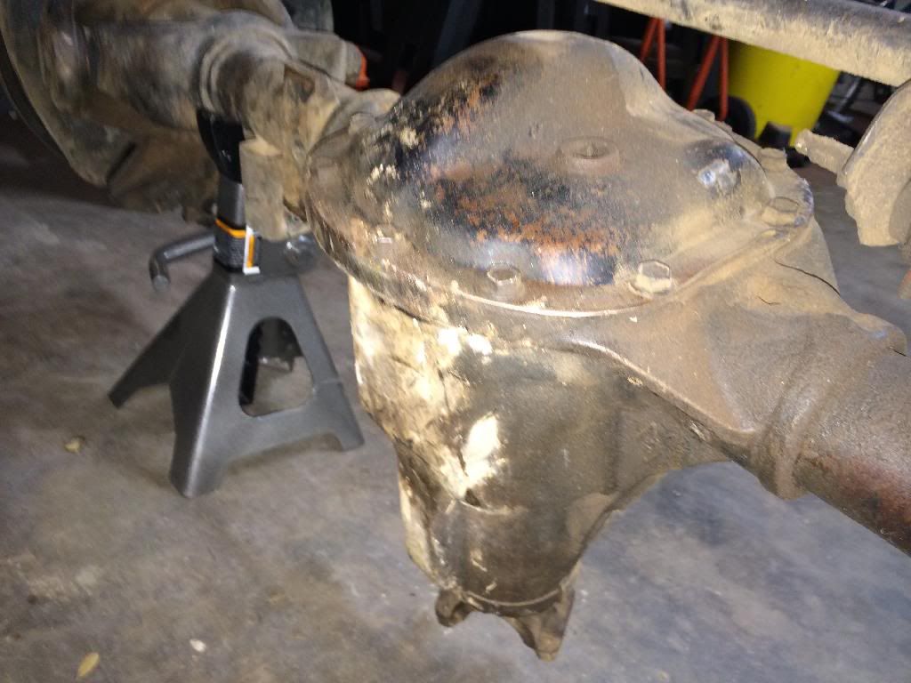

And a Dana 300
P.O. believes the gearing in the front is 3.07 but isn't sure. Came out of an '84 CJ-7.
Both need to be cleaned up and probably more.
