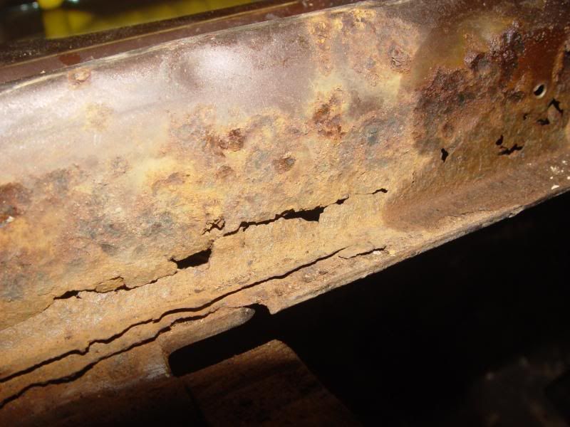

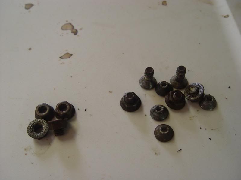

Independence Day Attack
On the windshield bolts... A combo of drill, hammer, punch, easy out etc...
Some came willingly and intact...
Others not so much:
But they all came out and the windshield is off...
The windshield frame doesn't look good, I'm thinking it has to be replaced but I'd like some second opinions here...
Good job on the WS bolts. And the cowl looks good. You CAN repair that WS frame if you want to. I have done two now, and they came out fine. Our rust issues were identical to yours, plus a couple places on the lip where the glass seal attaches. We cut out the rusted portions and welded in new metal. We used 18ga steel. It was fairly easy to shape and bend. My son and I had never done anything like that before, and I was pleased. The big question is how long will it last? I don't know that, but I hope for a few years.
And awesome news on the engine!
Thanks for the input, I've heard horror stories about the aftermarket ones, I'd like to try and fix it.
