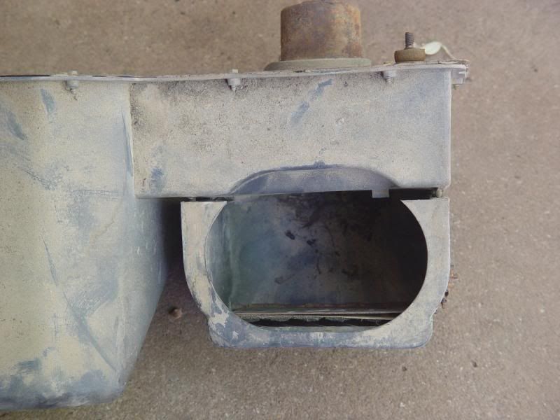

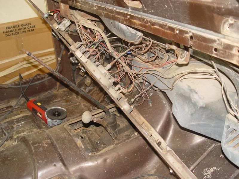

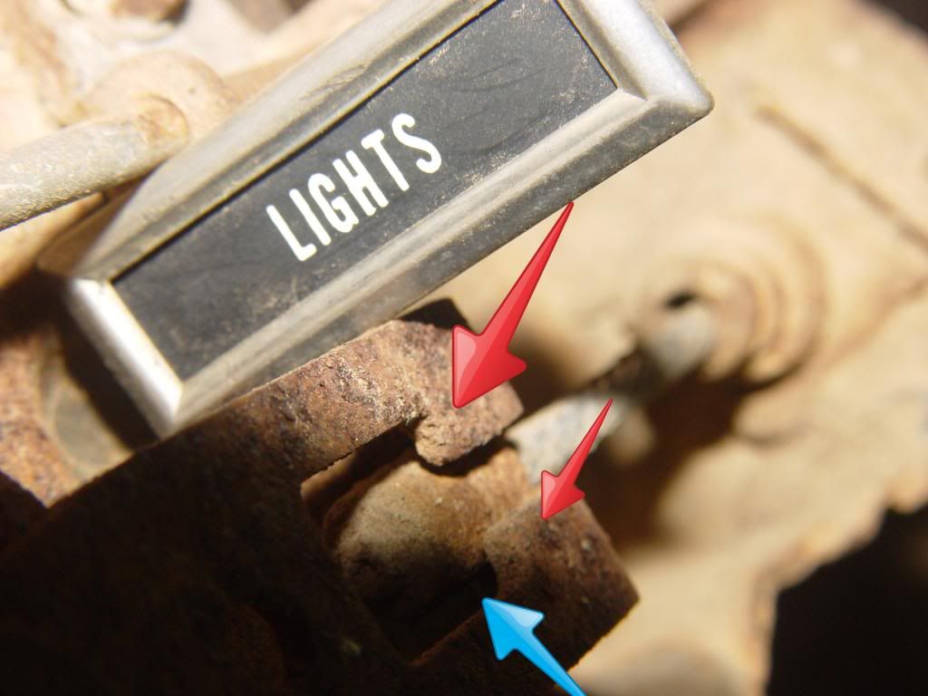

finally got a few things done...the stubborn single bolt holding the dash went away...

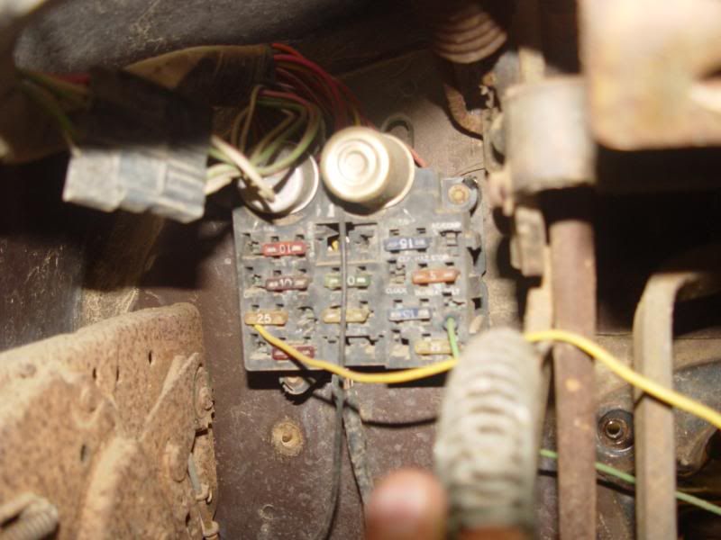

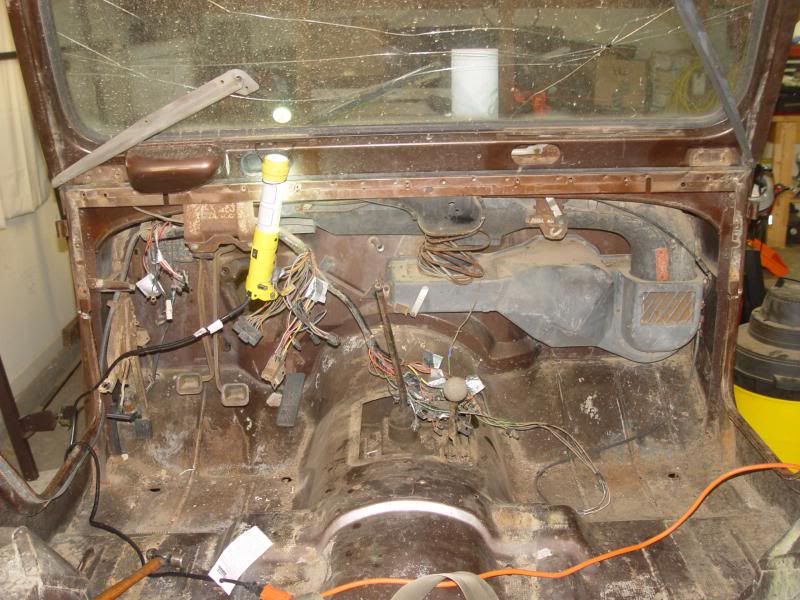

So I started labeling wires...every plug or connector that I could find...

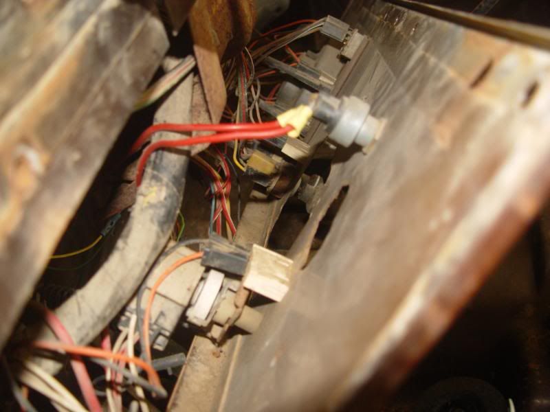

The fuse panel (?), had some odd wiring, things just shoved into the panel, not necessarily with a fuse...

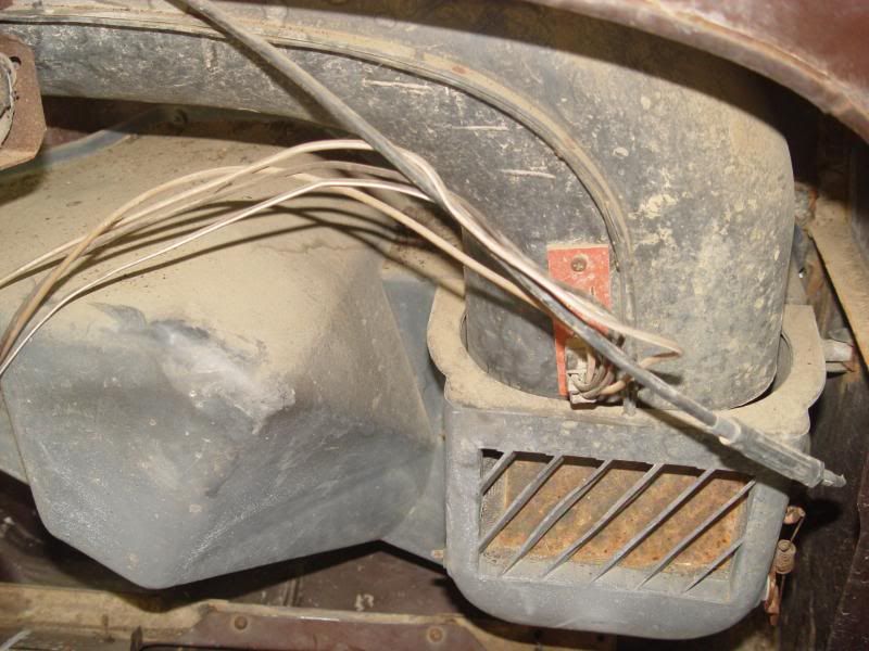

What's left of the defrost/defog duct...

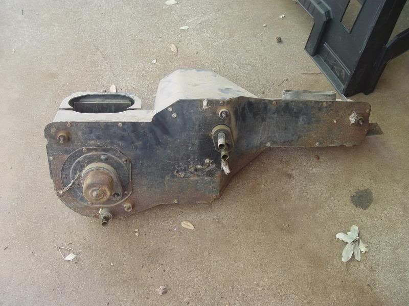

Various other pieces of the heater box..
Removed...

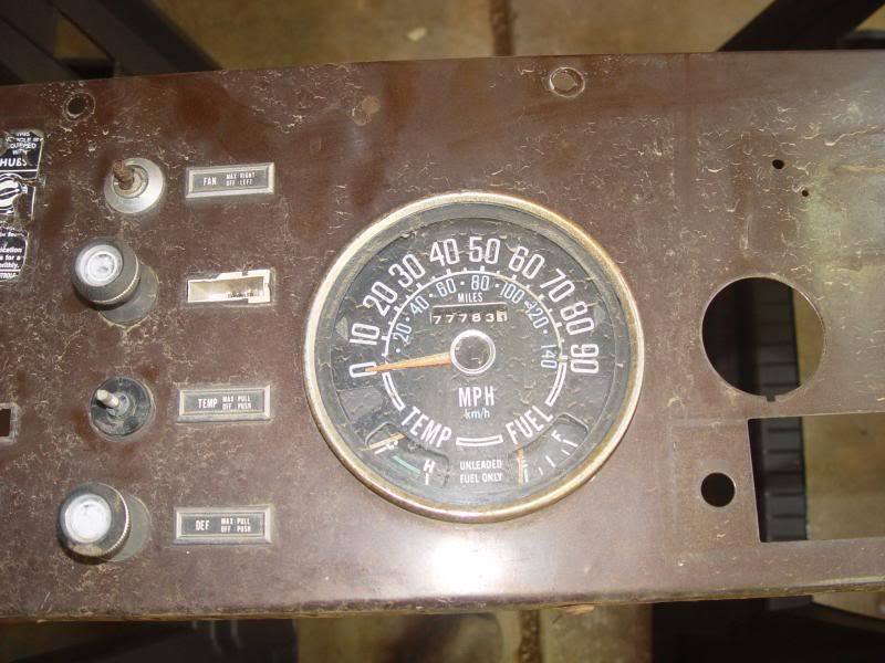

The dash finally out..
Yea!
Took a pretty good whack to get this unstuck...
Some sort of critter lived in here...
Some of the mess I was digging out of the top vent area on the hood near the windshield...

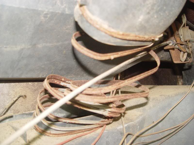

For removing the E Brake assembly. Everything is unbolted, this is all that is holding it in. I cannot budge the little "bead" through the linkage up at all to allow it to come out of the space...(sorry don't know the terms ), I only need about 1/2 inch of movement of the "bead" (blue arrow) in the linkage to clear the lips (red arrows) of the bracket and the cable will clear. It is completely frozen. Other than cutting it what can I do to get it moving enough to get it off of there?
Hopefully in the evenings this week I will remove the master cylinder, the old seatbelts which I can't seem to break loose, the pedal assemblies, the rest of the heater/duct stuff and do another power wash. Also have to remove the nasty decals on the side panels as well.
Editorials are welcome.

Under the body before the rear axle you should see the set up below. Its the e-brake tensioner. If you back off the two nuts on the threaded portion you should be able to move the cable. However, judging by the rust on other parts, these may be frozen up too. In that case you will probably want to cut the cable. The e-brake cable is something you will want to replace in your rebuild.
Thanks I'll give it a try.
I went under tonight and followed your suggestion. Mine actually had a lot of slack and the bracket was dangling, I took from that it is cemented in with mud and rust along the line so I cut it, there was no way it was reusable for anything.
