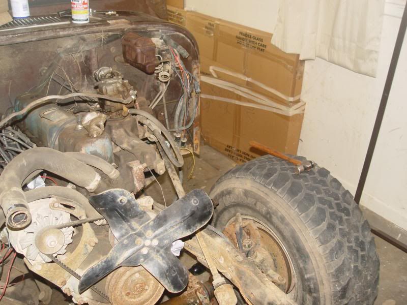

I have had difficulty formulating a plan...I do a lot of sitting and staring at it, waiting on things to magically happen. It will be a largely a street/weekend vehicle. I would like to occasionally run it through mud, though we have no moisture where I live. I have been rock-crawling in Hot Springs, AR with my same high school friend in his CJ7 designed for it... I have a mangled L4-5 to show for it and amazement that more isn't broken, along with the vehicles I saw. Rock crawling is not in my future. I want it to have decent street manners but still be a CJ, so I know it won't be ideal on the road.
It came with: 258 I6, Dana 30 front, AMC 20 rear, T150, and I believe a Dana 20 transfer case. The rust doesn't appear to be bad, there is a maybe 1 x 2" area to patch, the driver's side fender may have to be replaced. The tub looks pretty solid so far, no obvious patching needed. Lots of surface rust to sand. The frame appears straight. It is a hideous brown which will be replaced by something truly obnoxious to be determined.
I have picked up a 360, (chickened out on an available 401) still mulling and trying to understand transmission issues and choices (see my cry for help in the Drivetrain section), the existing one may be usable but has some sort of issue with first gear. I have read with great interest the thread of the Pig rebuild, it overwhelmed me. I can however point at the finished picture Matt posted and babble "want that..."
I would like to re-do everything, but I don't think that will be practical. One piece axels may have to wait, the ideal transmission may have to wait, other cool bells and whistles may have to wait. I'd like to get the 360 rebuilt, the transmission functional, the tub and pieces repaired and painted, get it driveable and go from there. I expect to accomplish this by 2020 in time for my son to carry on family tradition and take it away from me.
Maybe this isn't such a good idea
It followed me home I swear
Important info...wish I knew what it meant

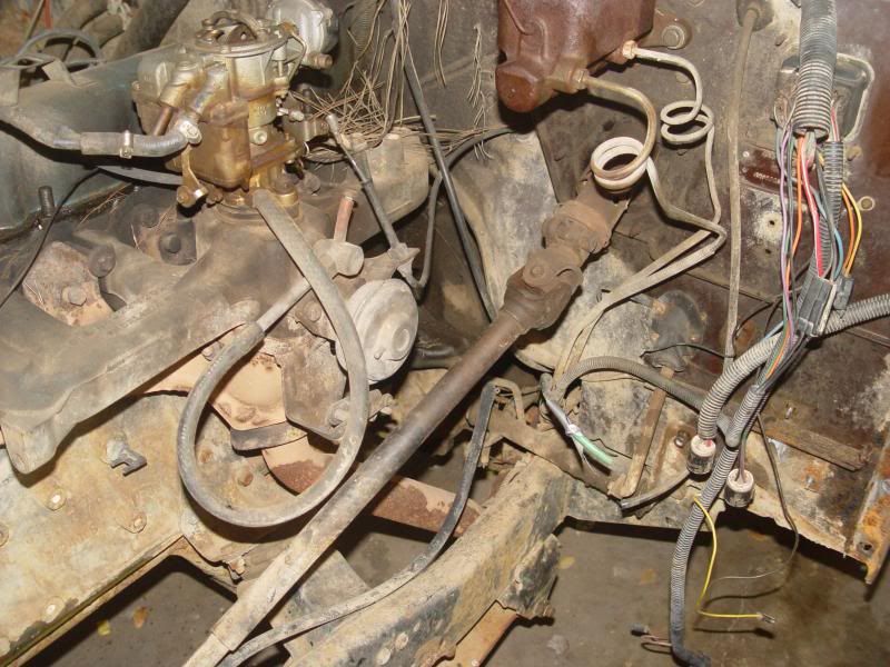

Just start unbolting things they said...
I hope it doesn't look like this in 2015
I'm certifiably ignorant, but this doesn't look too bad does it?

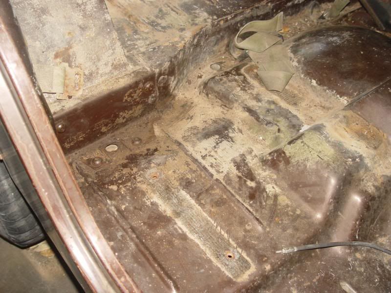

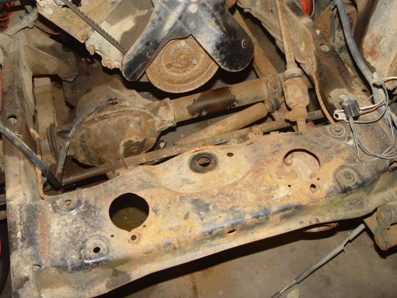

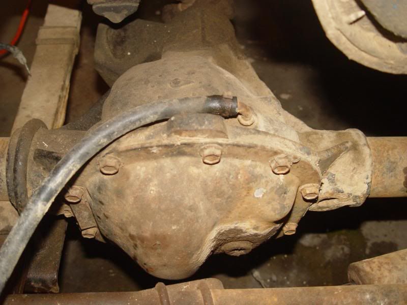

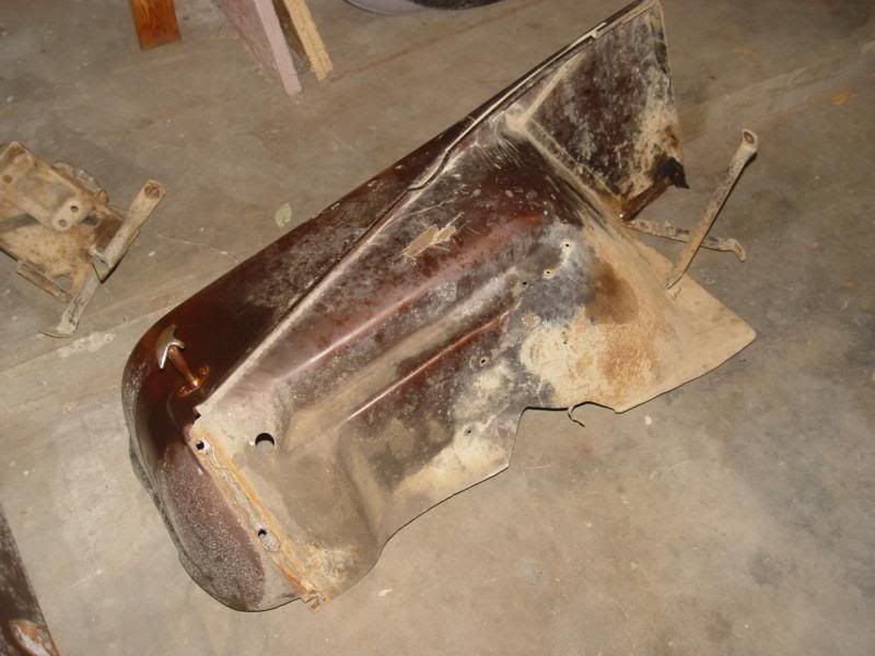

I'm told this is easily patchable... of course in the context of people with skills, tools, knowledge etc..
How about this one? Kinda folded up under there..
Was told this looked pretty good..
Maybe not fixable?
Passenger floor...

Defiantly subscribed to your thread and ya that will be an easy patch for some one that can weld the fender tho that might take a ton if work I'd prob buy a new one

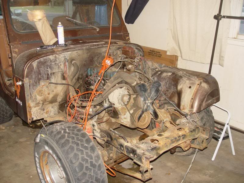

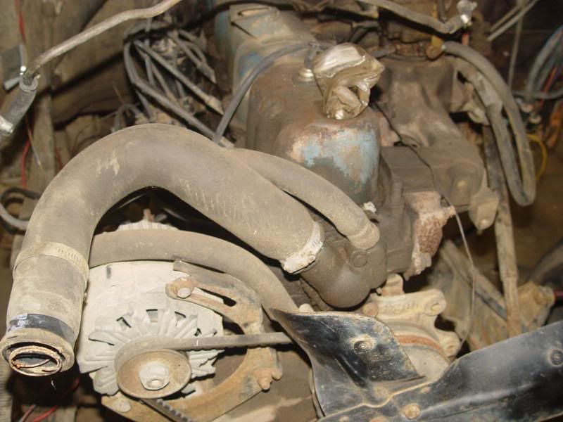

The question came out the door into the garage, "do you know what you are doing?" I declined to answer...

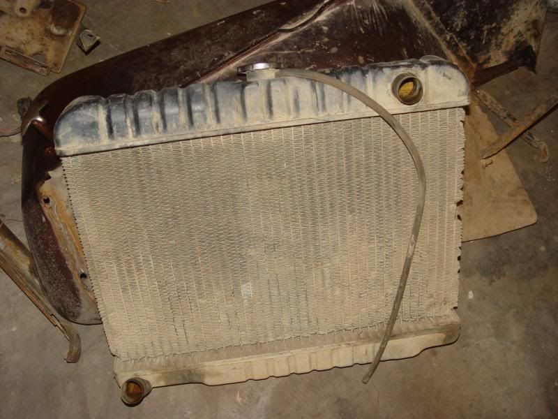

Is this a normal looking 258 radiator? Why does the core or whatever that is, not go back all the way to the edge of the frame?
Not mangled...
I guess this is coming off next...
I have accomplished my goal of the Jeep not looking the way it did a post or two above in 2015.

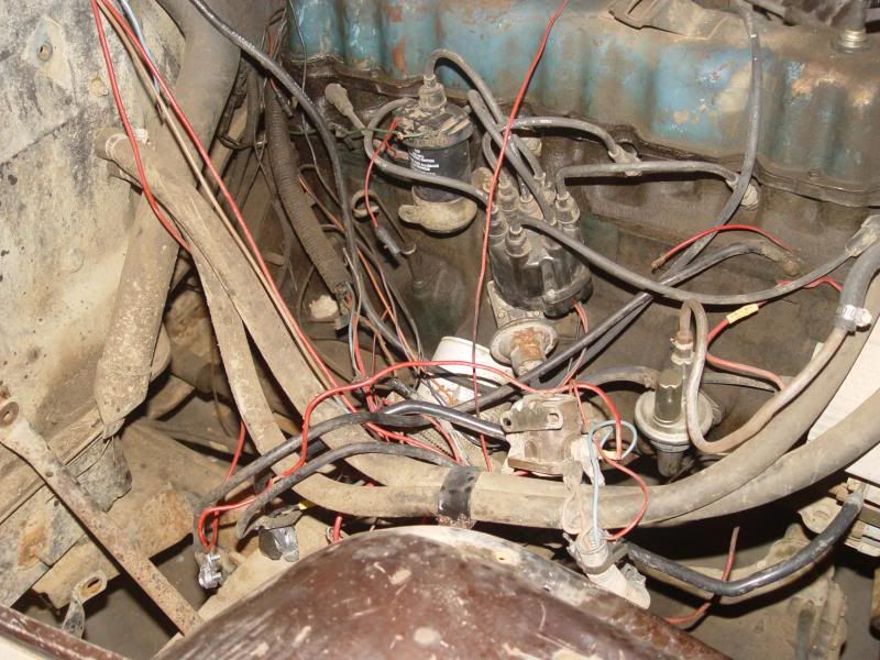

Tried to label some wires, probably not enough, the PO's wiring is curious.

Finally...I didn't think it looked horrible under the bracket, but what do I know. Does it look decent enough? I expected worse.

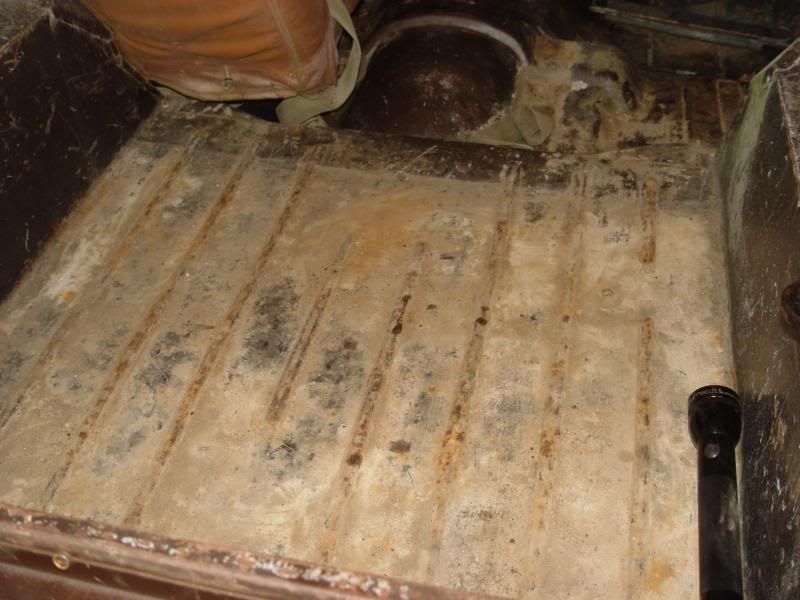

The back tub, which was under a rubber mat for who knows how long. No holes or thin spots I can find.
My first assistant supervising the spare tire ordeal
Got the passenger seat out without much trouble. No holes under it.

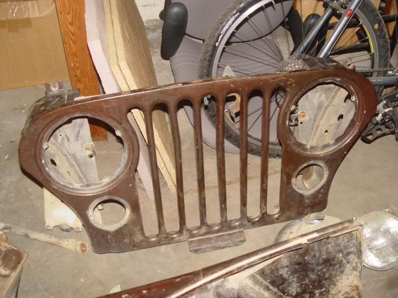

How does the plug below come out?
