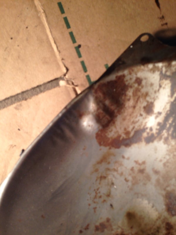

PROBLEM SOLVED ..... I think.
After all of the discussion above and some extensive digging on the internet, I went to the garage with a full checklist of things to check.
I pulled the inspection plate, and dust cover.
Saw no evidence of contact anywhere. I noticed the transmission side of the ring gear teeth had a bevel on them, but it seemed too uniform not to be from the factory.
The inspection did cover had a dent in it about the size of an egg, approximately 1/8 inch; deep. But no signs of contact on the cover OR the torque converter.

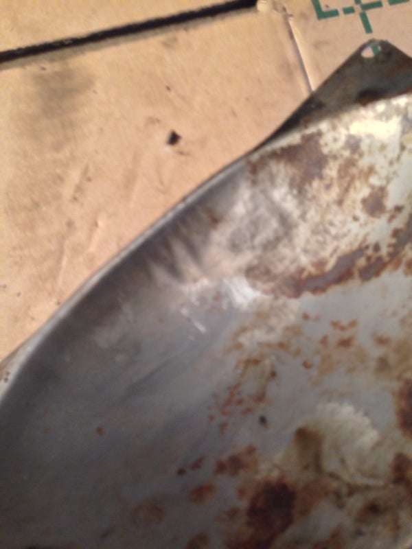

Just to be sure, I worked out the dent on a block of wood.
