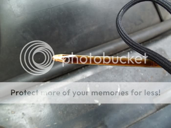

i have this problem, its a amc 150, i change the head gasket but the problems continued any comments??? i saving for a 4.0
block? head cracked? normal??
thanks all

Condensation happens in an engine every time you shut it down or start it up from the temperature changes. Engines have a thermostat in them to make sure they warm up reasonably fast so this condensation will evaporate from heat. If the t-stat isn't working or you just do lots of short drives, the condensation doesn't burn off and can cause that milky stuff. Short drives are considered 'severe service' as far as oil changes are concerned.
OK. only drive my jeep for 15 minutes from home to job, the oil its changed 1 month ago, the last year i run my engine without thermostat but in december 2010 use a thermostat of 160 f and that problem beginng.
what need to do?
thanks and sorry for my poor english

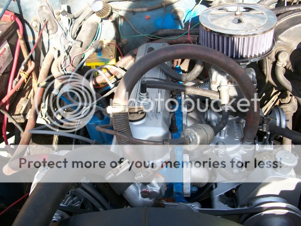

Do you have a pcv valve hooked up and are it's hoses and breather element in good condition?

OK this a pic
the PVC its plug in T with the power booster and conect to carburetor base.

Originally Posted by INKUBUS View Post
OK this a pic
Just a FYI, your gas filter is in upside down which usually causes really long cold starts, you get one vroom, then you have to crank and crank and crank... Acts like a flood, but with the return line lower than the carb line, the gas all siphons out of the line back to the tank when it sits, vaporlocking it.
The filter needs to sit level with the return coming off the top.
I don't think your milkshake 'issue' is an issue.
