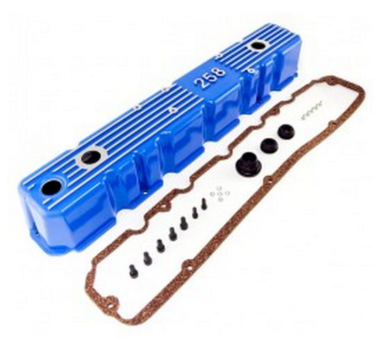

A word of caution for those of you in the market for a new cast aluminum valve cover. Do not buy anone Omix-ada brand one, at least not without a backup cover ready to go or time to find .
I purchased a blue cast aluminum cover Omix#17401.11 that they claim will fit the following as a "Direct OE Replacement".
1981-1983 Jeep CJ5
1981-1986 Jeep CJ7
1981-1986 Jeep CJ8 (Scrambler)
1987 Jeep Wrangler
I got it from Morris 4x4, which is the first time I ever bought anything from them, $150 +free shipping. I started the swap on a Friday night, figuring I could button it up on Saturday, which included replacing a rocker arm set to quiet a loose pair.
At first glance it looked pretty good, but when I started the swap and went to clean the new one, I found chipping edges of paint inside and out. As well as some casting slag and two tiny webs from the pour. So not a big deal, I cleaned it all out and sprayed it clean. After all, it was from Omix. Then I discovered where some of the cleaner (CRC Electra-Clean) bled out the topside holes and left discolored streaks in it. It's still intact, it didn't soften it or bubble it, just stained it. I thought it was a baked on paint like powder coat. So I'm even more disappointed but it's still a minor thing (but worth warning you off).
Now it's time to dry fit the cover. Starting with the rear bolt first since it's the most difficult to access and then the rest, I discovered 2 of the bolt holes didn't line up with the head. Now that's a major problem! But again, it is from Omix! I guess some hole grinding is in the future, but I'm sure as h ell gonna let them know my opinion of it.
So I sent an email back to the salesman I ordered it from letting him know my disappointment in the product they sell. Adding that it wasn't personal and I wasn't venting AT him, just letting them know in general about it's poor quality. He fowarded the email to a lady at customer care whom then called me om Tuesday and said she'd contact the manf. to make sure that would be under warranty (like there should be any doubt) for a replacement. She also wanted some pics, which I sent to her. The manf. responded to her and wanted some measurements of how much they were off (they had the pics). This is where I knew they were clueless! She called again and I told her there was no way I could accurately give her those, plus they should already have the correct dimensions since they make this product to sell and fit these engines. So she passed that on to them.
So now a guy from Omix called me. I told him I was not a machine shop with the tools needed to supply that and what did it matter, the holes were off. When I mentioned looking at the drawings he said we don't have them or a 258 head. They get these from several sources. And did I mention that the box had a tiny "Made in Tiawan" sticker on it? He said the whole lot could be off so he didn't want to give me another one of the same. I gave him a date from the box that he said he could tell what lot they were. I said just send me another one, if it's off too then I'll just oblong the holes to work. He said he didn't recommend that. So he said he'd go look and call me back.
He didn't call back so the next day I called him. He said all the ones they have are from the same lot so he didn't want to take that chance. He would tell Morris to refund my money. She called me shortly after and said she issued a credit back to me. I said what about an RMA number to return this one, and I'm not paying for it. She said to keep the cover. So for my troubles I got a new filler cap from it, but the grommets for the other holes didn't fit.

Typical Omix crap. Good on Morris for handling it well.
There should be no problem with reaming out a couple of holes, unless they are way off. Perhaps you can use a small washer on those holes to prevent warping.
Don't over-torque the bolts. 1/4 turn past hand tight is usually good enough.

IIRC, I actually opened up ALL the holes on my valve cover when I swapped it out. It made installation much easier. I also ended up using the spanner type valve cover hold downs w/ bolts (that put pressure further done the cover, an inch or so away on either side, as opposed to only on the bolt hole)
I went with a stud on the back bolt (firewall) partially because it was much easier to install, and partially because that was hole for some reason was tapped all the way to the water jacket, so a stud let me seal it.

Looks like the casting might be OK but the holes were not centered on the flat.
Bummer.

This is why I would never buy a PAINTED cover.
I have the same cover and it has been fine for 13 years. Maybe quality control has suffered since (changing of the times) but mine is a nice, solid, well made piece. I too remember slightly enlarging some of the holes and tapping them all to be the same size as the largest on the head already; which made removing for future repairs easier. I also used Allen Head bolts for easier grip on the bolts.
FYI, Taiwan doesn't necessarily make it a bad product. Many USA companies have their main corporations is various countries. It's the quality control that needs to be addressed from that manufacturer and the product lot. I know Harley Davidson; which is "AMERICAN MADE", has a main corporate headquarters in Korea. This is why you see "Made in Korea" inside their high end leather clothing. Korea is a main Import/Exporter of high end leathers from Italy, India and others.
In other words, these were never really a direct fit. The hole pattern was probably obtained from the cheap plastic valve covers that were installed from factory production. Those flexed and or warped. Why plastic, I could not answer that. Jeep seemed to cut corners in many areas that could have made these vehicles much easier on the repair bucket list.
FOOTNOTE: DO NOT USED THE SUPPLIED CORK GASKET. Get the FELPRO Rubber Composite one. The cork tends to squeeze out, making the cork thinner in certain areas if you over tighten it.

I always try to steer clear of omix stuff, even crown for that matter. But as you guys know, sometimes it's your only choice. That was the case with this cover. My current one that I've had for decades is a Clifford black cast aluminum but it has a lip around most of it's mounting flange. I was looking for a flat bottom cover for more mating surface and the blue color was an added plus, in my case.
So yes, I got a free cover that I can modify to make work. But I think I'll repaint it first and use it on my next engine. And I always use the FelPro laminated one but it needed trimmed to fit around the lip in some places so it could lie flat. That's why I wanted a flat bottom cover.

No, theres nothing wrong with it except, it's got a partial lip around 3/4 of it and the gaskets don't fit lengthwise. You have to trim the ends in spots as well as the 3 bumps on the straight side, so that the gasket will lie flat. I don't know if they still make them like that or not, as I bought mine in the mid 80's.
It's back on the Jeep, for the second time in as many weeks! I tried the gasket dry, as some guys have had success like that (as per FelPro instr.) I did it first trimmed to the cover, then bought another and ground down the lip on the cover where needed. Neither was leak free. So I went back to the 'ol tried and (mostly) true combo, gasket and rtv silicone.

Tried that route last year. Wouldn't recommend that stuff to anyone unless it's permanent. Without a gasket you can't get it even and it has to be put on a little thicker than a gasket in order to take up the space before the bolts bottom out. So that's hit or miss. But the worst part is if it needs to be removed! I truly was concerned that I may break the cast aluminum while prying the cover off. That stuff is like super glue on steroids. I had to use multiple pry bars to get that cover back off.
The even spacing issue is why I looked into the FelPro PermaDry Blue gasket. It has metal spacers molded in at the bolt holes. Unfortunately those are for Wrangler era inlines that have a different head with bolt spacing like the 4.0 . FelPro list's them for 86 (258's) but they must have meant late 86 which would have been the first generation of Chryslers migration towards the 4.0 with the version they put in the first Wrangler models that year.

The one you want is the "Fel-Pro VS 50244 R". It is NOT the blue one but it is a rubber composite material that has the metal within. I just bought one for next month's project.
