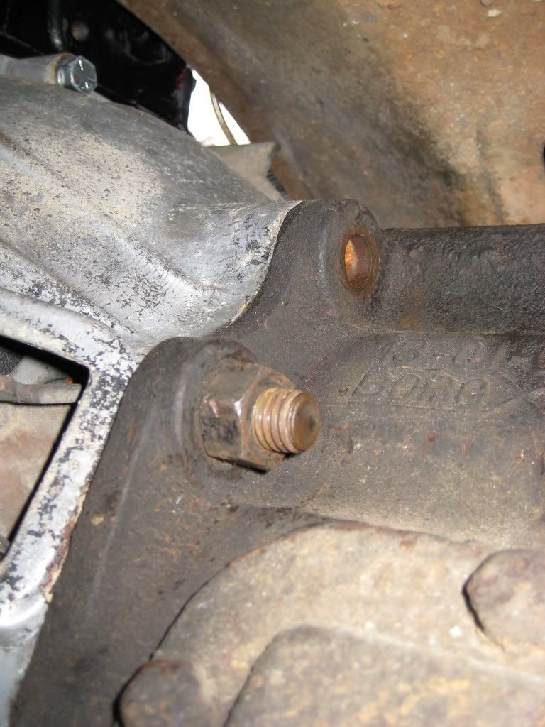

My 360 is IN, yes it has finally happened. Of course there are always issues, apparently when I removed one of the bolts holding the bell housing to the tranny some of the soft aluminum threads from the bell housing came with the bolt and it is stripped I think (in the bell housing). I am not sure if its totally shot or if it is just a course or two, I am going to run a tap through it tomorrow and see if it cleans up. The big problem is access, the motor is in and its a tight spot if I wanted to drill it out and re-tap it. For information purposes this is a 77 CJ5, 360 4 speed (T-18 I think). I bought a longer bolt today and am going to see if I can get it in to some better threads further in the hole. Any other ideas, the other 3 mounting bolts are cool, it sucks that its into this soft aluminum. I really want to get this thing running. Here is a pic of the area even though it doesnt give much info. Thanks,

I would see if there is enough space in the bellhousing to put a nut on a longer bolt if there is room.

I think you could fit your hand in through the clutch fork hole and put a nut on it if there is enough clearance inside and the bolt sticks through a little. you could always try it and the have someone operate the clutch to see if it looks like it would clear.

If, in fact you did pull the threads out of the hole, you're gonna have to pull the motor/bellhousing or trans/bellhousing and install a helicoil.

First try the tap route and see how much thread you have.
Remember, the holding power of the bolt is the diameter of the bolt in thread length.
Then check to see if there is space in side of the Bell Housing for either a little longer bolt or a nut.
One other thing, use lock-tite on all of the bolt for the bell-housing to the engine and trans to bell-housing.
Also Lock-Tite should have been used on the Pressure Plate bolts to.
Sorry if this idea a late but it will pay off in the long run.

Might also try winding a piece of thin wire (I like .023 welding wire) around a bolt, snaking the wire up thru the clutch fork opening and out the bolt hole, pulling the bolt up thru the bolt hole (from the inside out), putting a nut on the bolt and running it on with an impact wrench.

you guess is as good as mine i think but if you can see that the wall is angled you could always do a little grinding on the bolt head before you put it in.

why dont you just pull the tranny / t case and see what it really needs to be fixed??? ie re tapped or heli coil?? if youre going to try 1/2 A#$$ solutions just leave it empty..... really its not that much 2 driveshafts 6 skidplate bolts , 4 tranny bolts and some shifter / linkage to unbolt???I know it sucks but youll be happier in the end, I hope, that the job was done right.... just my .02

I second (or 3rd) the heli coil . I did one on my bellhouseing for a T5 and they work great.

I have also used a magnet with a long aluminum handle. You can usually find these at Sears. Stick the mignet through the hole, pick up the bolt and drag it back through like Beserk stated above. That magnet has saved my behind many times. JC

Thanks guys for all the help. I got a longer bolt same size and ran it all the way into the bell housing, there must have been some good thread beyond what was stripped. I do think that when I redo the tranny that I will be helicoiling that hole though. I did use thread lock and the three other mounting bolts are good so I should be ok till I get to that point. motor fired a little today, discovered that I had the 1 and 5 plug wires switched. It was a relief to find that after spending quite a bit of time scratching my head. I advocate permanently labeling your plug wires, that is how I discovered my Boo-Boo just staring at the motor when I noticed that the 5 wire was too far forward on the block. So tomorrow I have to fix a leak in a power steering coupler and then I should be able to drive it a little bit.
