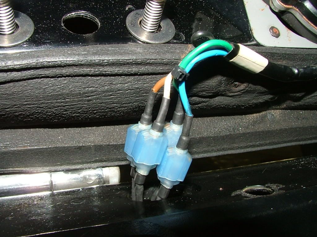

One thing I might mention,
You are heat shrinking over the factory plastic 'Insulation' on the terminals.
With a little heat, those will pull right off, and you will have a MUCH cleaner install.
If you leave them on the terminals, they allow an air gap under the heat shrink that moisture can sneak into...
That is the ONLY thing I see you have done that I wouldn't have!
The only other thing I see is your factory 'Open Plug' connectors don't seem to have any Dielectric grease in them.
For this reason I have switched to the non-insulated connectors. I slide an appropriate length of shrink tube over the wire, crimp on the connector, heat and wick in good silver solder, let cool (so it does not melt or shrink tubing) then slide on tubing and shrink.

Wow, Great Thread Jeep Hammer. All your rules should be taken, added to one post, and made a sticky (I didnt look, maby they already are?)
Anyway, As I read it I kept saying to myself, Whoho! I did good! haha
Anyway, I thought Id show a few pics of my electrical installs on my jeep.
For the mean time, I ran the batteries in parallel to keep things simple. I plan to add the solenoids and whatnot down the road:
Let me know if you see anything really bad =) (Theres one thing I cant believe I Didn't do)
I made these cables, There 1/0 or 1 ott. =)
Notice The ground on the back of the head! =)
Here is my fuse for my under dash fuse panel, for accessories.
Heres the panel and the fuse installed:
Heres my plugs for my YJ intermittent wipers, controlled by my CJ Switch.
(I want to be able to remove the window in the summer)
Im not sure If theres such a thing as to much die-electric grease... As long as you wipe up the extra =)
Group_er is offline

SUPER CLEAN INSTALL!
Couldn't have done it better myself!

The only thing is, I don't have a fuse in line with my hot cable between the batteries... EEK!!
Group_er is offline

Can't really fuse a battery cable,
The best thing you can do is fasten it down out of harm's way,
And I usually put extra insulation on them...
Anything from heat shrink (Expensive) to old garden hose (Cheap).
Just make sure your fasteners won't cut into the insulation and you should be fine.
