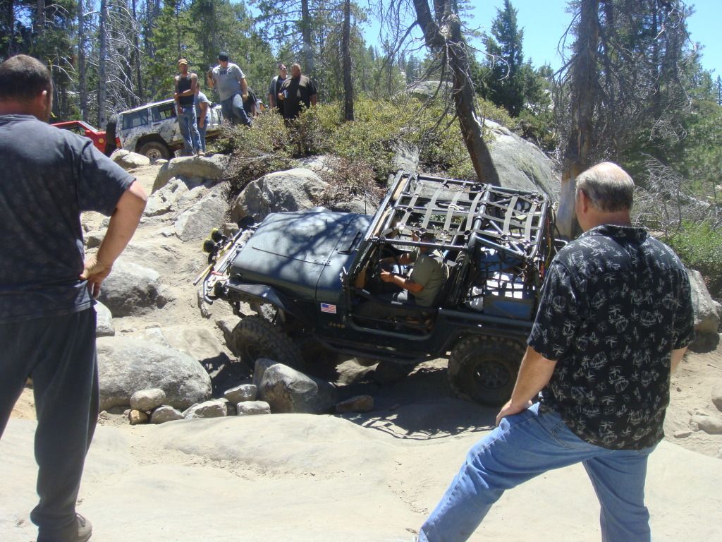

I think a cv shaft is always a good idea. The rubicon express springs are great and I run them up front with the BDS/fox shocks.
And I have an affinity for rocks.
And daily driving.

Thanks for the picture, I have some of the same terrain up here so its good to know that the setup is capable before I get it on the trail. I think that I will get the cv shaft, luckily with the dana 18 I don't need a SYE so that saved some money.
