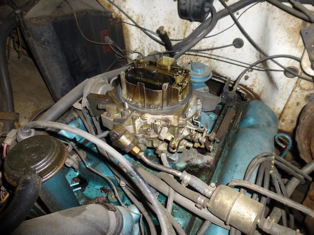

Backfiring- timing or carb?
My J20 backfires a lot. It does it when I downshift and the lower gear causes a slow down- it does it sometimes in the lull during the upshift. Dad says to advance the timing. I was also wondering if it could be a carb adjustment? I am about to swap out the leaky headers- I am probably going to go back to manifolds if I can find a reasonable set. Good headers would be cool, but I only want to do this once.
I have quite a few questions. Would the timing advance help? Do my leaky headers have anything to do with it? Can I do the timing myself? If so, do I need any special tools, like a light or something?
AMC 360, with long headers to Magnaflows, and the carb below.
I have SO many other questions, but I'll stop there- sort of. I don't want to get flamed or sound like an idiot, but how can I tell if my carb is two or four barrel?
It does say Motorcraft. Many more dumb questions to follow, as I now have two 30+ year old Jeeps.

I thought we determined the carb was a 4bbl. Open up the butterfly's on the back and look down inside.
A timing light is needed to set timing.
Backfiring on deceleration can be caused by exhaust leaks.
I would go with factory manifolds.

This screen shot shows what I believe to be the linkage to open the rear butterfly's .

Set your timing to OEM specs and go from there.
Take your fuel filter and put the return line(smaller dia.)at the top.
Do you have a vac. gauge?
YES, you need a timing light to set the timing......
Yes, your "leaky headers" are probably the sole cause of your backfiring.
Fix that, before you do anything else.
Matt

I'm pretty sure that's an old 4350 (4 barrel). X2 to Matt, Bill and LG's suggestions!

Thanks fellas. Yes- I will start with the return to manifolds. Bill, I know we looked at and discussed the carb a little bit, but we never really named its type, and I am so not "automotively inclined" that I didn't know if it was 2 or 4. That snapping has got to go! Thanks again guys.

OK, exhaust leak is history. It's amazing what a few header bolts will do. I am still intending on going back to headers. However, seeing as it runs MUCH better, and I am so close on the CJ, I will wait a bit for those. The CJ needs to eat some dollar$.
It still backfires a good bit. Almost always on the upshift, and when I downshift, and the tranny slows me down. I want to start with the most likely candidate, and work my way back. So the original question remains- timing or carb?
If it is timing, I guess I need a light, and a freakin' clue how to do it. If it's the carb... I guess it will just backfire- carbs terrify this guy. Where do I start?

You start with a copy of the Factory Service Manual.
And GOOGLE......
Basics of ign timing.

When was the last time you did a tuneup?
Have you ever set the idle mixture screws?

Hope your harmonic balancer has not slipped. If so will have to time it by ear. The timing lite will give a false reading. I would set #1 to top dead center and make sure the timing marks are correct on the balancer.

Looks like a 4bbl ford carb
