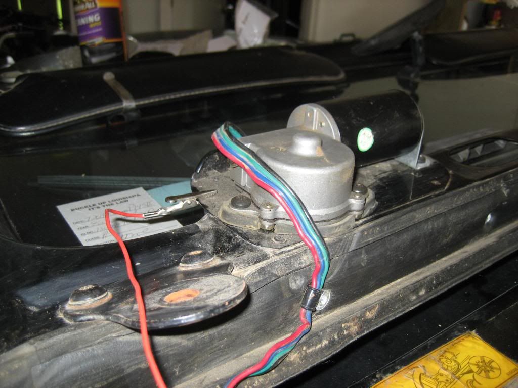

I'll get some up as soon as I figure out how to do it. Been fighting electrical all weekend trying to get windshield wipers working. Not sure but I think I may have a switch/motor mismatch. Once they're on, they won't turn off.

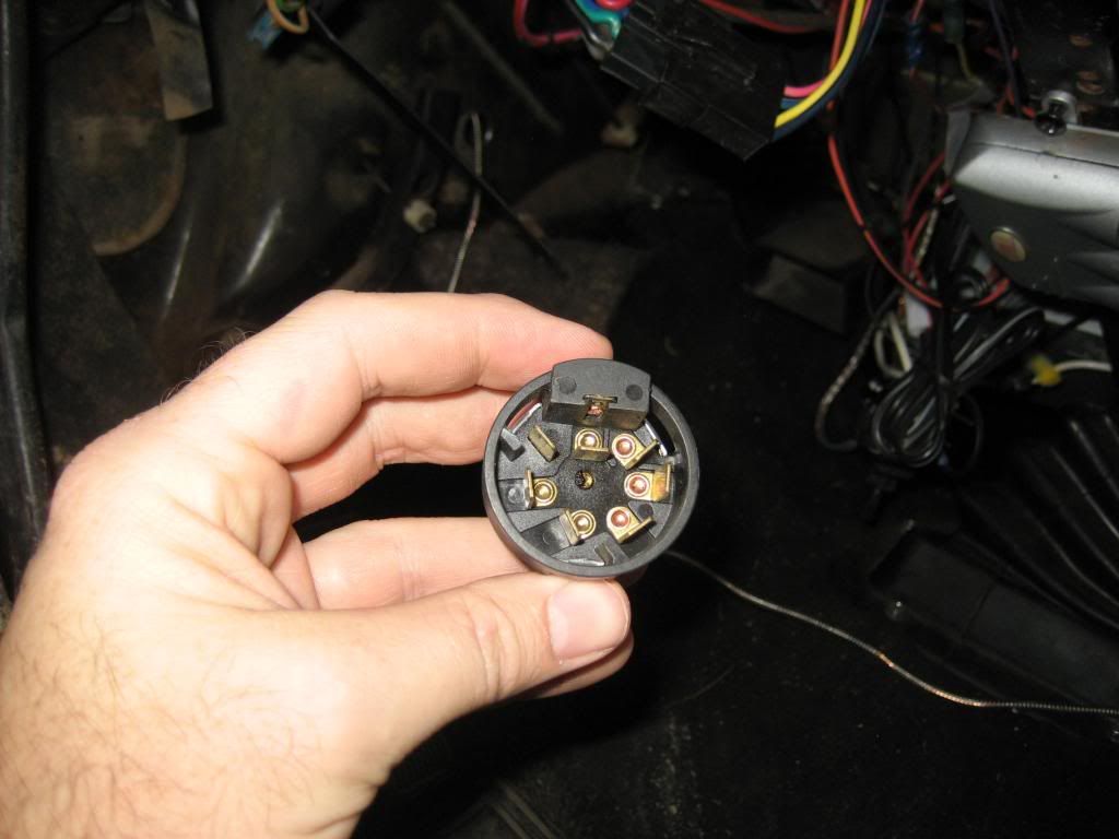

hopefully, that worked. I can put up more once I know for sure other people can see this picture...Got to go research wiper motor problems.
Anyone know for sure if the 3 position switch (non-delay) works with the 4 wire (delay) motor? From reading on my phone, it appears that it should if I remove (or don't have) the delay harness. Attached (theoretically) should be pics of the motor, switch and 4 wire connector. Any help would be appreciated. The switch is getting power, and all 4 wires to the motor are hot, which doesn't seem right to me, but when I poke them with the electrical tester, the light comes on all 4 times.

Nice Jeep ya got there. As to the wipers you stated that once on they don't turn off, how are you turning them off now? As I recall I think there's a lead for each speed and then a lead for it to return to the "rest position". I'm sure I'm missing something and hopfully one of the other folks will chime in. Good Luck with your "new" Jeep.

The PO had been unplugging the 4 wire connector turn them off, which is simple, but not the way I want to do things. After a fair amount of research, it appears that the motor could be wired wrong, so I'm going to try pulling the connectors and flipping the order of them. Hopefully that fixes it.

Pretty sure it's a late model CJ setup, without the intermittent feature. After a good amount of time spent using the search function, I'm going to try switching the wires around and see if that works. I'm also going to verify that the motor isn't locked up or something, although I'm not 100% sure how to do that.

The main news was that I finally have windshield wipers! After several afternoons of chasing the problem, I finally pulled the old motor and replaced it with the new one the PO had thrown in. After testing the new motor, I swapped the 4 wires in the exact opposite order that they had been wired in, and the motor worked like magic. It parked, it had low and it had high, which was a significant improvement from one speed that never stops.
