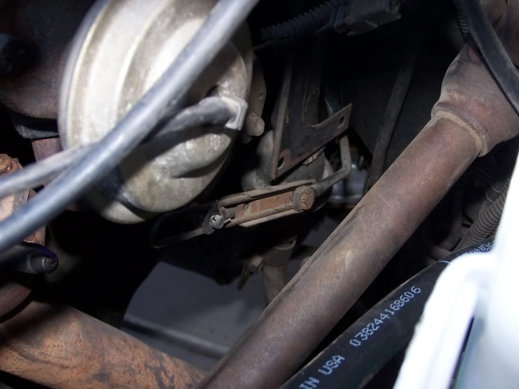

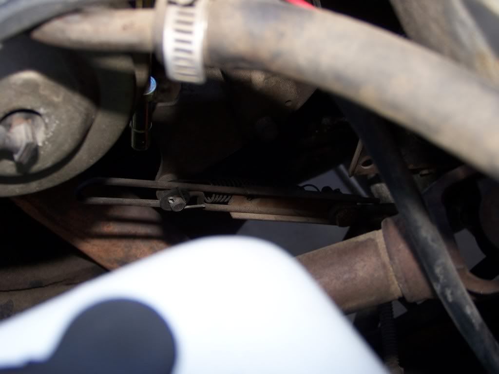

Here are some Pictures

Here's a link to the FSM:
http://www.civilianjeep.info/84-86FSM/CJ-FSM-84to86.pdf

What does it mean when it says to "set the throttle off the fast idle cam"?

That would be off of the fast idle lever in your application. That is used to maintain fast idle until the choke plate is open which would pull that lever away from the fast idle screw. Purpose is to be certain that the linkage is sitting in the normal running position.

Got it dialed in guys, thanks for all the help!!
