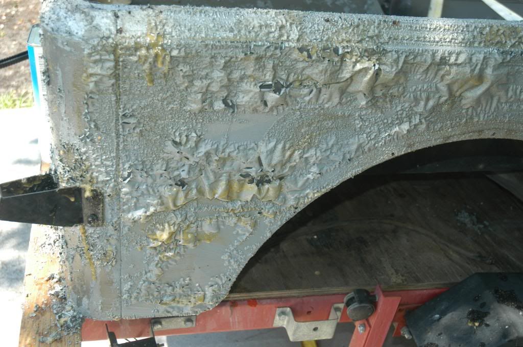

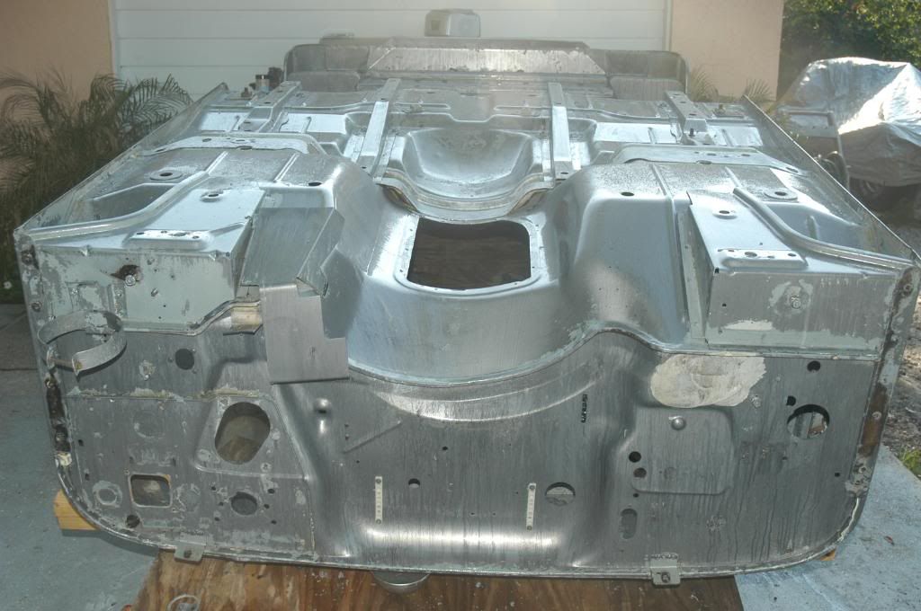

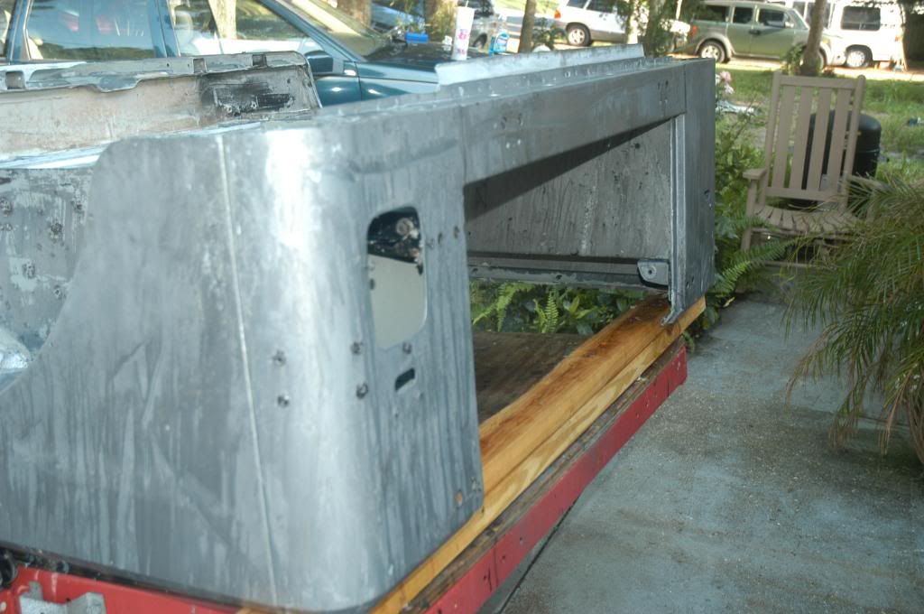

Well I have also been working on the tub. I had considered all the option as far as removing the paint. I even considered just sanding the old paint, but it was pretty rough. The vehicle has two coats of paint on it. I decided to use aircraft stripper to get the paint off, same as I did for the frame.
With the help of my friend, we got all of the paint off the top half in about 3 hours. It went a lot quicker then I had expected.
The next day I did the bottom. I am not sure why, but this paint was a little more dificult to remove. Spent an entire day doing the bottom.
Sprayed the whol thing with phosphoric acid to keep it from flash rusting.
No problems so far.

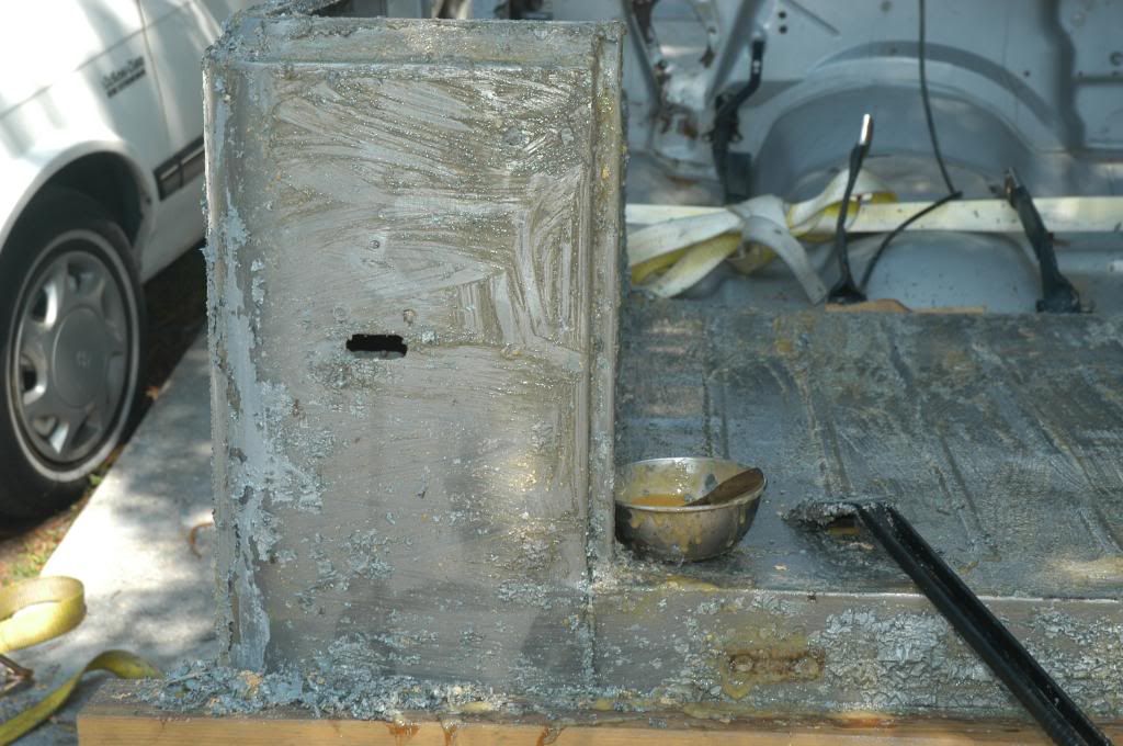

I want to remove all the old seam sealer, but the stuff is hard as rocks and the aircraft remover didn't even touch it.
I plan on sanding and priming this weekend.

To remove the old Seam sealer, I took an old sturdy flat head screw driver, with my bench grinder ground down to a fine edge. Just use a hammer to tab along and scrape it off. Did the entire inside of tub in about a half hour.
I used an old screw driver because i wasn't going to screw up any of my chisiles.

I got every speck of paint off the tub, sanded the bottom then hit it with two coats of Dupont epoxy primer:
Put new 3M seam sealer on
Then put two gallons of Herculiner on:
Got some on my hands, it won't come off!
