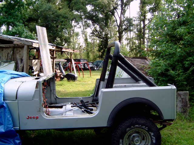

Hello everyone. I enjoy keeping up with all the different builds on the forum and thought others might enjoy mine. Nothing fancy or spectacular here. My goal is to restore my jeep to as close to factory original as possible. I am not a mechanic or a welder, but I am pretty handy. So here goes...
Searched Florida for about two months. I was looking for an original, unmolested CJ7 with a solid frame. I finnally gave up. They seem hard to find around here and were too expensive.
Got one on ebay for $2,000.00, but I had to drive to Louisiana to get it. Probably paid too much, but it was just what I was looking for.
Spent about a month taking it apart. I wish I had been a little better organized, I had no idea what I was getting myself into.
Engine only had 72,000 miles on it and ran great. No smoke or any other issues.
With the exception of the rear crossmember and the back four frame to body mounts, the frame was in great shape. 90% of the paint still and no rot.
Replaced the rear crossmember
And the back four frame to body mounts. That was a monumental task. I was very careful to put them back on in the same place. I used the ones from 4wd hardware. They seem alot stronger than the ones that were there originally.
Spent the next several weekends removing the paint with aircraft remover and sandpaper.
Well after I got all the paint and rust of the frame, and welded everything up, I painted the frame with several coats of Rustbullet. Then I sprayed two coats of Dupont Nason 2K.
Then I replaced the springs and shocks wither Superlift Superride 1" lift springs and shocks. New heavy duty shackles with a 1/2" lift.
Replaced the gas tank too.
New bearings, seels, rotors, brake calipers, all new brake hardware, polyurethane bushings etc.
I wanted original chrome wagon wheels but couldn't find any. So I found that Cragar makes identical wagon wheels, found some mint center caps on ebay.
