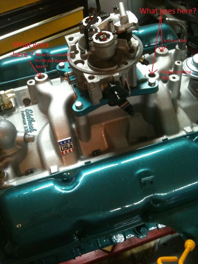

I have since figured out a few pieces, but am still stuck on some. Here is a pic.
Any help on these last few pieces would be much appreciated.

Pipe threaded plugs.

Matt...ask and ye shall receive...

Here is what I got
/l ,[____],
l---L -OlllllllO-
()_)-()_)-o-)_)

awesome critter812 thank you for the information.
I forgot to mention...I will be installing the howell TBI (as shown in the pic)...will that make any difference in what goes where?

I have the Holly TBI on mine no difference in what I stated depends on were you hook up vacuum
/l ,[____],
l---L -OlllllllO-
()_)-()_)-o-)_)
