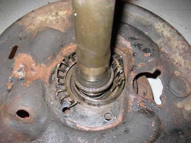

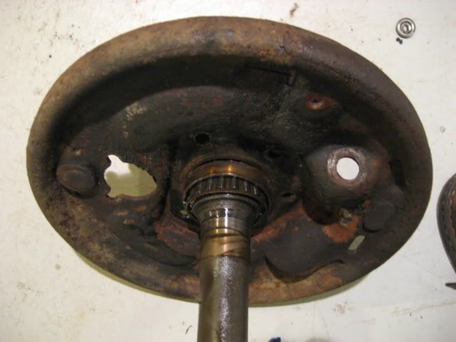

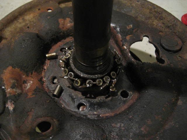

I had spun a hub on my drivers side at some point in time and never knew it. It spun, and then fused itself onto the axle and never came off or out of balance. It wasn't until I started my rebuild of the Jeep that when it came time for the axles, I couldn't get the rear drivers hub off even with the hub puller tool I own. So, out came the 4 bolts that hold the backing plate to the axle tube and was able to pull the assemble out.
Now we needed to separate the axle from the backing plate and the only way to do that was to snip out the cage of the tapered roller bearings.
Once the bearing was out of the way, the axle could be separated from the backing plate.
I tried pressing the hub off on my 12ton shop press but no go. Had to take it to work and use our 50ton press and even that was hard but it came off with a bang. Axle and hub were ruined so I had to buy a new 2 piece axle for the passenger side. Yeah, that's right, NEW 2 PIECE AXLE. The design is fine with me for what I do with my CJ now and I also contribute the failure due to large tires and in proper gearing to match. I had 33x12.50 with 3.31 gears.

Hey Keith,
Was the roller bearing exposed like that due to the hub spinning, or is that how they look once you pull the seal off?

That's how they look once you pull the axle out after removing the 4 bolts on the axle flange. If you wanted to just change the "inner" seal, you could do it this way without the hub puller but you must disconnect the brake line and E-brake cable to pull it out with the backing plate attached.
